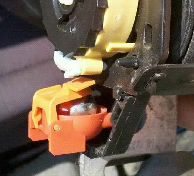

For the stuck seatbelt, it's likely just gunked up inside. Flushing the mechanism out with WD-40 will likely get it working again. Also realize that our seatbelts lock up when the Jeep is on a slope and the little steel ball you can see here has rolled to the side.
