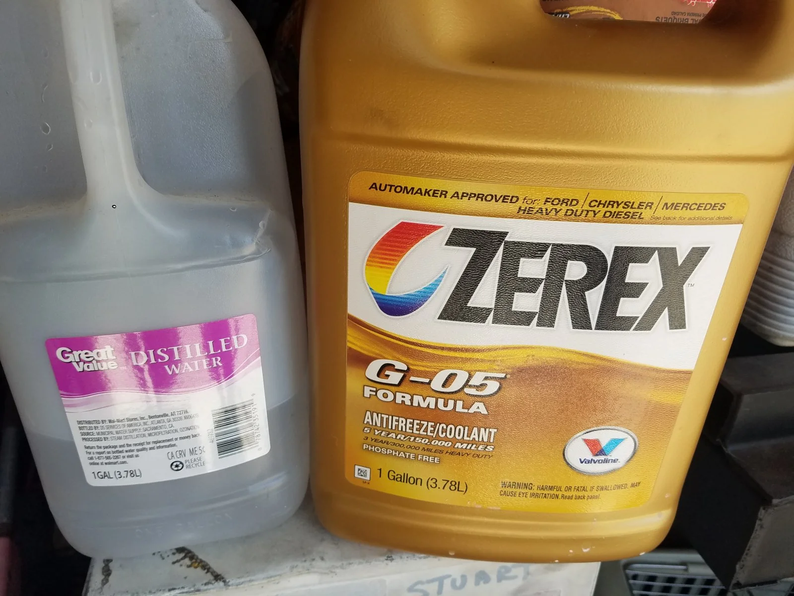

Any time your engine starts running hotter than it should, it's not the design. It is always caused by a fixable problem... clogged radiator, bad fan clutch, stuck thermostat, mud in the radiator, or bad water pump. To help keep your radiator from clogging, keep the coolant fresh and NEVER use tap water to mix with the coolant. Tap water has dissolved mineral deposits (lime, calcium, etc.) in it which will build up inside the radiator. Instead, use distilled water which is sold by the gallon in your local grocery store's water aisle. Zerex G-05 is a good coolant to use, better auto parts stores like NAPA carries it. You won't find G-05 in low-end auto parts stores like Autozone. Autozone refuses to carry the good stuff like that. ;)

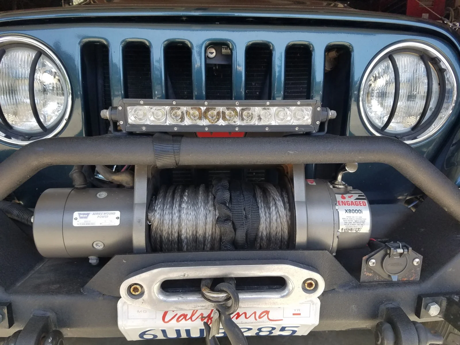

Not sure if the winch may also be blocking air flow at normal driving speed; but it blocks about 1/3 of the grill openings:

It's probably pretty close to 200 in there. ;) No vent is needed, nor would the engine run any cooler if the hood was vented. Us humans don't like the engine compartment's temperature but everything the factory installed in there is fine with it. :)
