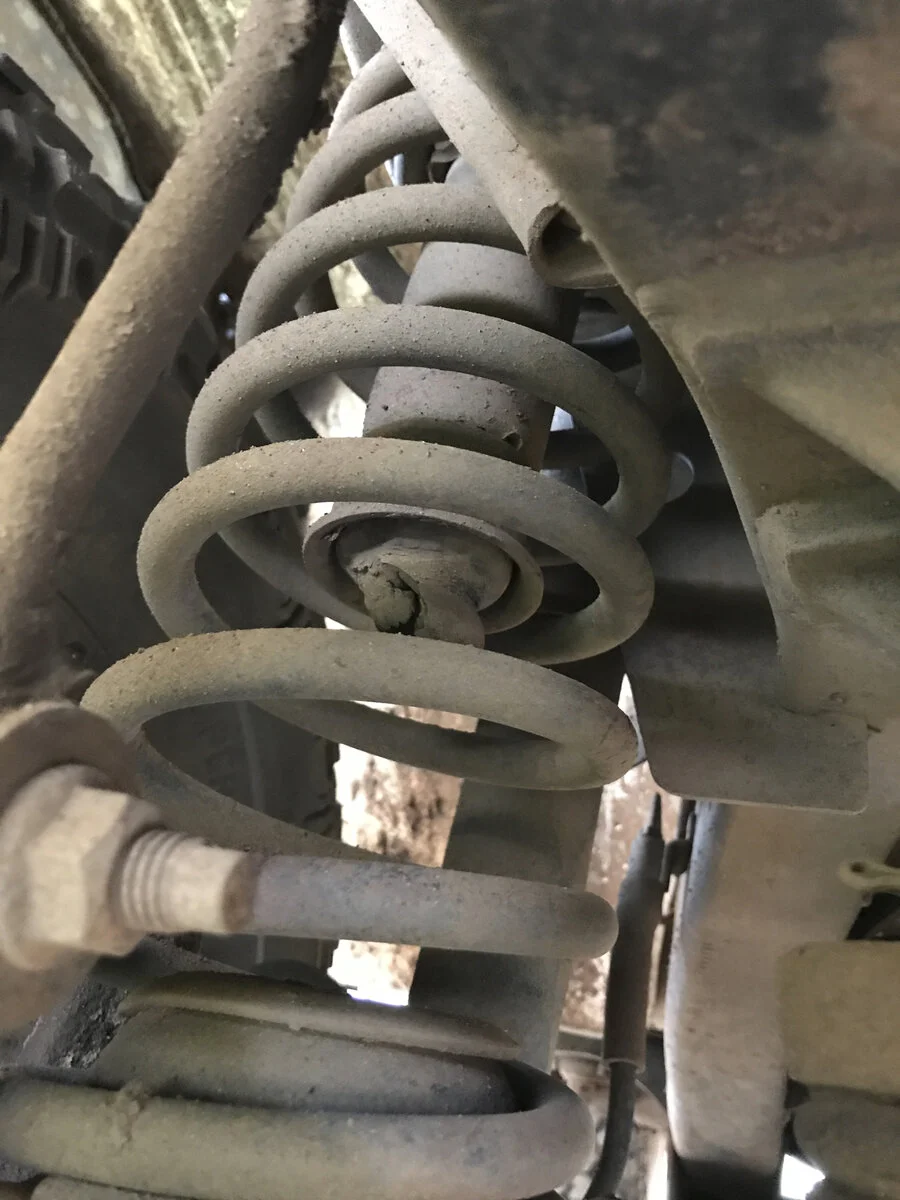

I believe shocks have been replaced in those 17 years but also with stock KYB Excel-G. The ride is far too harsh. I'm sure springs haven't seen replacement. I get 12" front and 7" rear spring length without any load, so probably a bit of sagging at the rear - not sure why only the rear...

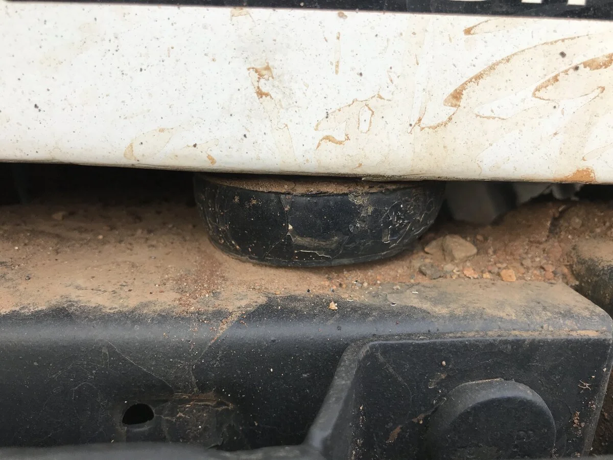

- From the picture you can see the bump stops have seen better days. For the 2" lift, do I extend them? What's the best way? Do I need OEM + extension or are there replacement ones that are longer?
- Do these body mounts need replacement? They are a bit cracked and very hard indeed.
