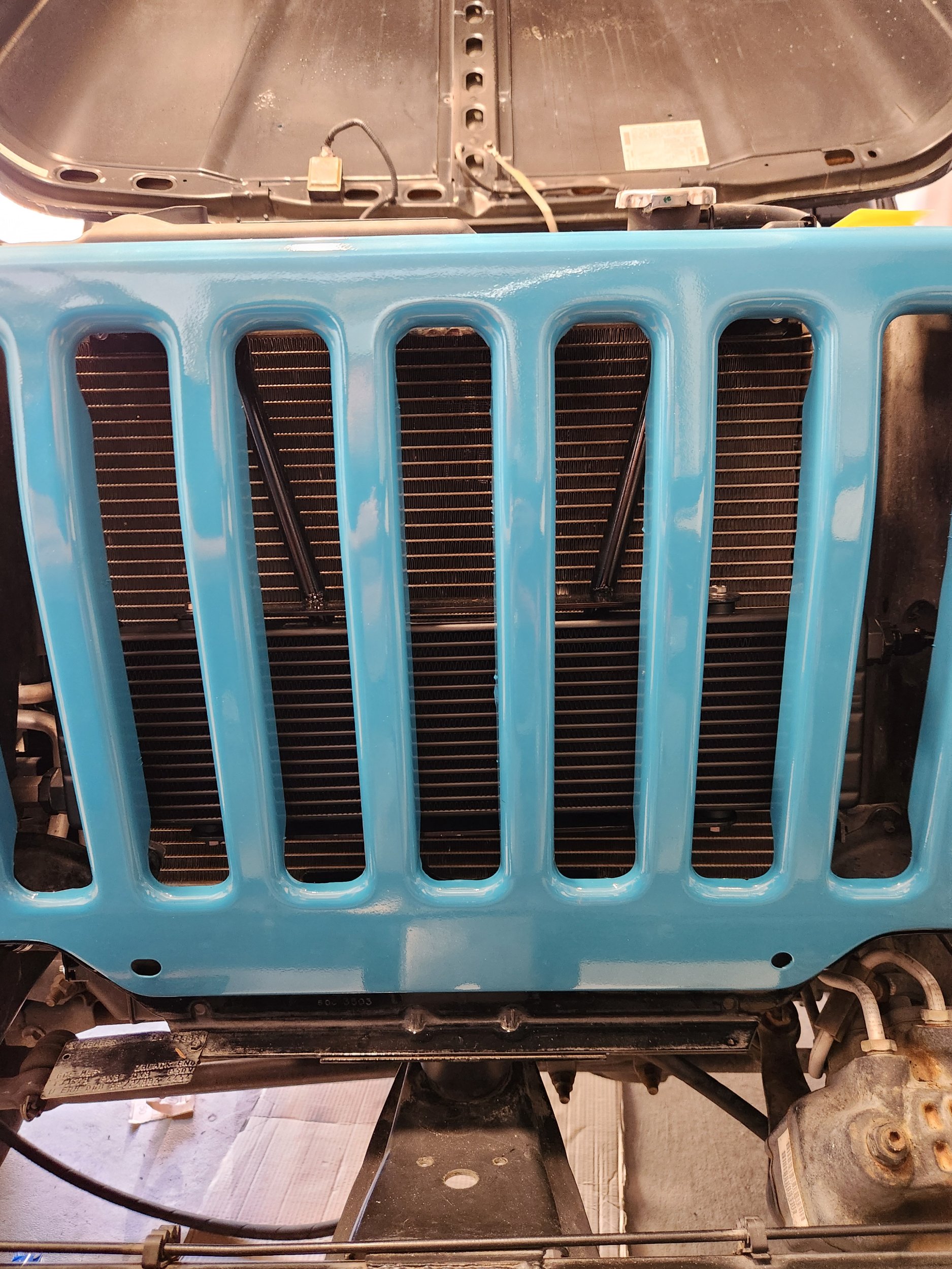

Only question is what is the Mr. Blaine approved routing near the steering box? I figure we want to stay good distance from the steering shaft, and go over the lower radiator hose. Do you have any photos of this area with the box in place?

No pics, we just make it work.
@mrblaine - thanks, do you use any zip ties or rubber clamps in that area, or just loose from grill to trans line?
We just make it work. Sometimes it takes a few clamps, sometimes routing it a certain way makes it all play nice. That and I'd done this enough times that no matter what I say has to be done to work, some folks will jump through their ass to do it any way but that.

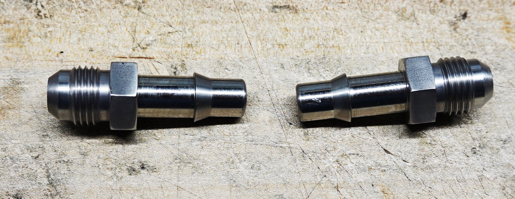

He supplied me with the AN fittings, but ended up needing one 45 hose barb fitting to connect to the stainless tube. These AN fittings are all easily available from racetronix etc. But probably easiest to get them from blaine. You'll also need -6 hose. I got aeroquip from summit, but I think Blaine can supply that as well.
My experience is pushing the hoses onto the barbed fittings is pretty tough, but I'm also an idiot. I think you can buy a fancy tool to do this.

The ICT adapter doesn't work on the 03-04 trans cooler ports in the radiator. Best thing to do there is carefully remove the rubber hose from the port you are going to use and push the new hose onto it.
I don't like the aluminum ICT adapters so I had a 100 of them made in stainless.

Those are not the quick disconnects, but are hose barb ends The ict adapter will not be helpful.

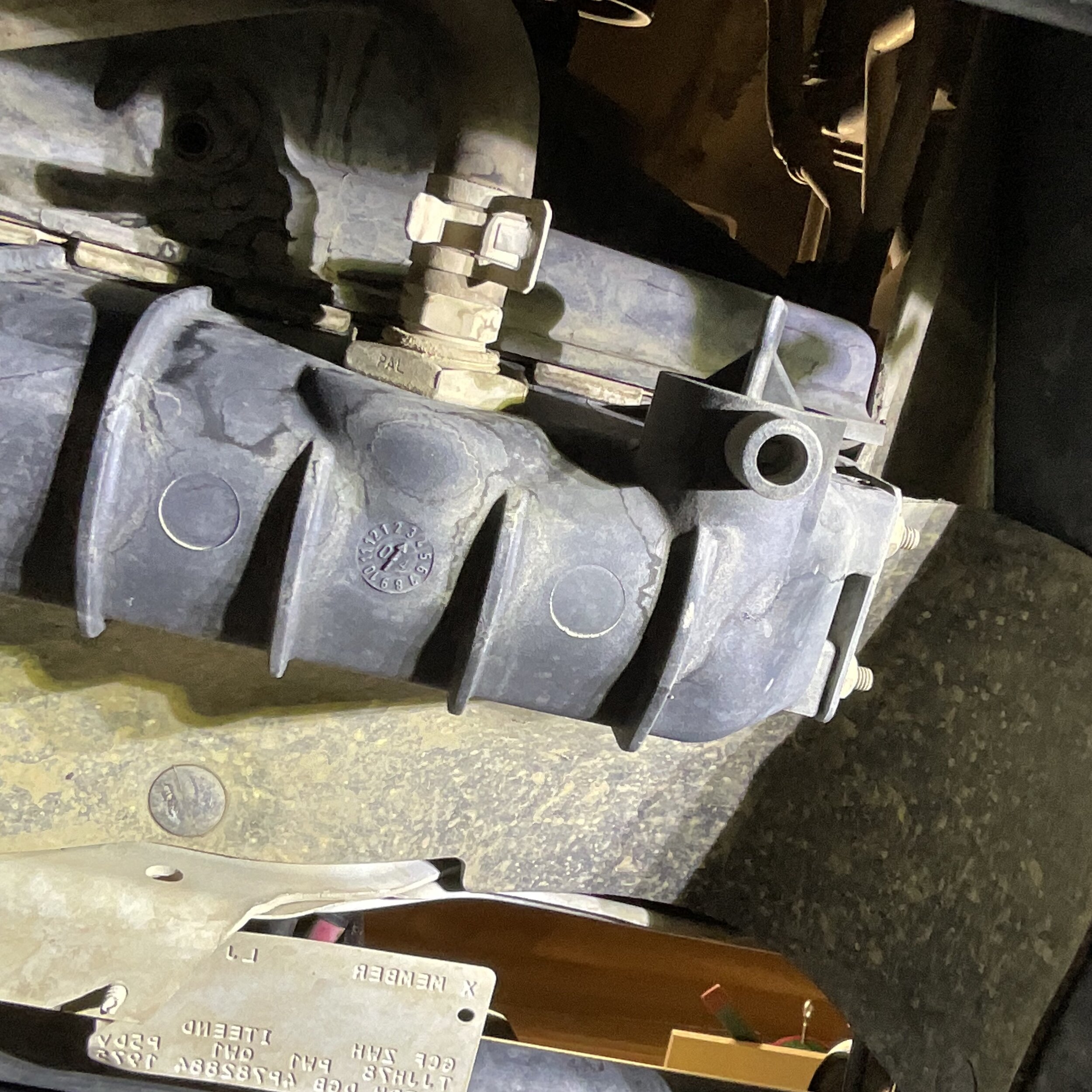

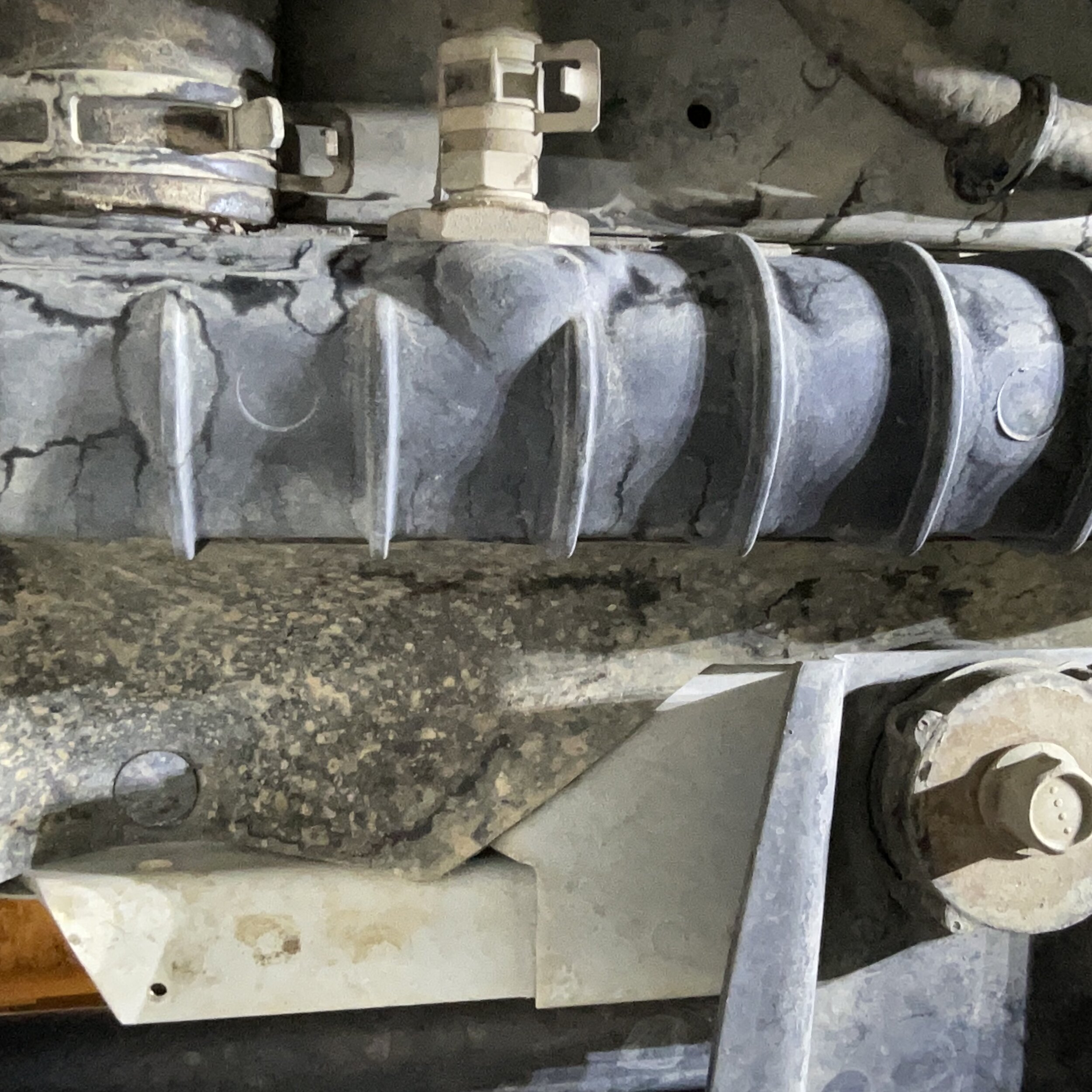

Here’s pictures of the bottom of my radiator.
Those are threaded fittings that screw into the heat exchanger and have a small tube that sticks a small amount further into the fitting that then seals on the o-ring inside the heat exhanger fitting. All you do there is remove the hoses and use new hose either 3/8" or -6 onto them with clamps. If they can salvage and reuse the one with the formed 90 on it, all the better. Otherwise, we have to convert to -6 male by brazing that onto the part that threads into the heat exchanger so a 90 degree fitting can be used. For that, we need those fittings out of the radiator and that is a pain in the ass. We have never found anything that fits in the aftermarket since it is such an oddball.
