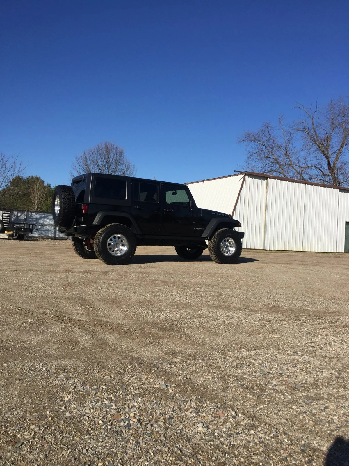

3.5 metalcloak gamechanger rock sport edition rides great. She's on 37 ko'2, again rides and drives great. Metalcloaks rear tire carrier bumper is great, no rattles, I'm not sold on the front bumper. 4.88 gearing with the 6 speed is s good setup, but she doesn't do to much freeway. Front drive shaft left us at about 5000 miles into the lift. Hope this helps!
