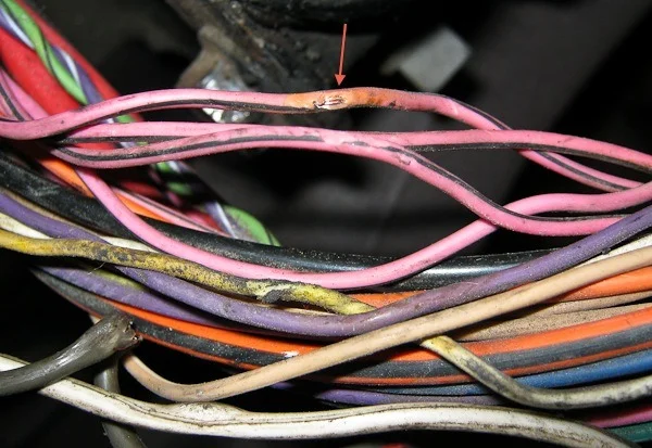

But it could be some exposure (where the casing has rubbed off), or pinching with a small slice around a tub or other seam, etc. Some guys have luck just unplugging and replugging the connectors (in the case of some corrosion in the connector).
Here’s one example from the random interwebs:
It has been many years since the switched option was discussed but I seem to recall that in order to lock up the converter, all you had to do was supply ground to one of the wires in the circuit which supports the intermittent and worn insulation fairly well.
Since it’s intermittent, not likely that the wire would be cut or unplugged and you’d likely see a CEL.
