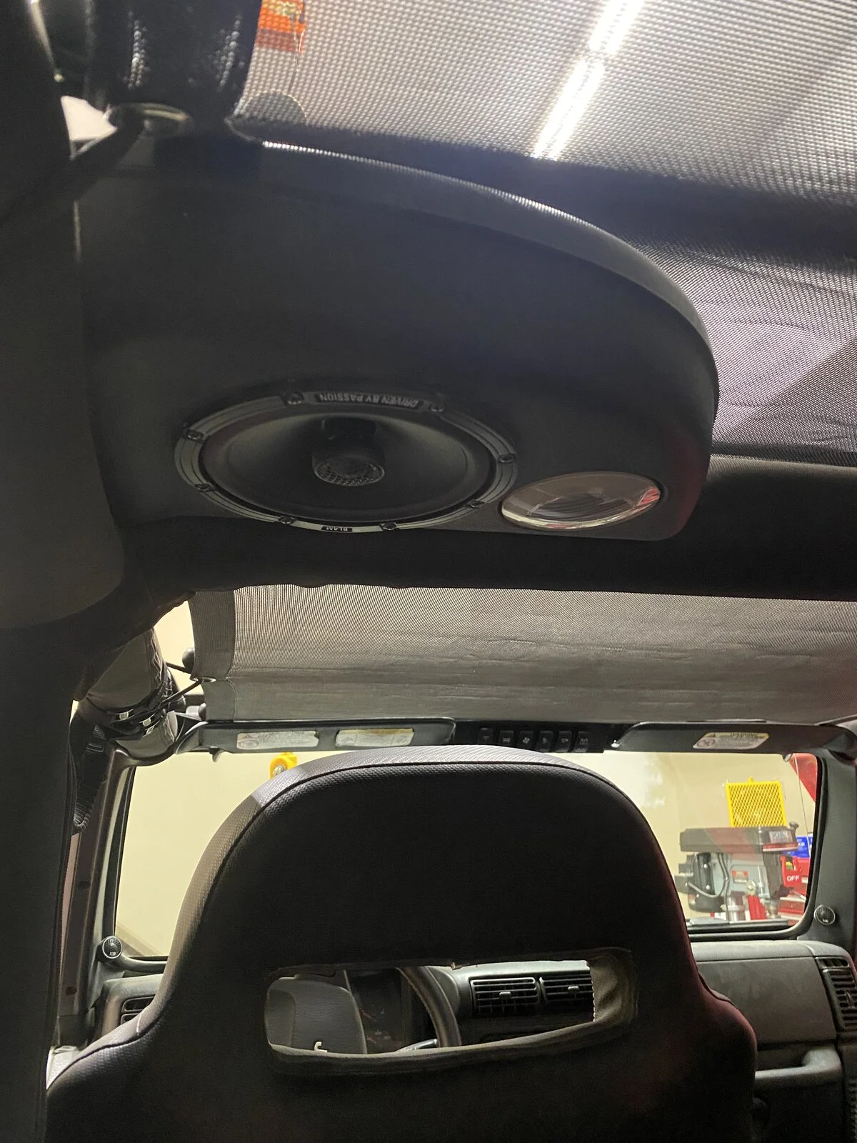

Here are some spacer rings for the late model speaker pods. Useful to get a secure fit if you are installing 6.5" speakers that will sit raised instead of flush. The outer edge of the ring has a slope to match the contour of the pod.
https://www.thingiverse.com/thing:4617429

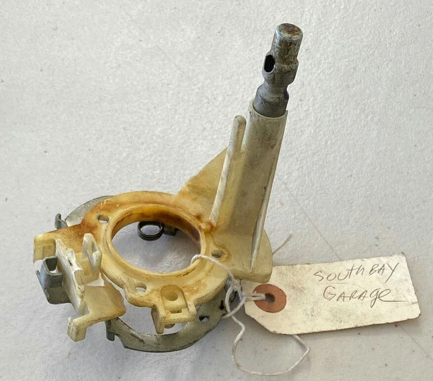

How difficult would it be to do a turn signal switch early Gm type. Could this be done on a 3d printer or would moulding it be better for a one off part. How ,any hours would be involved?
That part can be modeled and printed however the weakness in 3D printing is the adhesion between layers. When you have thin area, such as this part, it will be weak and fairly easily broken due to the layers. Sometimes you can orientate a part to help with that but I am not sure with this part it will be possible. A factor is how much stress the thinner areas are under during usage.
What is also possible is to 3D print the part and use that to make a mold to pour resin or something else into,
Andy
