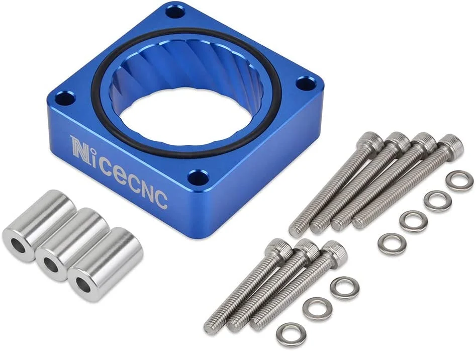

This should fix your whistle. Notice the "swirled" machining on the inside, which effectively twists and spins the air and this diminishes the whistle sounds. It's likely this too, will gain additional throttle response...
