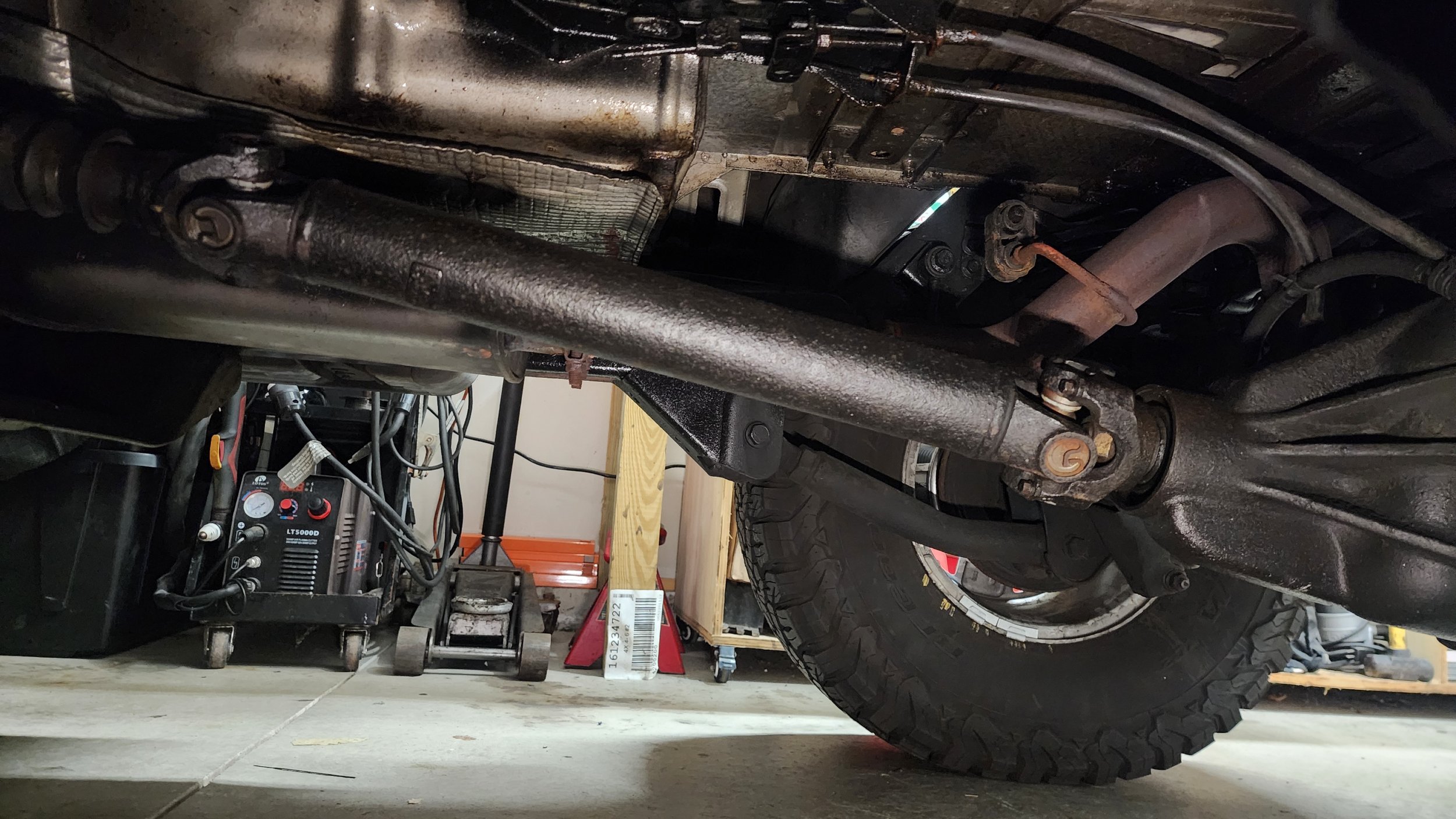

Here's a photo for you of the rear
Seems a little greasy back there. Is that oil fresh? Pinion angle looks okay, maybe slightly high without sye. Id try lengthening the lower arms slightly to bring the angle down.

It's hard to tell from your picture, but it almost looks like your rear driveshaft angles are off. Without a SYE and CV joint, both of the yokes need to be at the same angle to cancel each other's angular momentum. If you draw an imaginary straight line from the centerlines of the rear axle yoke and the t-case yoke, they need to parallel to each other. If the yokes on your rear driveshaft are at different angles, you will get vibrations. Buy a digital angle finder and you can check angles very easily. Klein makes an inexpensive one with magnets.
Reactions: Sensei and AndyG
Good post - he is close to being in double cardan rear shaft territory - normally you are with the pinion pointed in line.
The perfect shaft angle is the one that does not vibrate or growl. Pros will try 50-60 settings to find the sweet spot.
My LJR hardtop changes my rear pinion angle enough to make it sing some.
