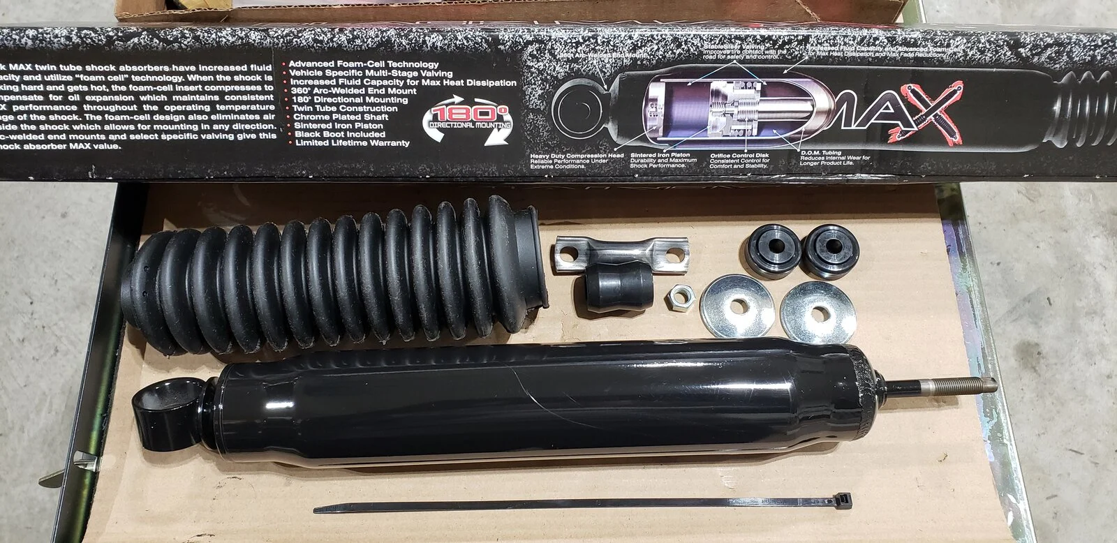

I did go ahead and get the fronts assembled today. The bushing pressed in easily by hand. I used a dead blow to start the pin in the bushing then used my vice to press the bar in. Once it’s bottomed out of the block of wood, I just rotated the shock on the pin and pushed a little and lined right up in the middle of the pin.

For me, the rear came with the bushings and bar pins installed. The front came unassembled andI I had to install the bushings and bar pins.

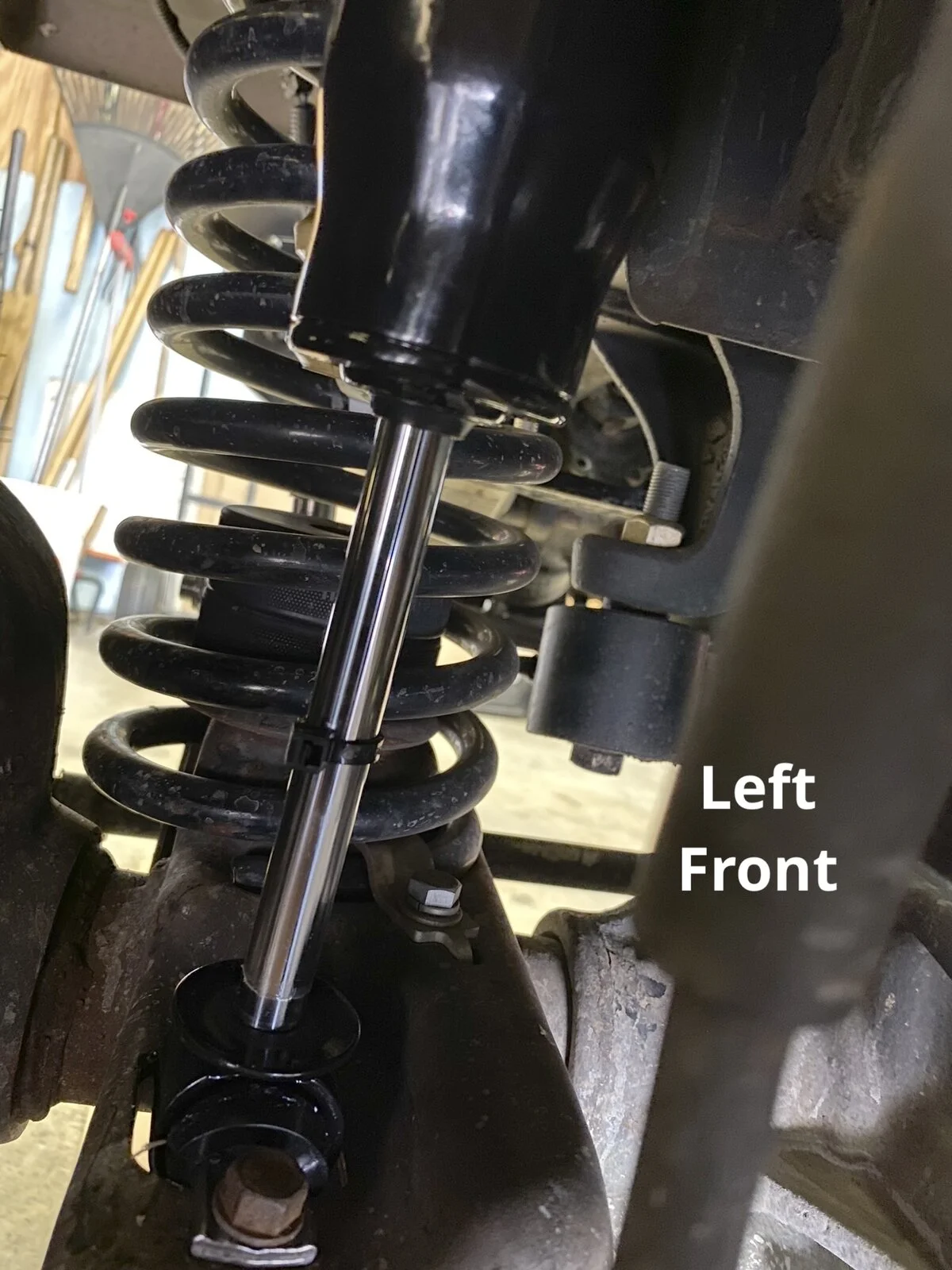

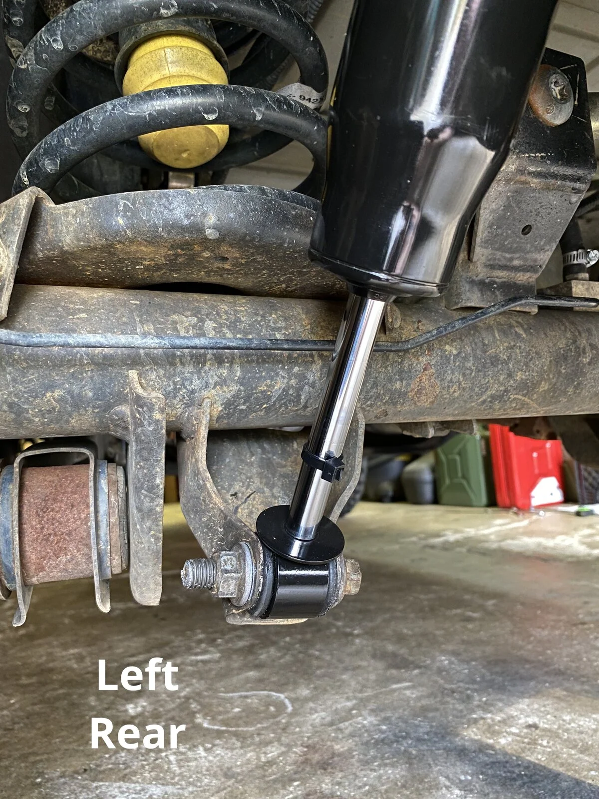

I don’t have all the technical info and measurements that @Irun has, but the front had right at 4.75 inch of the shaft showing. The rears had 4 inches.
Going by Skyjackers info of 9.21” of front travel and 8.87” of rear travel, am I correct in think I have 4.42“ of down travel in the front and 4.87” of up travel in the rear?
B8516 fronts
B8518 rears
I did put some zip ties on the shafts, slid up against the cans, before I went out. Here’s where they were when I came back.
