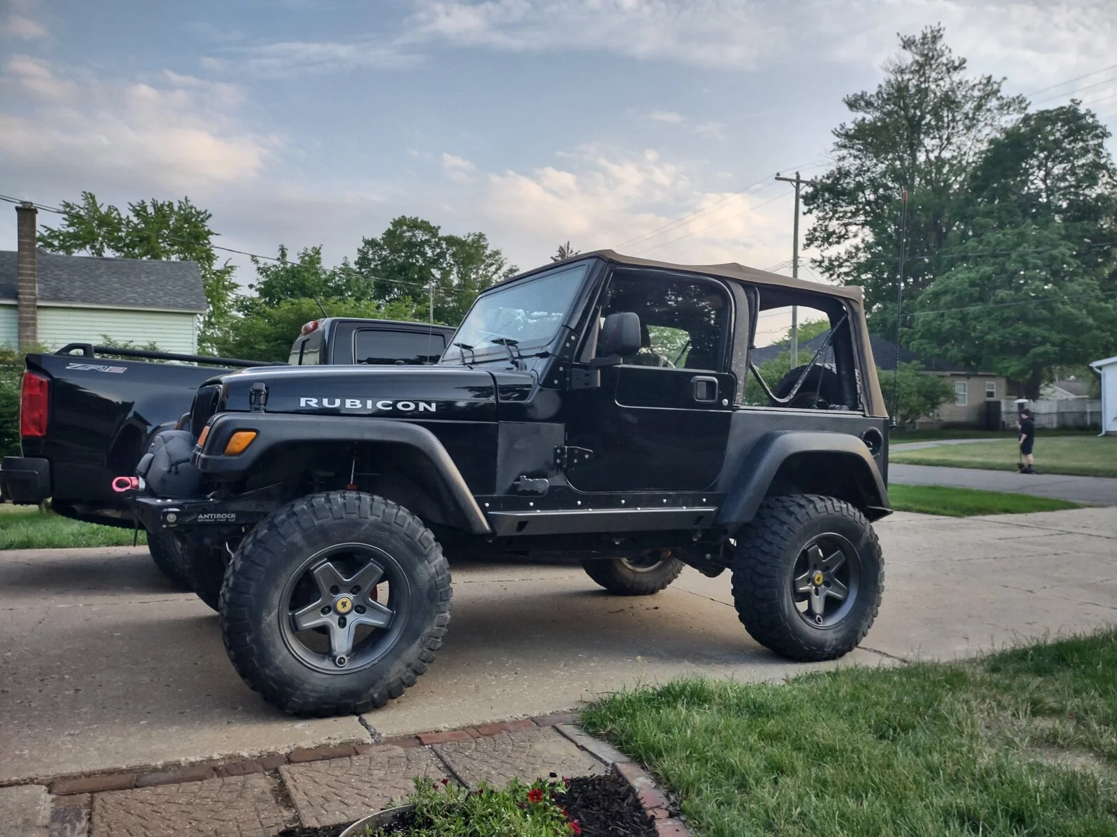

Installed longer springs this weekend. No real difference. I'm using about 2" of travel up front and about an inch and a half in the rear, according to zip ties. I only have about a hundred miles on them, so I'll give em another half tank of fuel to break in... They are better than the Ranchos. Pretty stiff in compression though.
Also, the new springs make my tires look small...I wonder what I should do about that?

Also, the new springs make my tires look small...I wonder what I should do about that?View attachment 257680
