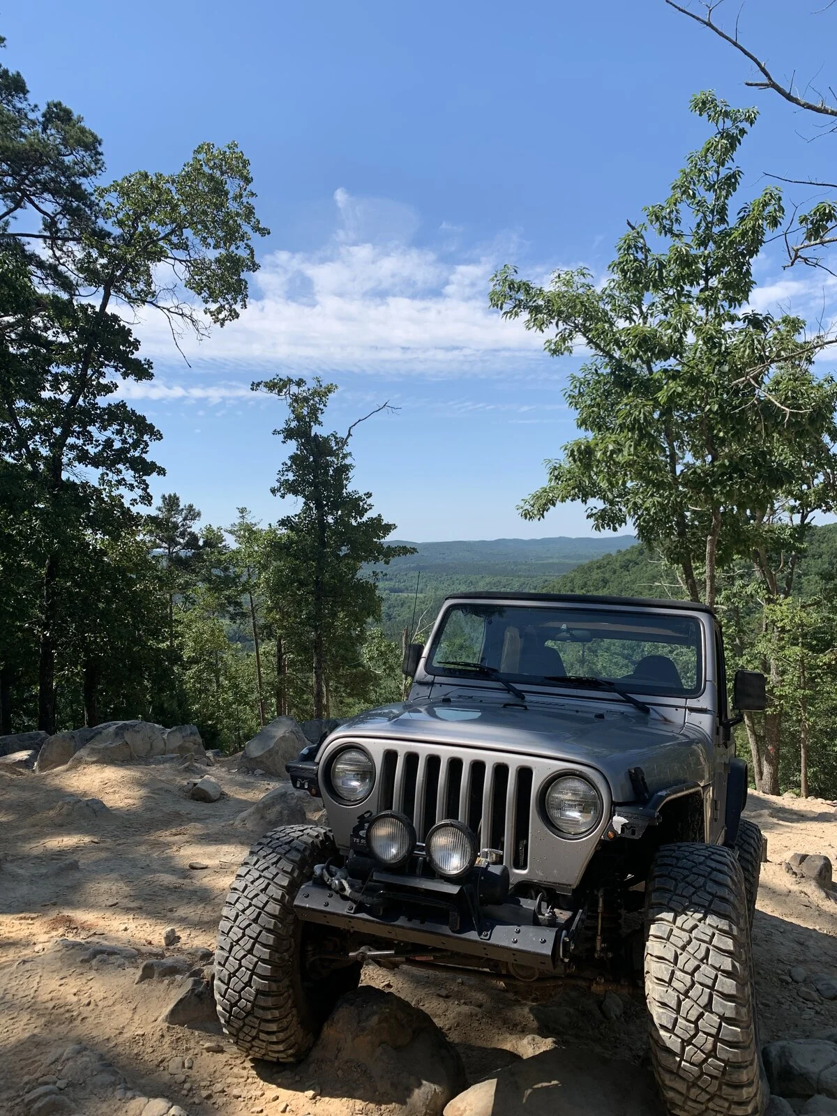

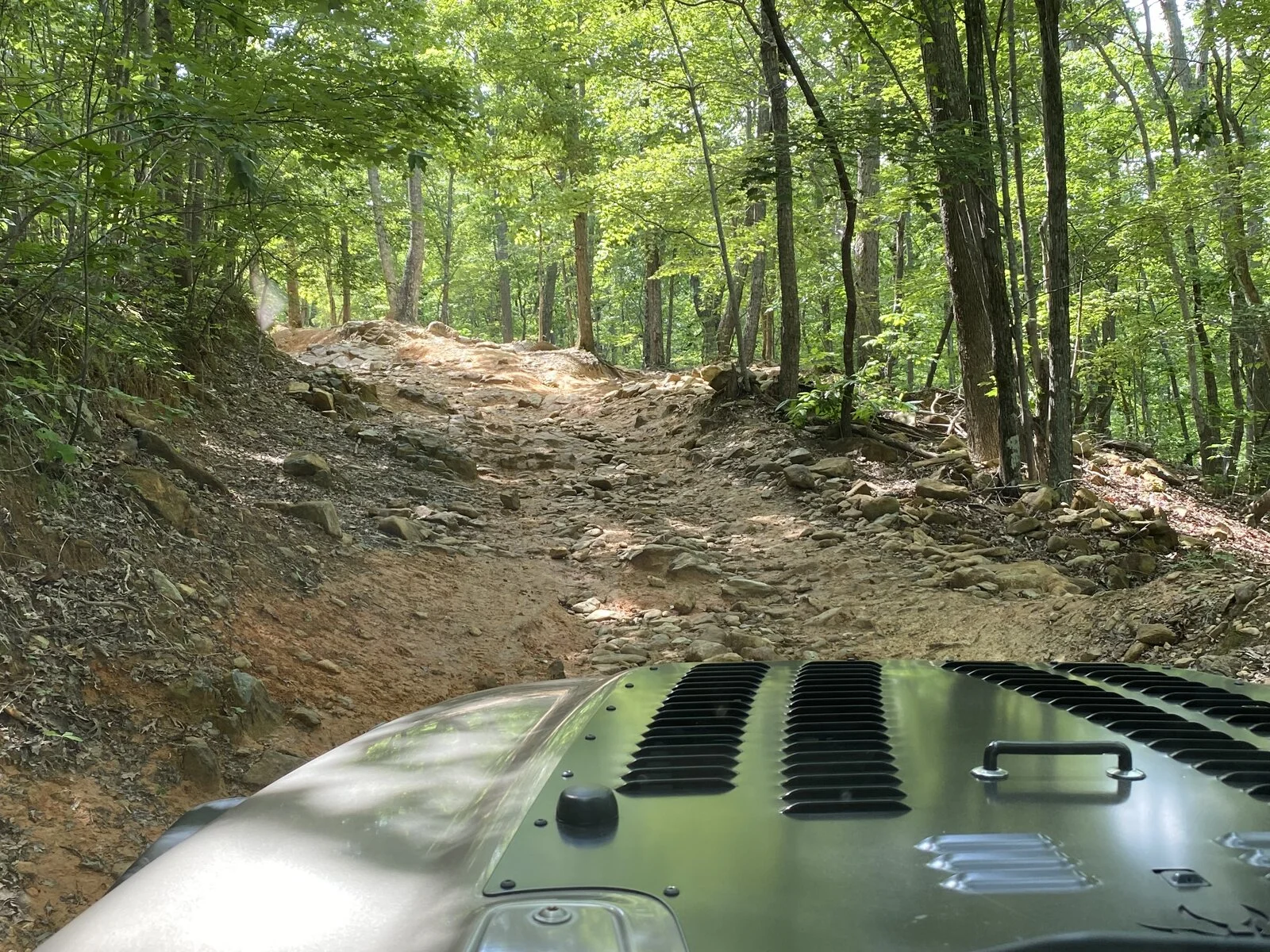

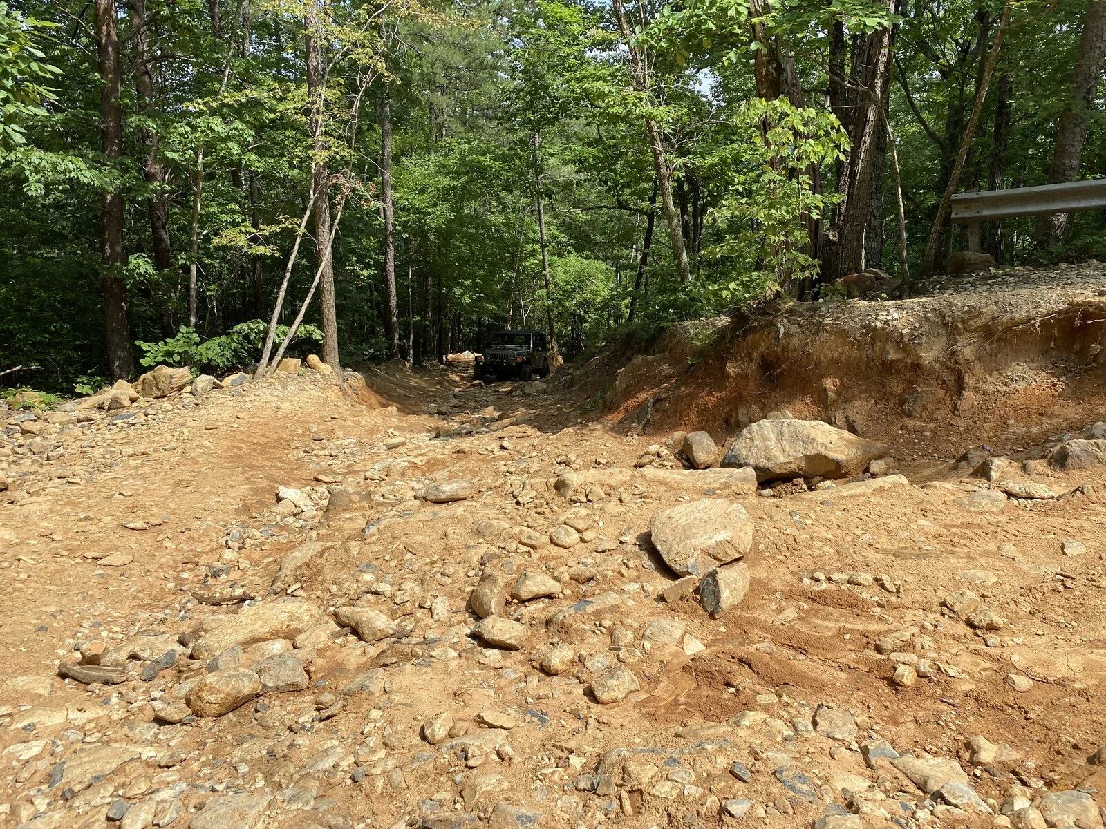

I had the Skyjacker Black Max's out in Uwharrie yesterday. Lots of rocky, bumpy trails. They felt very good to me. Even my friend (not a Jeep owner) who rode with me thought they rode really good. I had a couple places in mind that I thought the rear bumper might drag when coming off a ledge, but it didn't. If I had come off them faster, probably,
On a different note, off-roading is crazy sometimes. Some places you think your going to have a little trouble and then the Jeep just goes with no issues. Then you drag your main skid on something you didn't even give a second thought too. :ROFLMAO:
Lots of this kind of stuff there:
