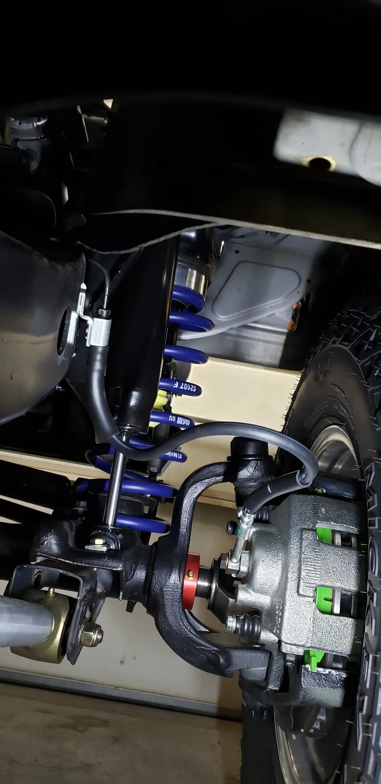

Maybe it's just the ranchos in the front then. I liked how the ranchos reacted to a speedbump in the front more than the black max. But with the BM in the rear and ranchos in the front I would get front back swaying after bumps.
BMs don't do that. My ranchos in the rear were dead enough that they didn't self extend after I removed them. So not a fair comparison
That being said, BMs on the front are much nicer on small potholes and uneven road. But worse on speed bumps. I have both in my daily commute. But it's easier to take speed bumps slow.
Edit: other minor annoyance with the BMs is routing the brake line. Before I could tie it to the rancho can.

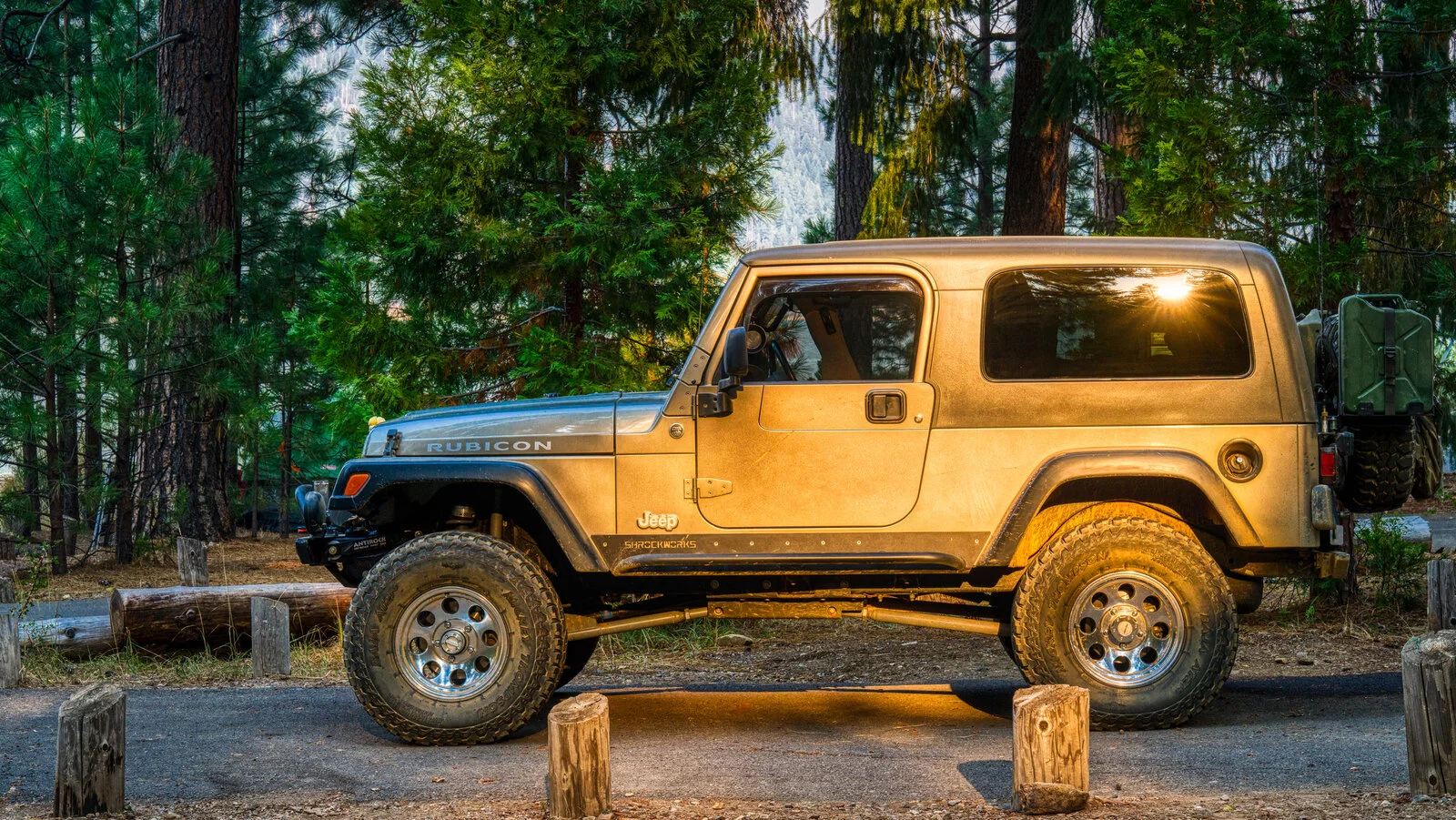

I’m still super happy with my Rancho’s 5000X 55255/55256 with Currie 4”. My travel bias is almost perfectly 50/50. You get more possible travel out of the Rancho’s than the BM.
