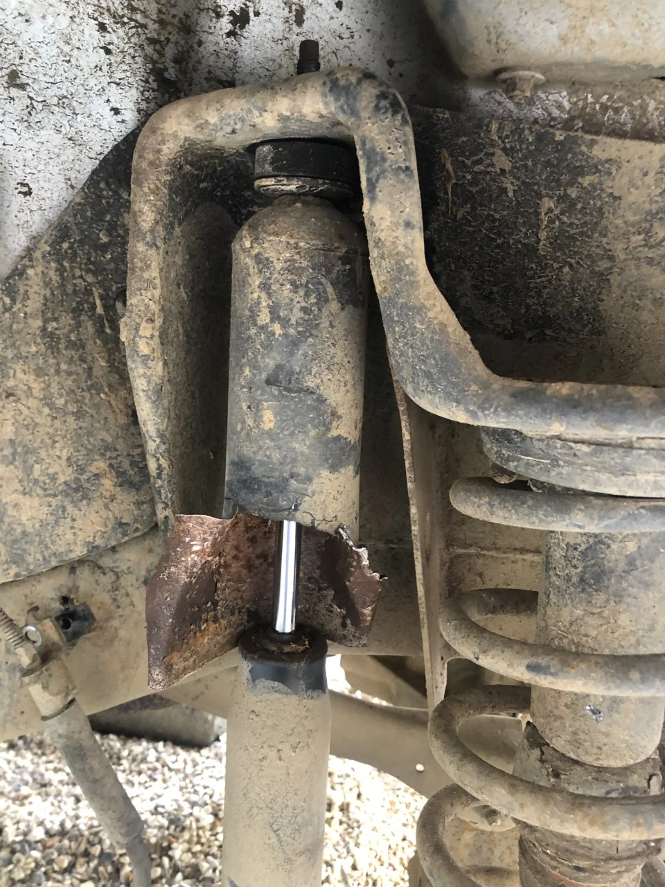

Couldn't get a big enough set of vise grips on a Sunday afternoon. Hadn't seem suggestion of oil filter wrench. So, bit embarrassing, but it got ugly. I snipped at the metal sleave over the shaft until I had a section I could get some vise grips on...
One of the nuts was so stuck on the top of the shock actually sheared off anyway, second one undid but was by far the most unhelpful nut I have had on the Jeep so far.

I tried holding the shocks with a vise grip on the hex part didn't work. I tried a vise on shaft didn't work. Then I used a impact from above after removing the airbox, along with keeping the vise on the shock, worked like a charm. But on the driver side not at all. Mind you I soaked in kroil for 5 days before hand, I even used angle grinder to clean out the upper stud threads. The nut only made it halfway then stopped. I went back and forth tightening and loosening but it wouldn't thread any further up. I tried drilling a hole through both sides of the metal cover of the shock, sticking a flathead screwdriver in there, and letting the flathead hit the shock mount for leverage. all it did was destroy the metal cover like UK Tj just did above ^^^^^^
At that point you have two options, you can cut the shaft or you can snap it, and it doesn't make any difference at all except one takes 2 minutes and the other takes one nano second. And it doesn't require any special rigging or gigging up of any method, you just grab the body after freeing the lower bolts and pull it with like 20 pound of pressure and it snaps. It falls to the floor doesn't go flying or anything like you need safety googles or something. It won't even scratch up the frame shock mount hole. No one could tell you by looking at the shaft whether it had been cut or snapped. But you wouldn't know because clearly you have only worked on clean jeeps and that's good for you that's great. I have a jeep that was garage kept and another that has a fair deal of rust issues. It's not for everyone. In the OP's case he sheared the nut/stud so there you go.
