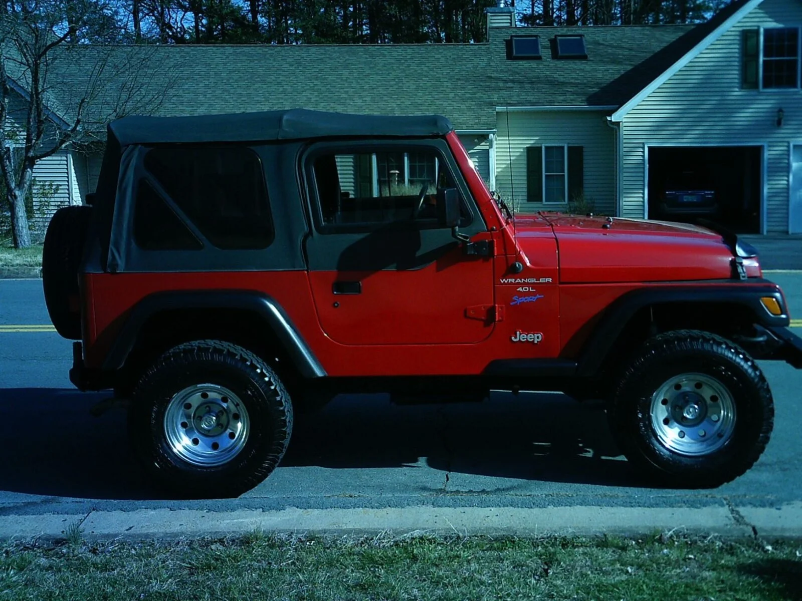

Why Rusty's? I ran some 2" BDS springs and a BL with 32s on my old 98'. I always add 3/4-1" more lift up front because I don't ride people in the back.

I went with Rusty's after a buddy of mine suggested them. He ran with their stuff on his XJ and had nothing but good things to say. Love the way your 98 looks and sits! kind of what i'm going for.
