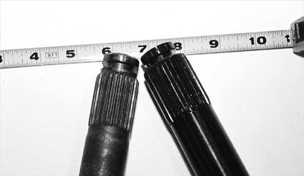

Thought this should be here.
Comparing a Dana 35 shaft to a discontinued superior super 35 shaft.
On the left, stock 27 spline measuring 1.18”
On the right 30 spline measuring 1.31” (Dana 44 size)
