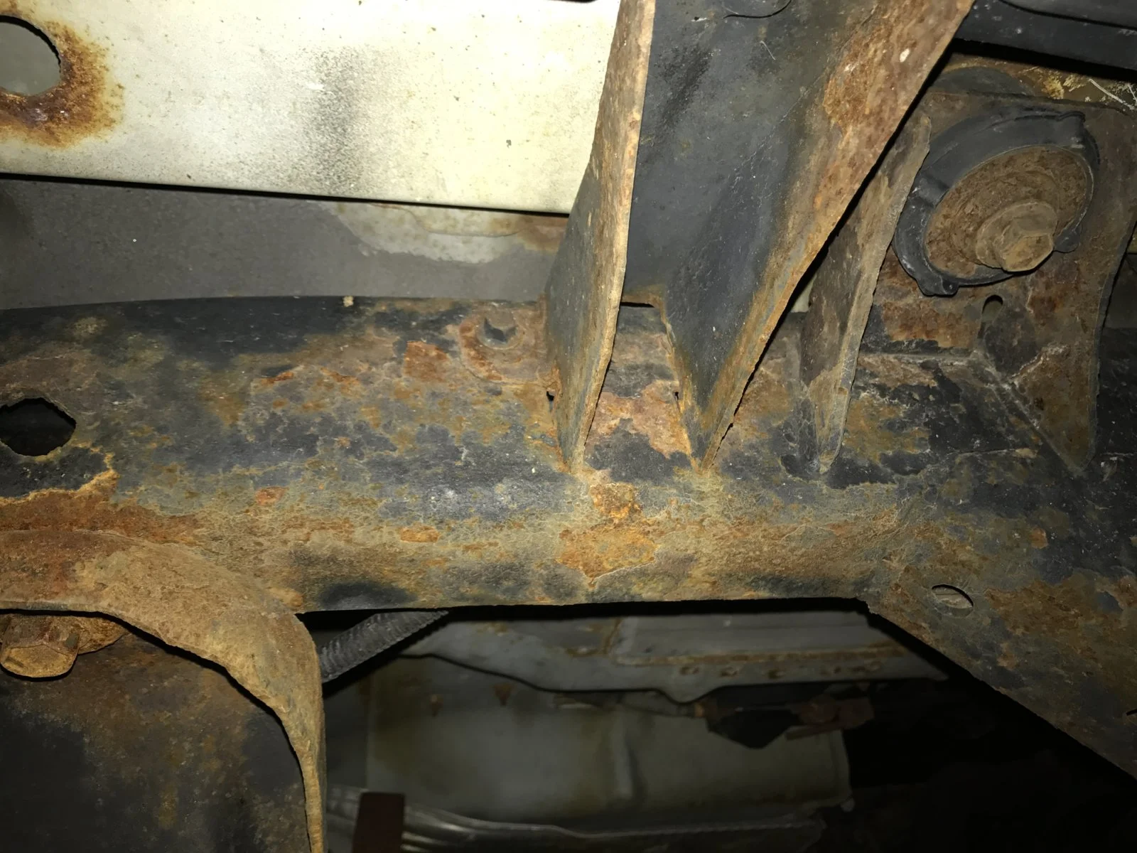

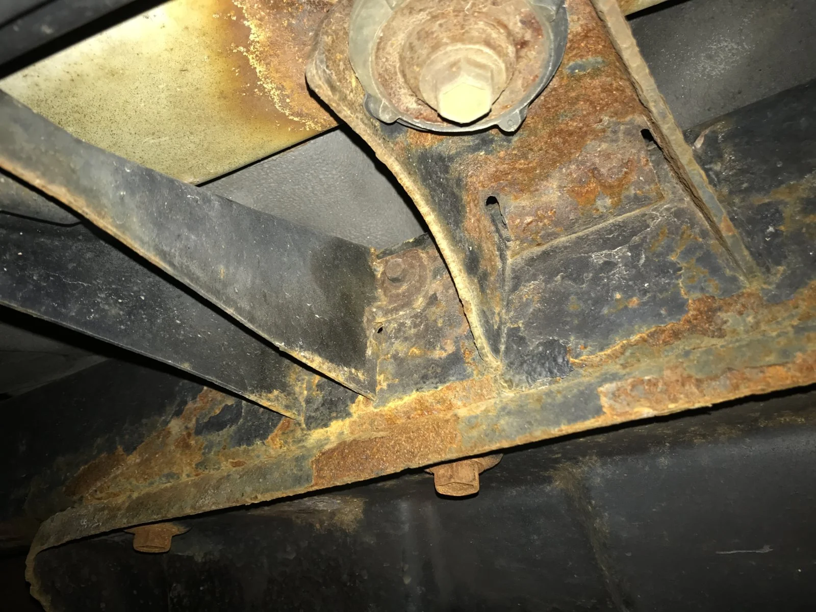

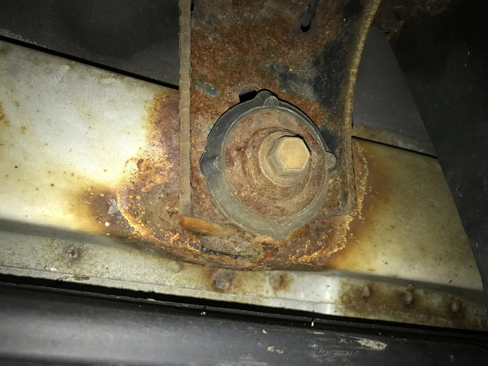

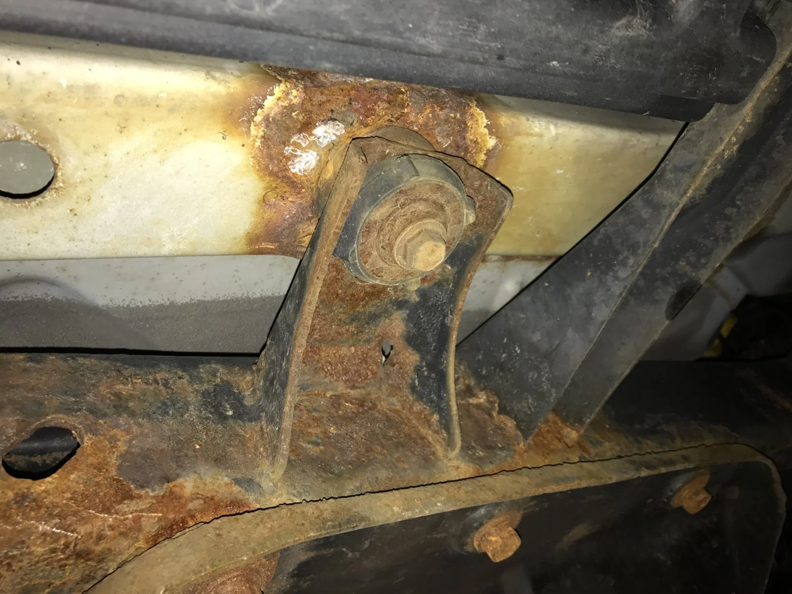

I recently blindly bought a TJ, without looking at the frame it much of anything else. It was sold to me very overpriced and I was the fool who bought it. I love Jeeps, the spirit and the freedom of it all. I have put around 4K into my Tj, new sway bar links, new struts, new tires, new stabilizer, alignment, and it still vibrates over 65 for some reason. I took it to a reputable jeep dealer in town to completely inspect it and they say it should be better yet it still vibrates... should I take it back? Also the steering is only straight on flat roads. If the road is tilted my wheel wants to turn toward the tilt... also, when crawling under it there are bad rust spots on the frame. Not really the main part thank god but enough to have me worried. I'm posting pics. I love my tj and I don't want to give her up but in your guys expert opinions, should I? Here are pics of the rusted frame... most of it appears to be surface rust except for where these two bolts are. They are the worst places...
Why the panic? You are already into it, I have seen rust a ton worse than that! I would re-mediate it as best as you can even if it just means wire wheeling it off and spraying it with some por15 or Eastwoods rust encapsulate. You paid what you paid..non of them are cheap anyway. I am sure if you start a thread here and give all the specifics and you will get some great direction about the vibes. Summer is almost here and you have one of the best summer vehicles.

Honestly unless you take it somewhere to get it undercoated very well or do it yourself, Ohio winters are going to wreak havoc on that frame unless you get it treated. Wire wheel the crap out of it and spray everything with por 15 or rustoleum rust preventor. Looks like a very nice Sahara that just needs a clean up. Don’t lose hope just yet. 4K is hard to recoup.

I’d begin looking for a good used frame and start planning a future frame swap. Meanwhile, coat the living hell out of it with FLUID FILM or CRC 06026 and do the same with all the cavities and areas under the tub. Speaking of the tub, the body mount areas are looking a bit suspect but the protectants will help extend the life. Keep it clean in between snow falls and drive her till it’s time to make the swap.

It’s the value you get out owning one and you may realize that you didn’t over pay for it come summer. That being said, you are pot committed! I am in Ohio too and the rust on my frame looked worst than yours. When I bought it, I took a screwdriver test to the frame and tried to poke holes in it to see the severity...it was fine. I did have the underneath coated to preserve it as long as possible since it will be a daily driver and not just a trail blazer or garage Queen. Also, when parts need replaced is when I upgraded and customized things. So keep that in mind. As for the vibes, I had them when the pinion seals were replaced and I had the mechanic double check the angles on the drive shafts. Even though they put a mark on the shaft before replacing them, it was still off the slightest. Once back to factory specs, all was better at highway speeds.

What you show for rust does not look too bad. But the rear of the frame is likely worse.
I'd use a bunch of Moove It or PB Blaster and try to drop the skid plate. That is often the worst part. If you are keeping it... I'd recommend lifting the body and cleaning up the rust and painting it. Not bad today but rust has a way of accelerating once it gets a hold.
