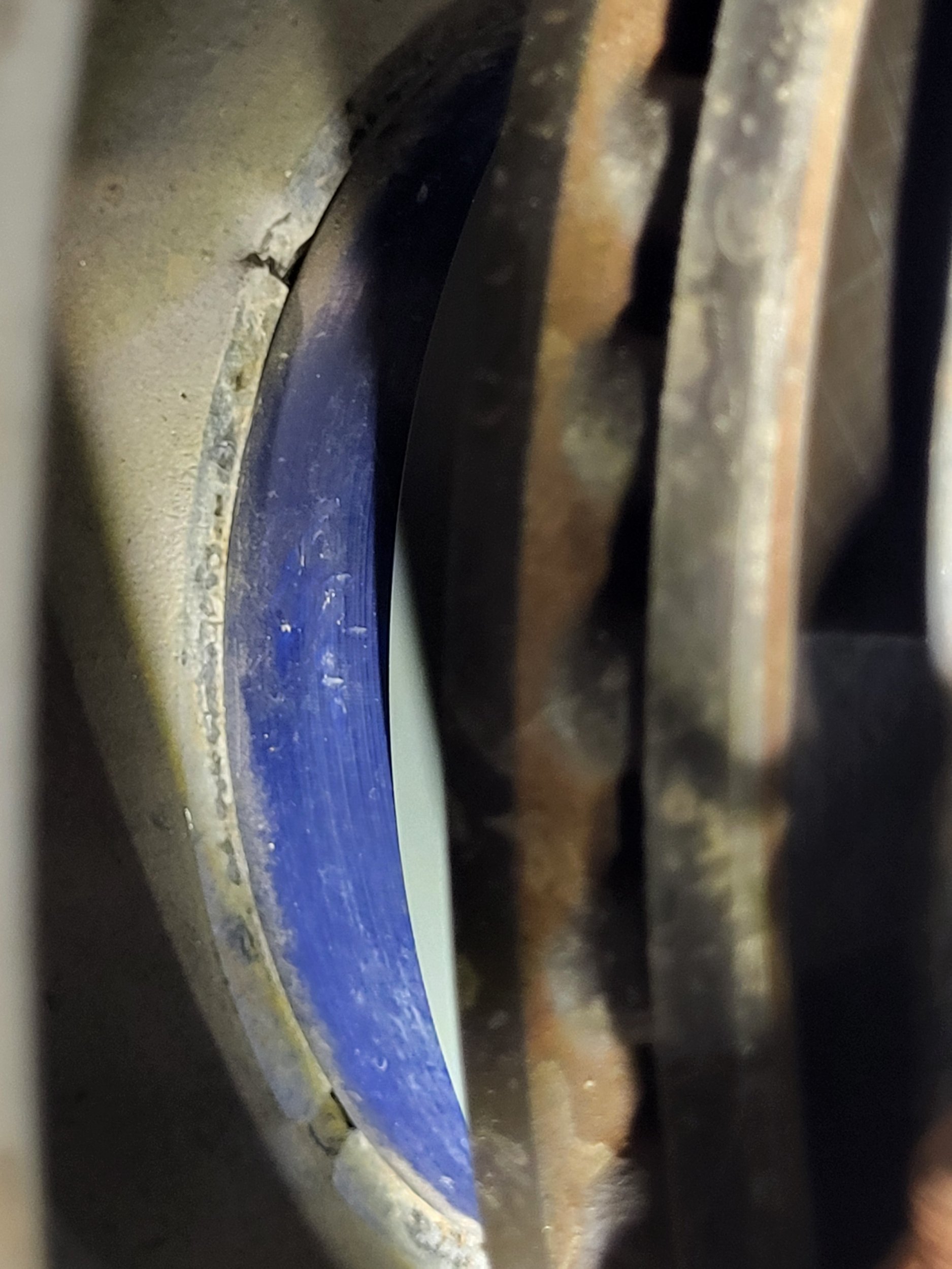

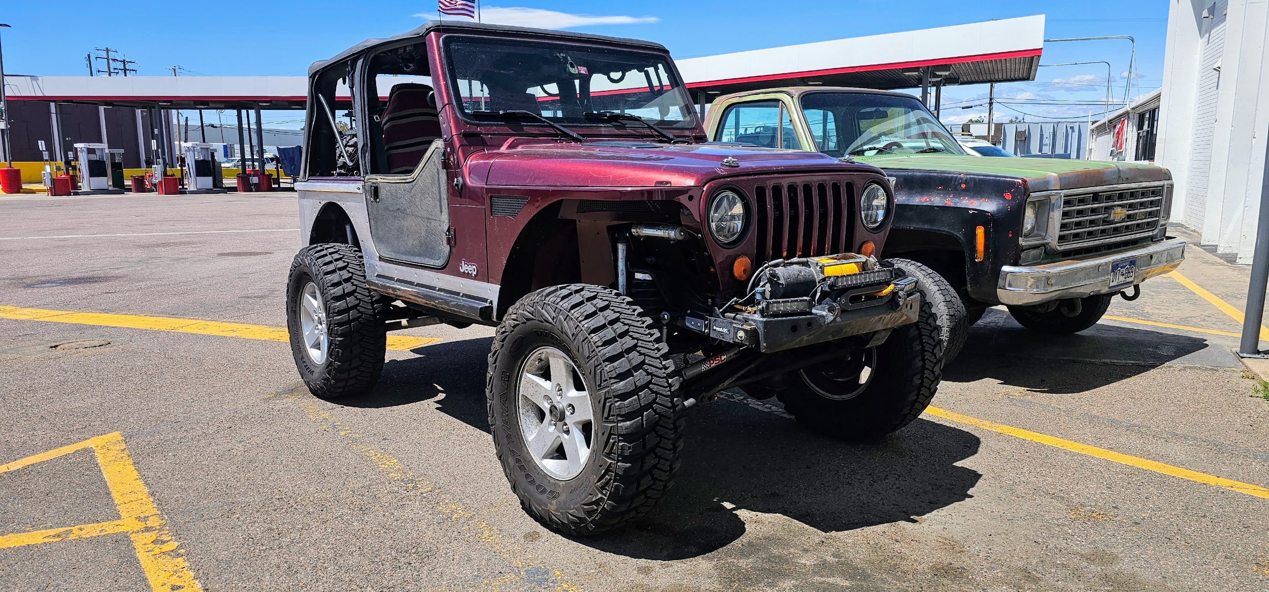

They are blue. I thought I took pics with the wheels off but couldn't find them. I attached a pic with the wheel on just to show the color. The part number I have is WHS-002.
The good news here is that the OP used quality wheel spacers.
So with that information I'd say there isn't a reason to remove them due to fear of them being cheap spacers. Now you need to figure out if you need them for steering clearance or not. Running them increases the wear on your ball joints plus other issues with steering.

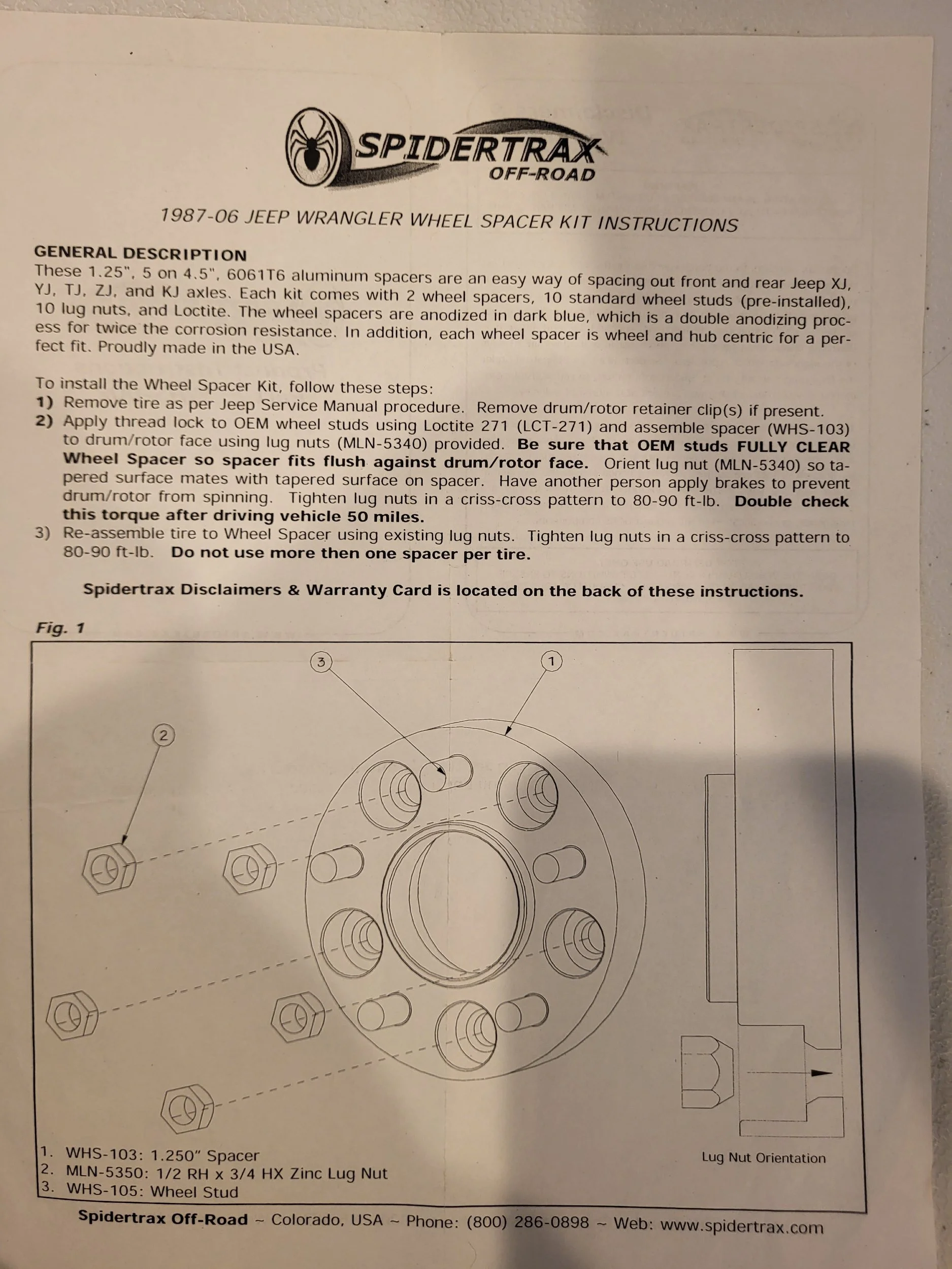

If you want to confirm that the spacers are attached with a thread locker, then you will need to remove the spacer nuts and put thread locker on yourself. 😉

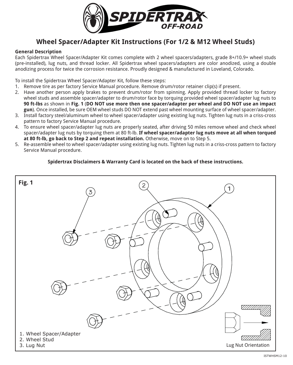

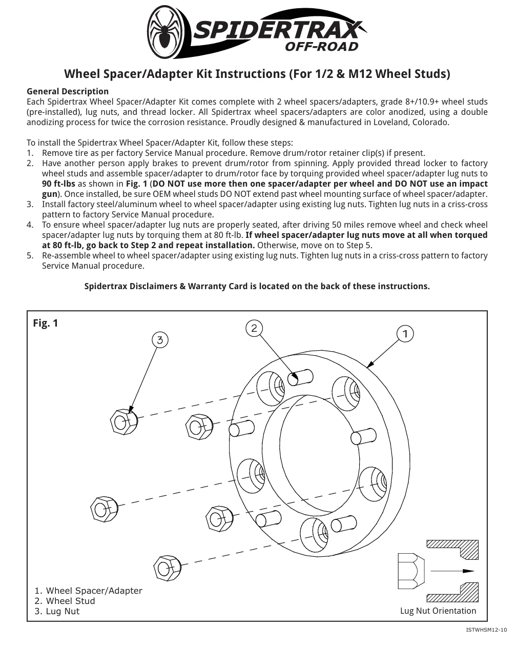

Here are the directions on how to install & then check your lug nuts on your spacers.
