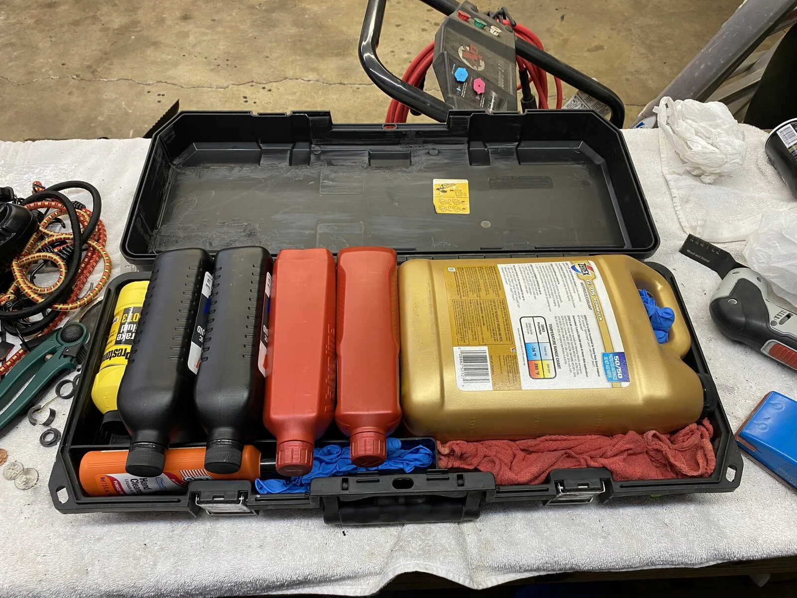

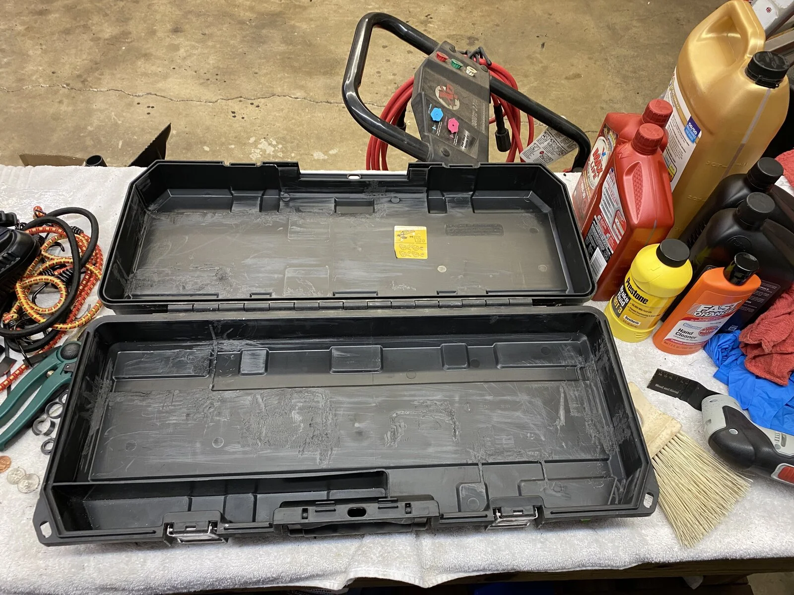

I cut out the dividers of a Dewalt rip saw case to use as a fluid carrying case. I don’t have it with me at all times, just long trips or off-roading.
Thinking about cutting up one of my smaller cases for some gear oil bottles.
