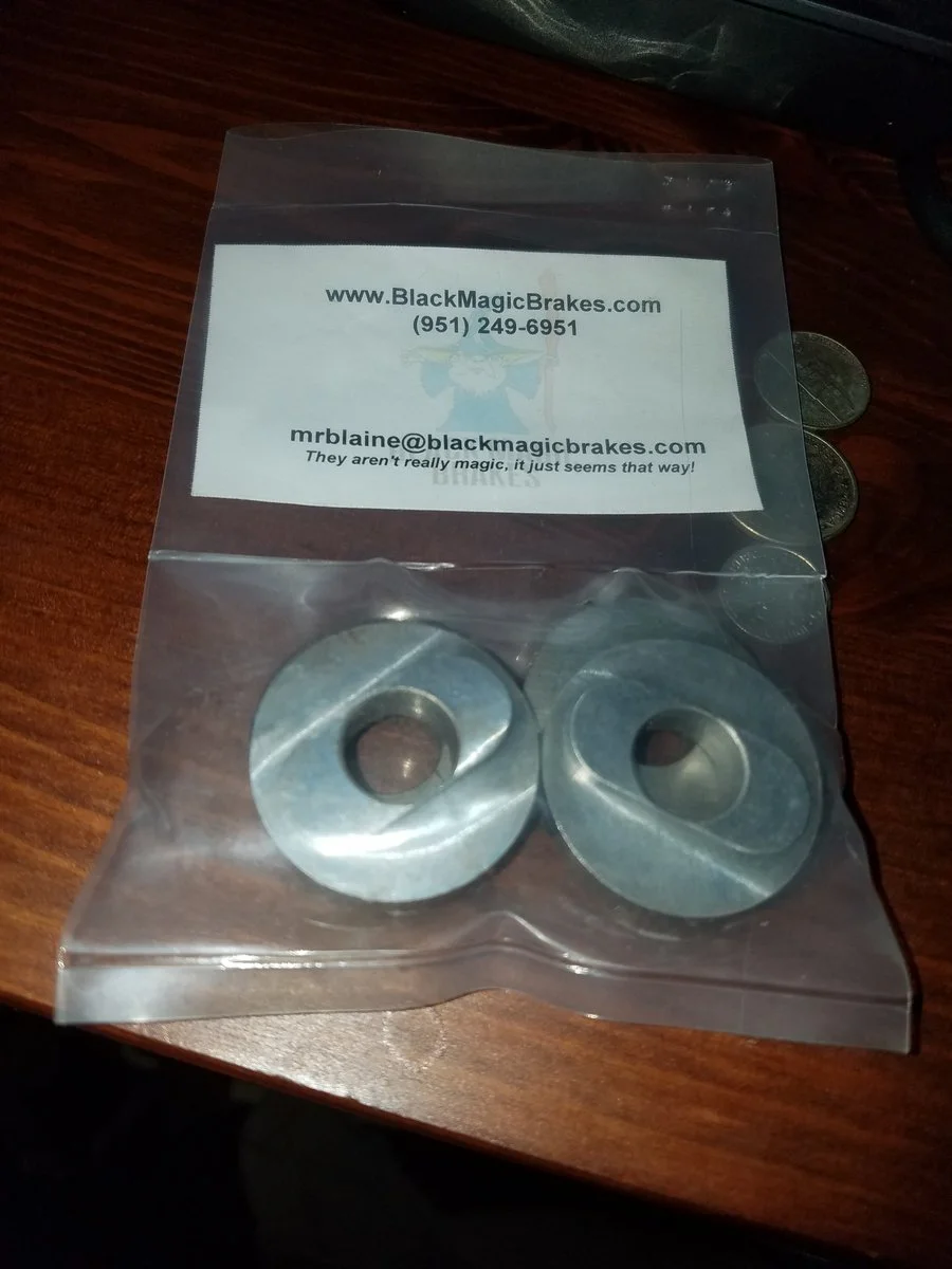

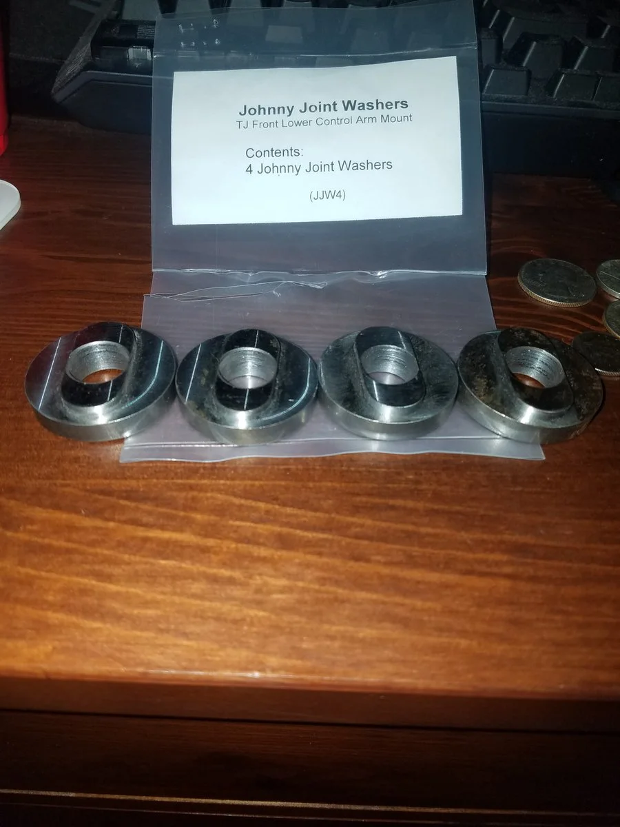

Just got the johnny joint washers in the mail today.
Super fast service, thank you.
The machining is top notch.
Paying $10.25 each, seems like I'm getting a good deal for the quality. Very high quality. I haven't put calipers on them yet, but they seem to be absolutely identical to each other.
Cant wait for some free time to get them installed.

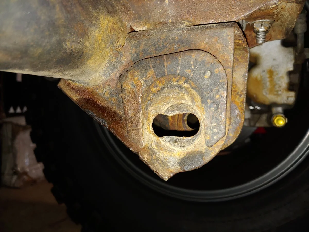

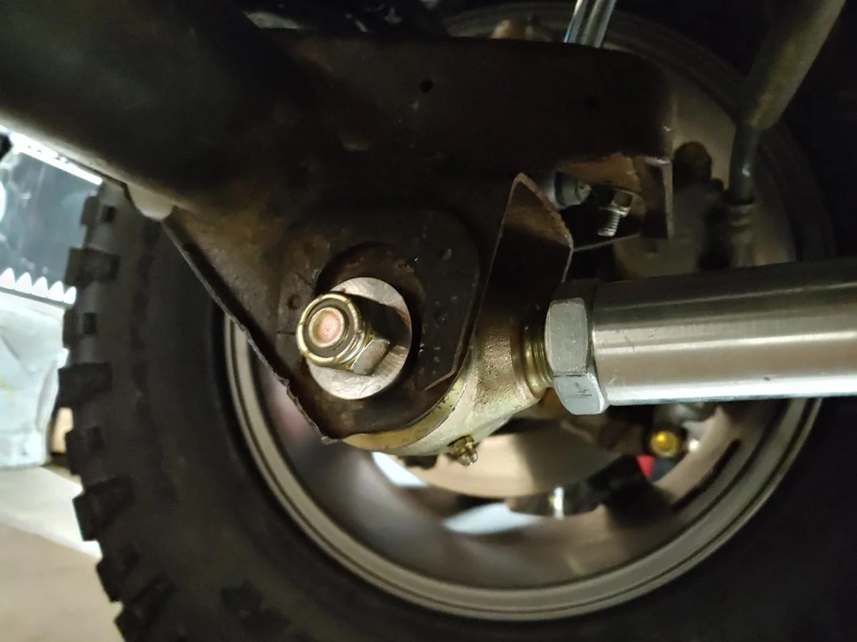

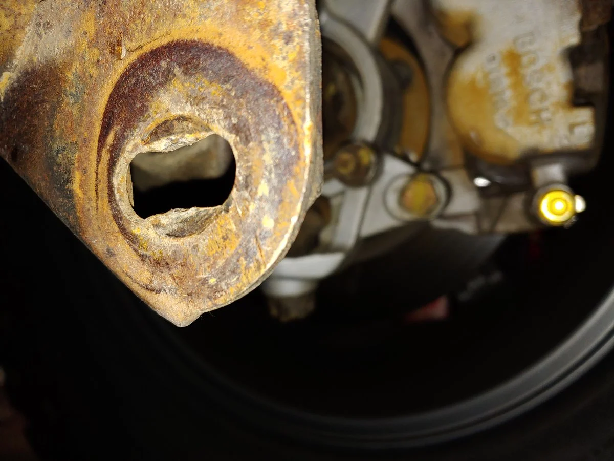

Mine worked well for a number of years. On my second axle towards the end I had to weld them in place, the slot was beat to hell from the previous owner. But still a good purchase. On the third axle, I just have a 9/16 hole and no slot.

I really like those things. The fact that such a part exists shows attention to detail among so many other things (y)

I wasn’t aware I needed these until I read a post by @Jerry Bransford regarding replacing the front lower CAs - very happy with them as well.

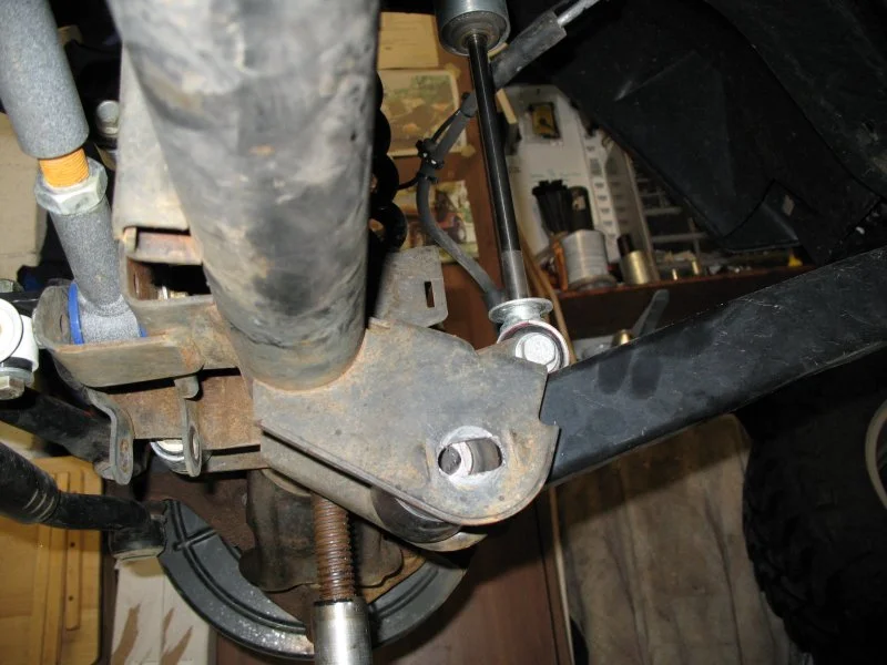

@Midtenn - the front lower CAbolt holes are slots, these fill the slots and provide just a bolt hole instead. I don’t know that it’s all TJs or specific model years (mine is an 06).
This image is from a JK, but similar look:
Reactions: Jerry Bransford

Would someone go over how these work, both to help the membership who wants to know more and support Blaine's efforts ?

What does this do?
The front axle's lower control arm mounting bolt opening is a slot, not a bolt hole. The slot is there to allow a pair of concentric washers to move the bolt forward/backward to allow for caster angle adjustment. That ability was removed half-way through the 1999 model year. So without the cam bolts in later TJs, the front lower control arm bolts can slide fore/aft in that slot if the bolt loosens enough. These washers prevent that from happening, it locks the bolt dead-center in the slot. Caster angle adjustment is accomplished with adjustable length control arms, which give more of an adjustment range than the early cam bolts did which were limited to about 1.5 degrees of adjustment.

Damn you guys. You suck. Now I absolutely must have something I did not know I needed until I read this thread.
While Jerry is absolutely correct in where they go, the why is in the name of the part. Early on, all Johnny Joints shipped with greaseable bolts. Without the end of the JJ barrel in contact with the inside face of the mount around the whole area that touches, the grease would go in the bolt and come back out around the outside of it into the slot in the mount. The JJ washers are to provide a seal so the grease would go into the race.
