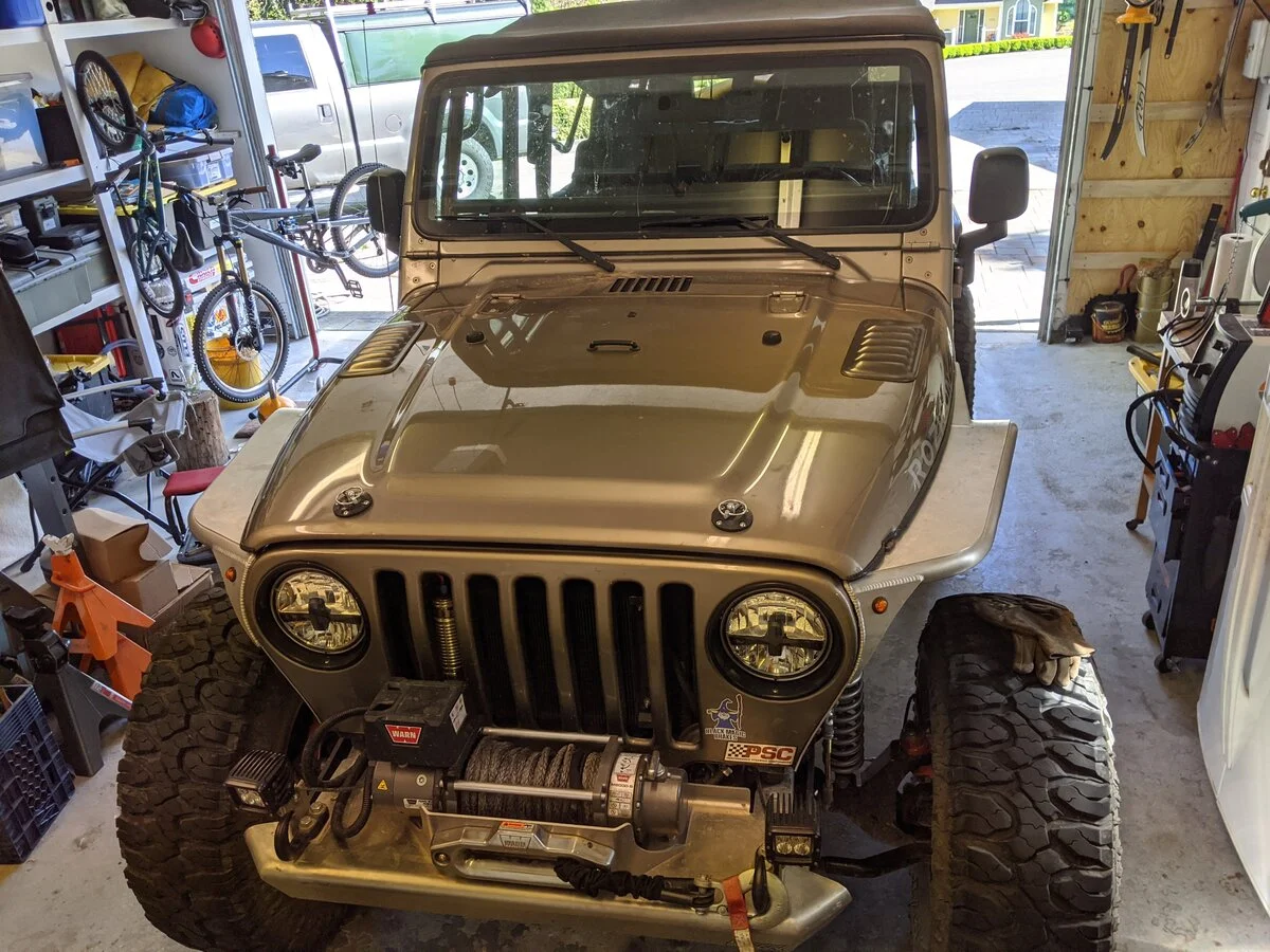

98 5.9L Grand Cherokee. I got mine for $20 at a junk yard.Which vents do you have & where did you get them?
I’m on the lookout now, not easy to find.98 5.9L Grand Cherokee. I got mine for $20 at a junk yard.
How did you steel that, I paid just over a hundred bucks for mine in great shape, ended up not wanting to cut my hood so they are on the shelf.98 5.9L Grand Cherokee. I got mine for $20 at a junk yard.
Pure luckHow did you steel that, I paid just over a hundred bucks for mine in great shape, ended up not wanting to cut my hood so they are on the shelf.

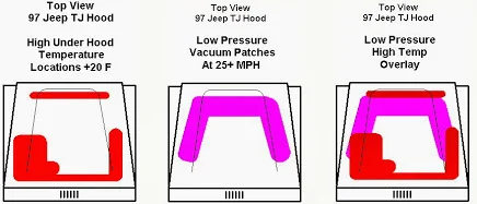

All I know is that the intake temp decreased about 5deg after the louvers went in.Has anyone actually done any before and after under the hood temperature measurements to see if these do any good?

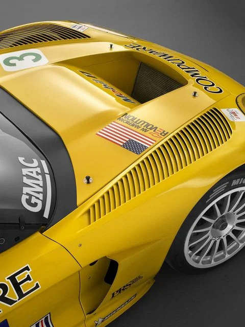

Here's where they should be placed, and why. I'd really like to see the front one with some kind of scoop that goes as low as possible so radiator air blows straight out of it, like this View attachment 260905
