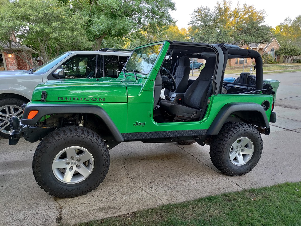

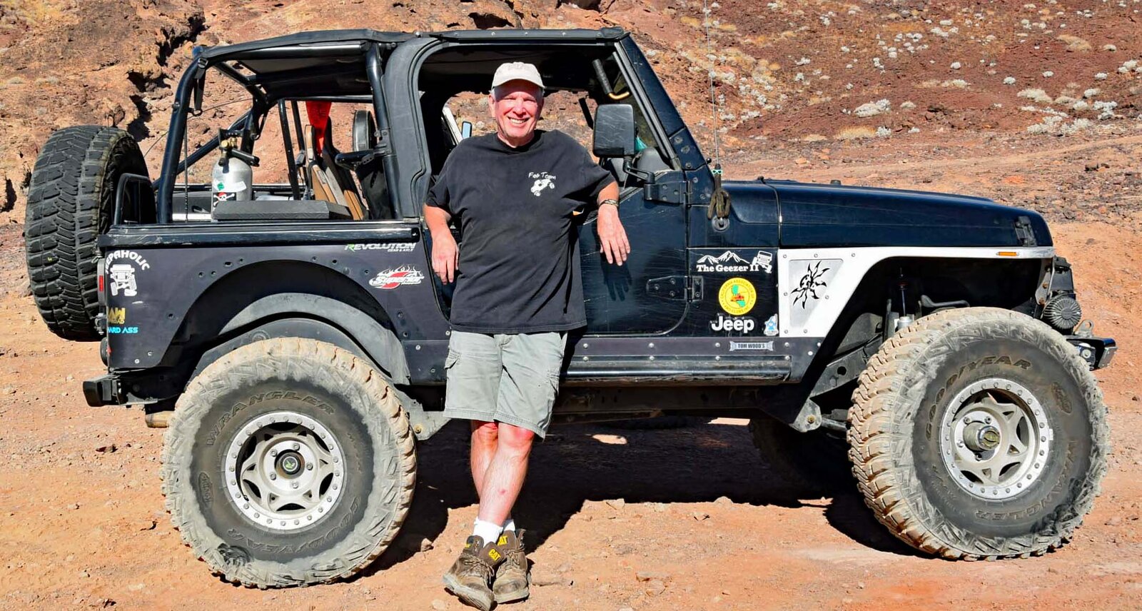

2.5" SL + 1" BL
35s
Suspension lift consists of 1" H&R springs, ACOS adjustable front spacers adjusted all the way up to 1.5", 1.25" spacers in rear, so actually 2.25" - 2.5" SL

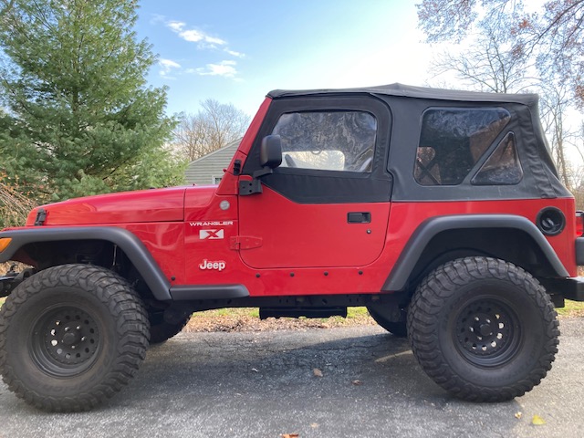

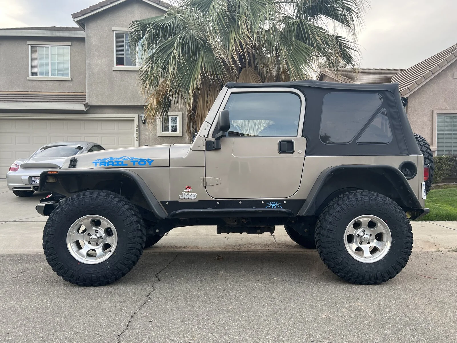

my less than common setup, 33/12.5s with 3 inch spring lift up front and 2 inch rear, no additional body lift or spacers, goals are appearance/leveling related as opposed to performance

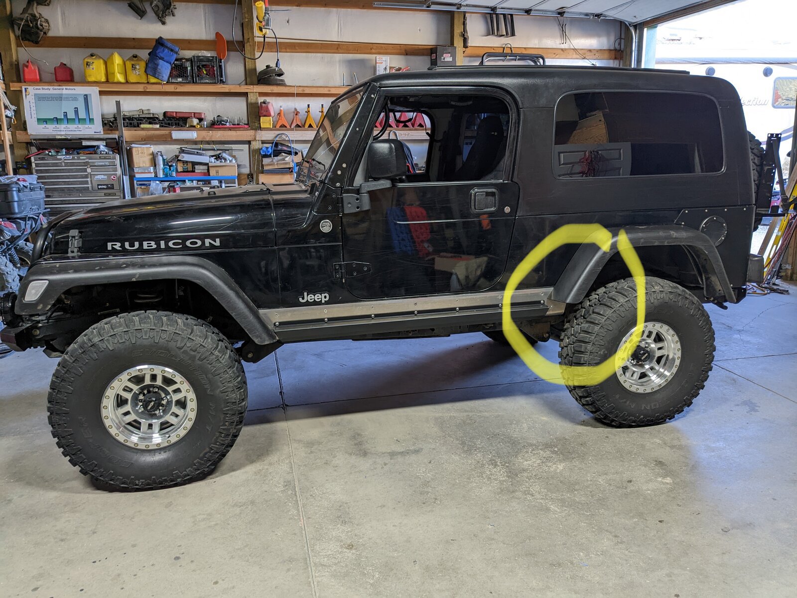

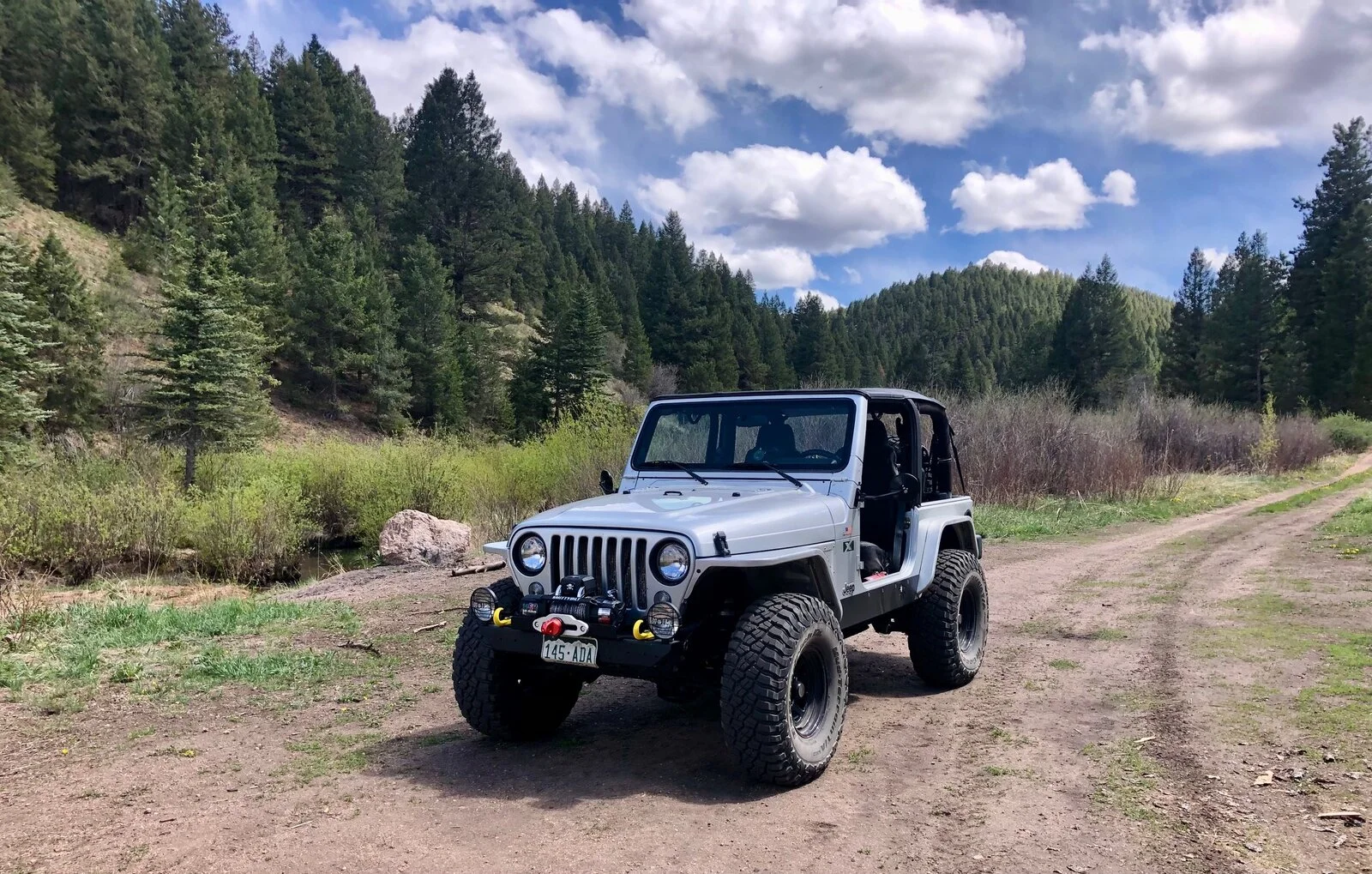

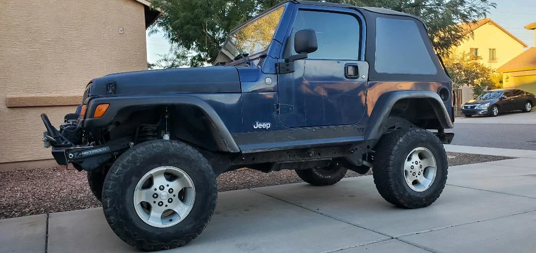

For comparison to above, here’s one with a 3” spring lift F/R with 33x12.5x15. No body lift. Notice the rake. It’s light, especially in the back. I plan to go to 4” springs (and shocks) up front for increased travel and leveling.
Is your flare on backwards (wrong side)?
Edit: really nice Jeep btw.
Yes, at the time of the photo a few weeks ago doing a quick test fit, I had it wrong side. Fortunately, I realized it didn't look right and caught my error before stuff got bolted back on. Forgot I still have that photo. Flare is correct in the top picture, which is more recent. Good catch.
