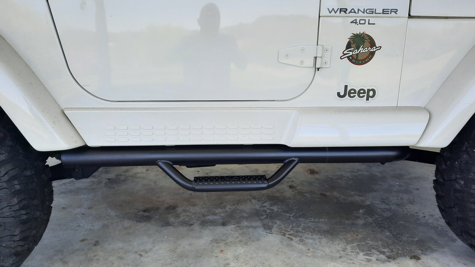

I went with these steps from Rough Country.
https://www.extremeterrain.com/roug...de-step-bars-black-9706-tj-excluding-unl.html
They were easy to install, bolt between the frame and body and are rock solid.

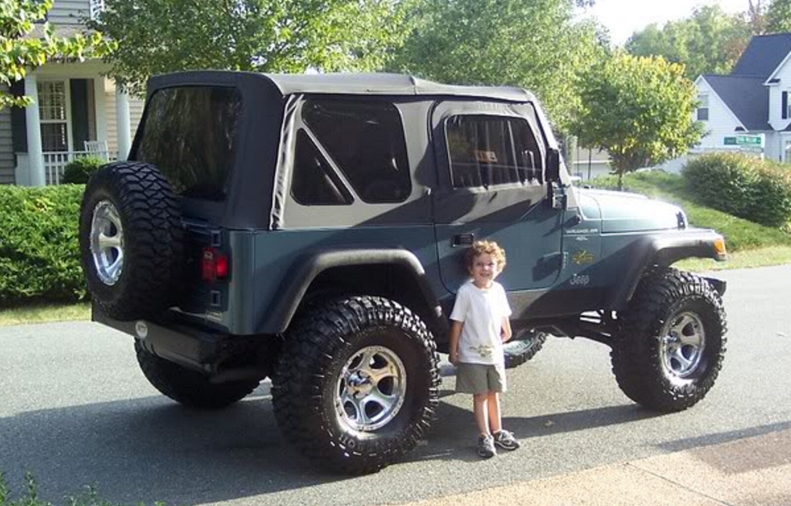

I've never understood the concept of steps on lower Jeeps. My 5 year old nephew had no problems climbing in my lifted Jeep on 35s. It made a man out of him. :cool:
My daughter uses the Jeep as a jungle gym to get in and she’s proud she can
I've never understood the concept of steps on lower Jeeps. My 5 year old nephew had no problems climbing in and out of my lifted Jeep on 35s. It made a man out of him. :cool:

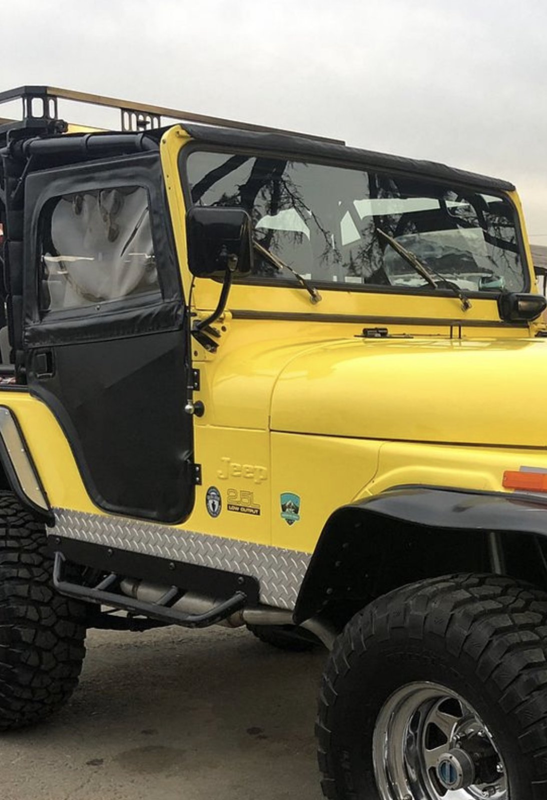

I added mine plus a set of grabars due to a back injury which made lifting my foot up high enough to get in almost impossible.
After having surgery to add a few aftermarket titanuim parts to fuse 3 vertebrae, I no longer use them but they still come in handy for my 83 yr old father to be able to ride with me.
