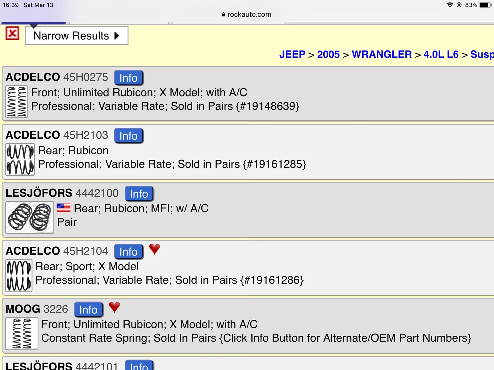

The Springs that are linked in your post say that they are for 97-04. Does this mean that they wouldn't fit the 06' or is there another set for the 06?
The only difference whatsoever would be if you have an Unlimited model as they use a rear spring with a stiffer spring rate (due to being heavier). If you have a 97-06 TJ (short wheelbase) then the springs will fit just fine even if it's an 04-06.
Rubicon springs?
Rubicon springs?
Rubicon springs are the same. The only differences I am aware of on TJs are the 04-06 Unlimited models which have a stiffer rear spring. People sometimes use them on the SWB TJs that are particularly heavy.
