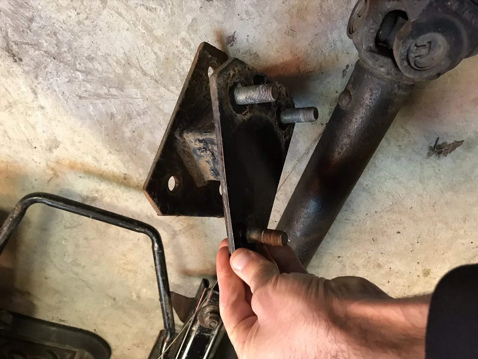

I have a 32 11.5 spear that I need to be able to put back on the Jeep. My factory mount will not let me put the rim on

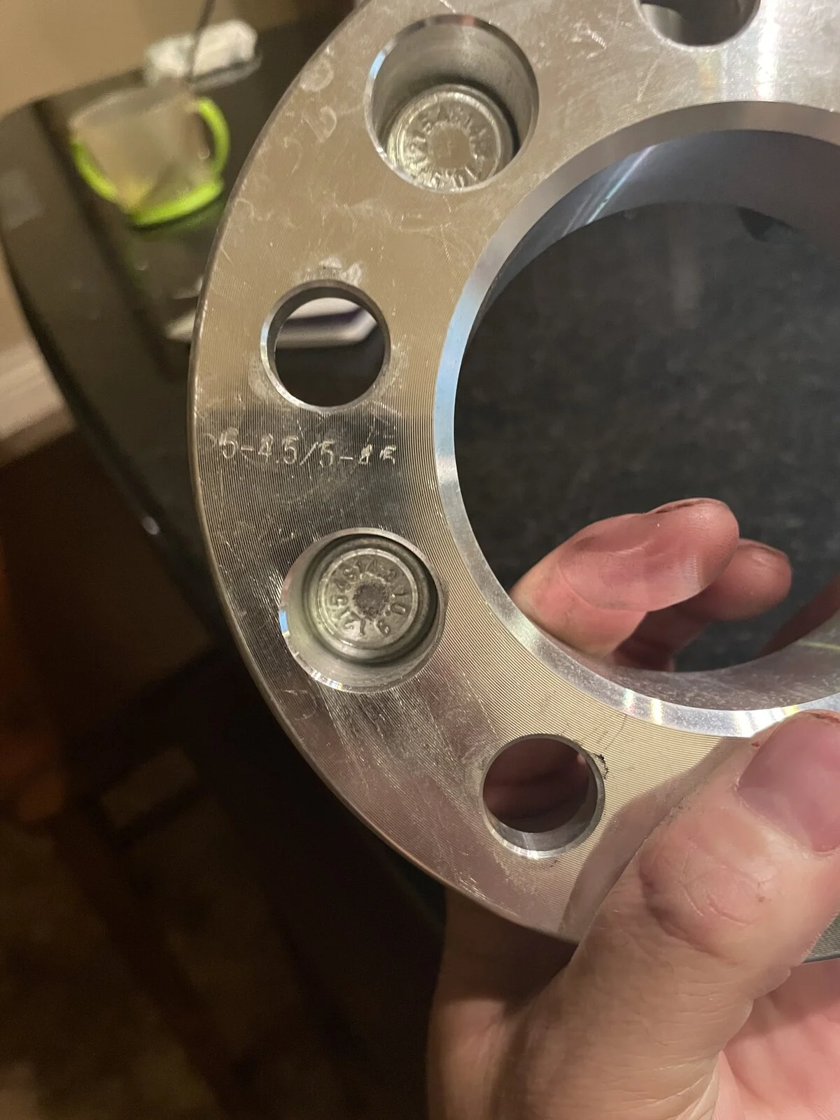

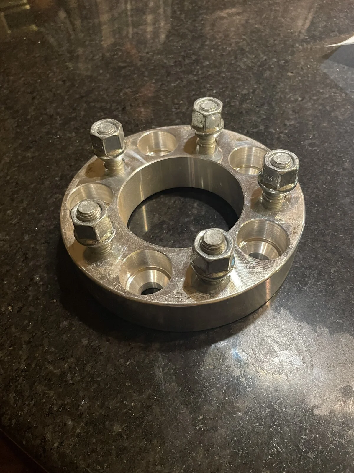

I was in the same situation; I used something like this. Not cheap exactly, but at least it was sold individually. I installed the Morryde kit with offset brackets so I don't need the spacer anymore. PM me if interested.
Reactions: JMT and Lax22

I have factory ACOLA rims and I can’t get the spear tire on the factory holder. The lugs are to short so I cut the rubber pieces but still can’t get enough threats to put lugs on

It sounds like you have so much backspacing on that rim that when the tire hits the snubbers the rim still isn’t seated on the tire carrier. The spacer @TRevs offered you should work to get the rim seated and threads engaged. Then you’ll have to get the snubbers adjusted so the tire is firmly against them.
