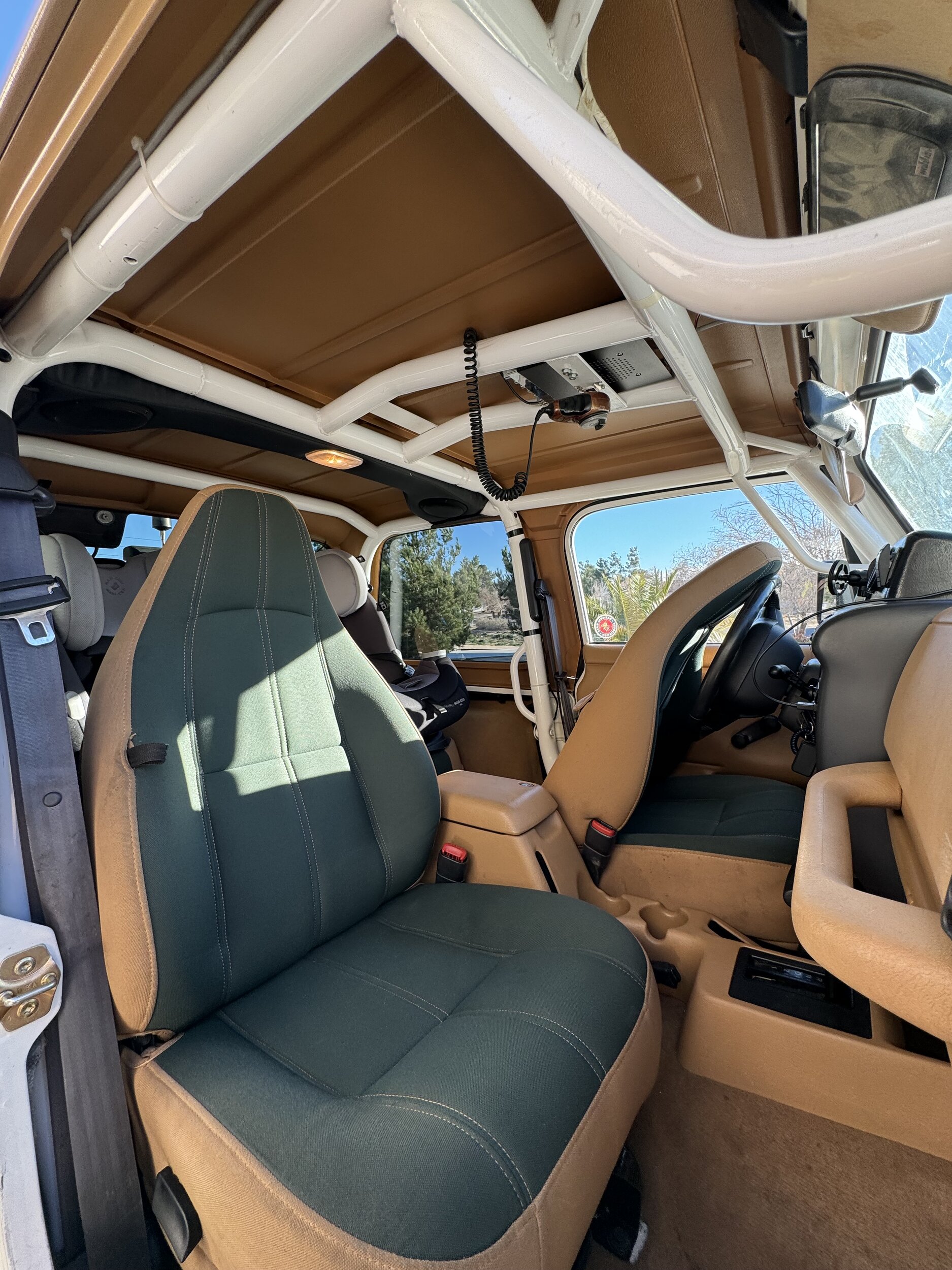

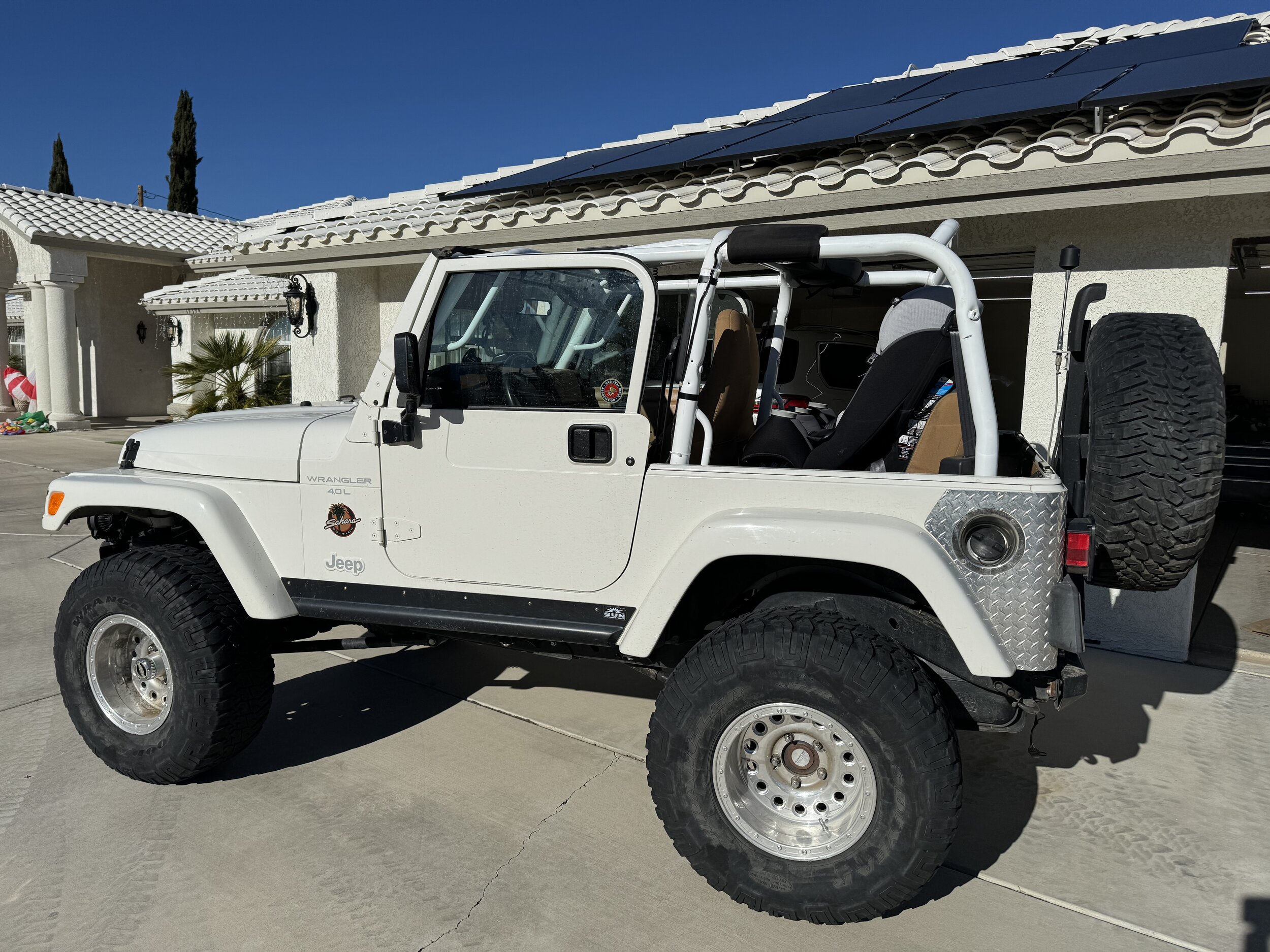

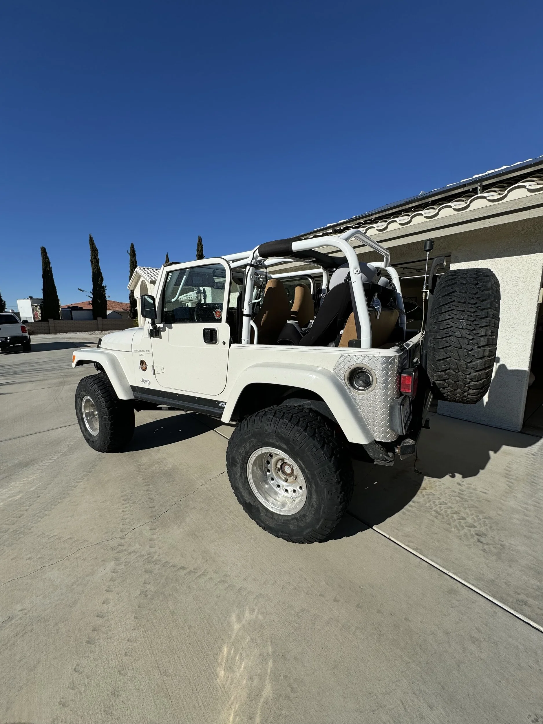

I dont got a Sahara but i sure as hell would love to oneday paint my whole dash and top that saddle color and some custom PRP enduro seats to match everything up !
Love the addons to the cage too ! Do you have an idea where its from ?
I actually have no idea where the cage is from, I wish I did because it's the most asked question I get lol. The SEM Camel color really is a very close match to the Sahara interior.

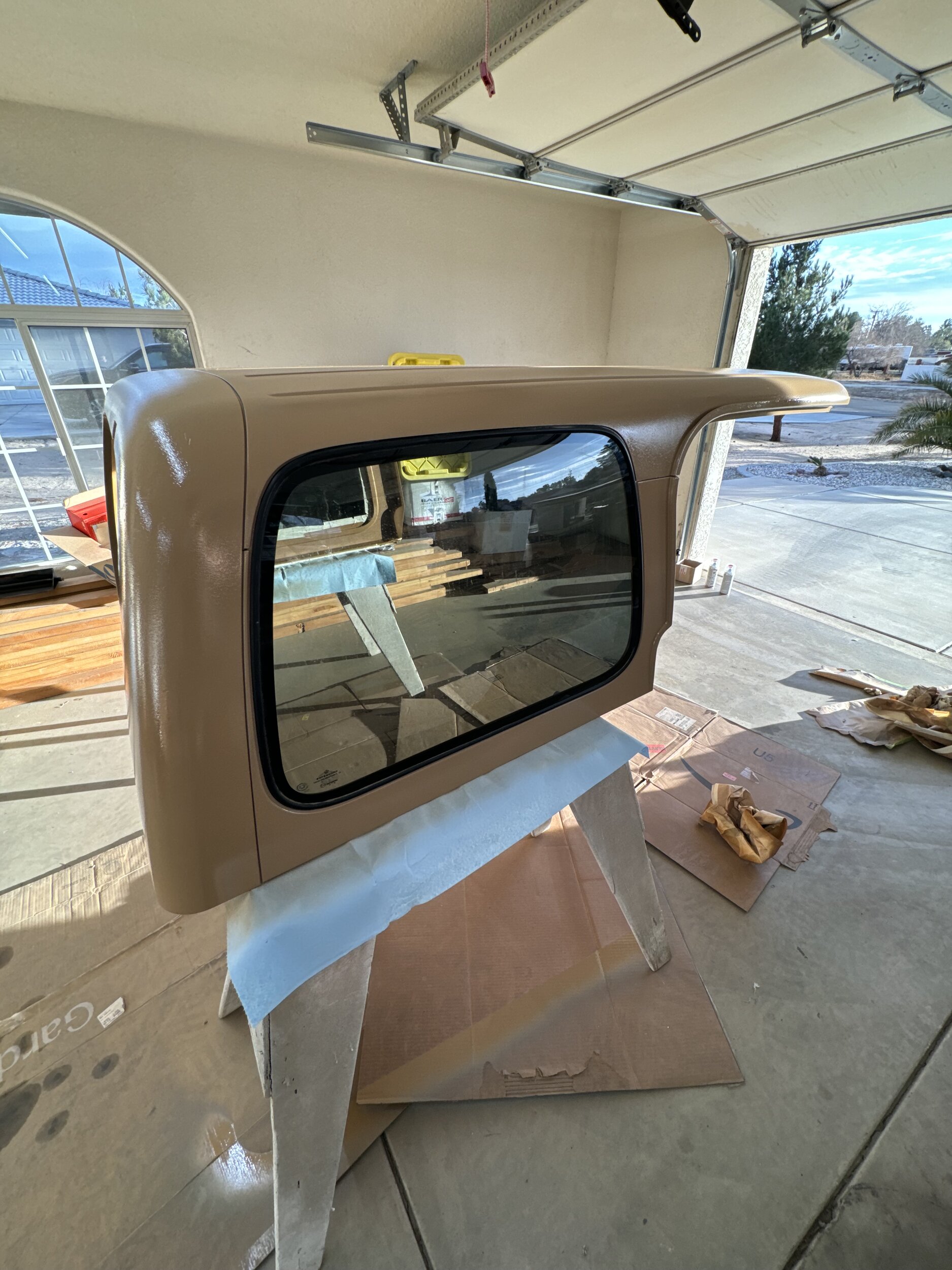

So I'm back to report on the next project that I have finished up. I had an old hard top sitting in my back yard waiting to be refinished so I decided to get that done. I really prefer the hard top over the soft top but I wasn't going to mount it up without refinishing it. So here's the process I followed to get that done!

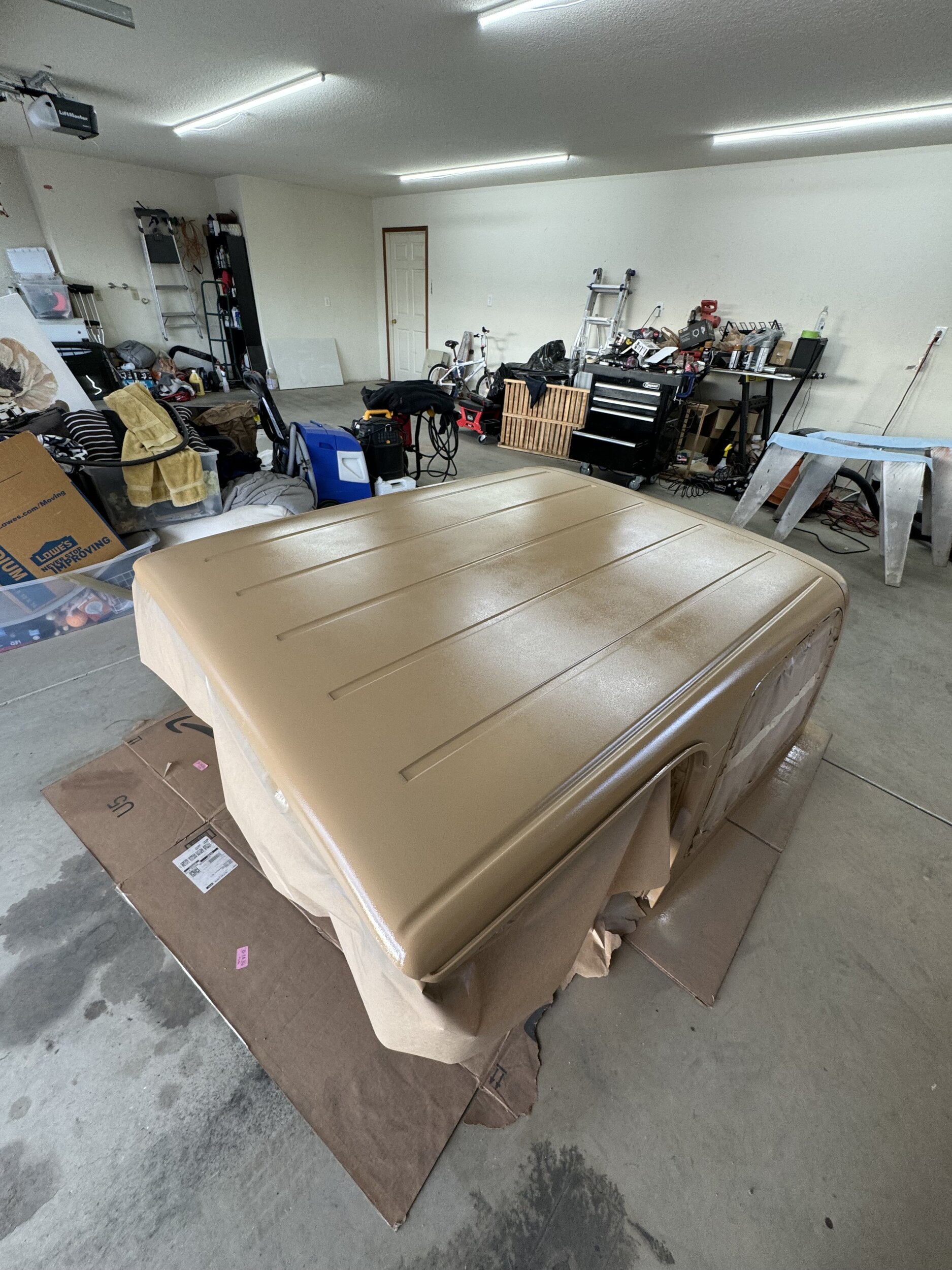

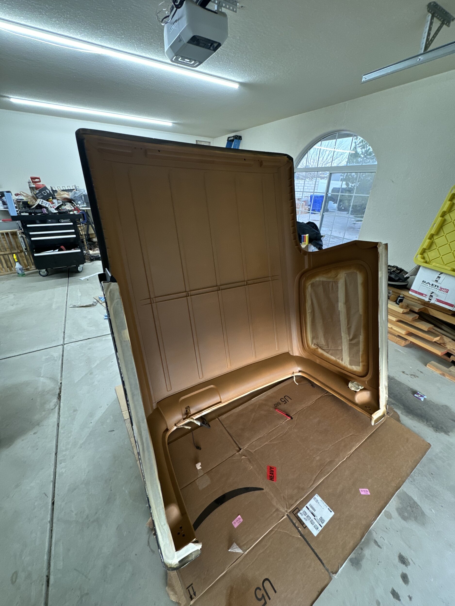

I started with the interior of the top, since I have a Sahara I wanted to tie the top interior color into the interior of the truck. To do this, I decided to spray it using SEM Camel paint. This was the closest color I had seen that would match the interior color. I took the top and brought it into the garage to get it prepped. I started off by flipping the top upside down and onto some saw horses so I could get a better look at it without having to sit on the ground. I started out using a degreaser to get the gunk loosened up. The top had been sitting outside for a few months so there was a lot of dust and prior to this it had been hanging in my Dad's garage for probably close to a decade. After hitting it with the degreaser, I then gave it an IPA bath to get it ready to paint. I let it completely dry out and took it off the saw horses and laid it onto it's back pillars and propped it up so I could keep my spray paint can as vertical as possible. This SEM paint from the spray can doesn't like to spray properly unless it's vertical. I chose to not use a primer for the interior, which was probably a mistake, but either way it turned out great.
This is how it turned out after about 3 coats and before I did a final inspection and any touchups. I'm very happy with how that turned out. Due to the nature of the SEM paint not wanting to spray correctly unless the can was vertical, it made it a little tricky to get into the tight areas. The spray cone was also a very weird shape but I got it all figured out and I'm happy with these results! I have more pictures of it totally finished/mounted up below.

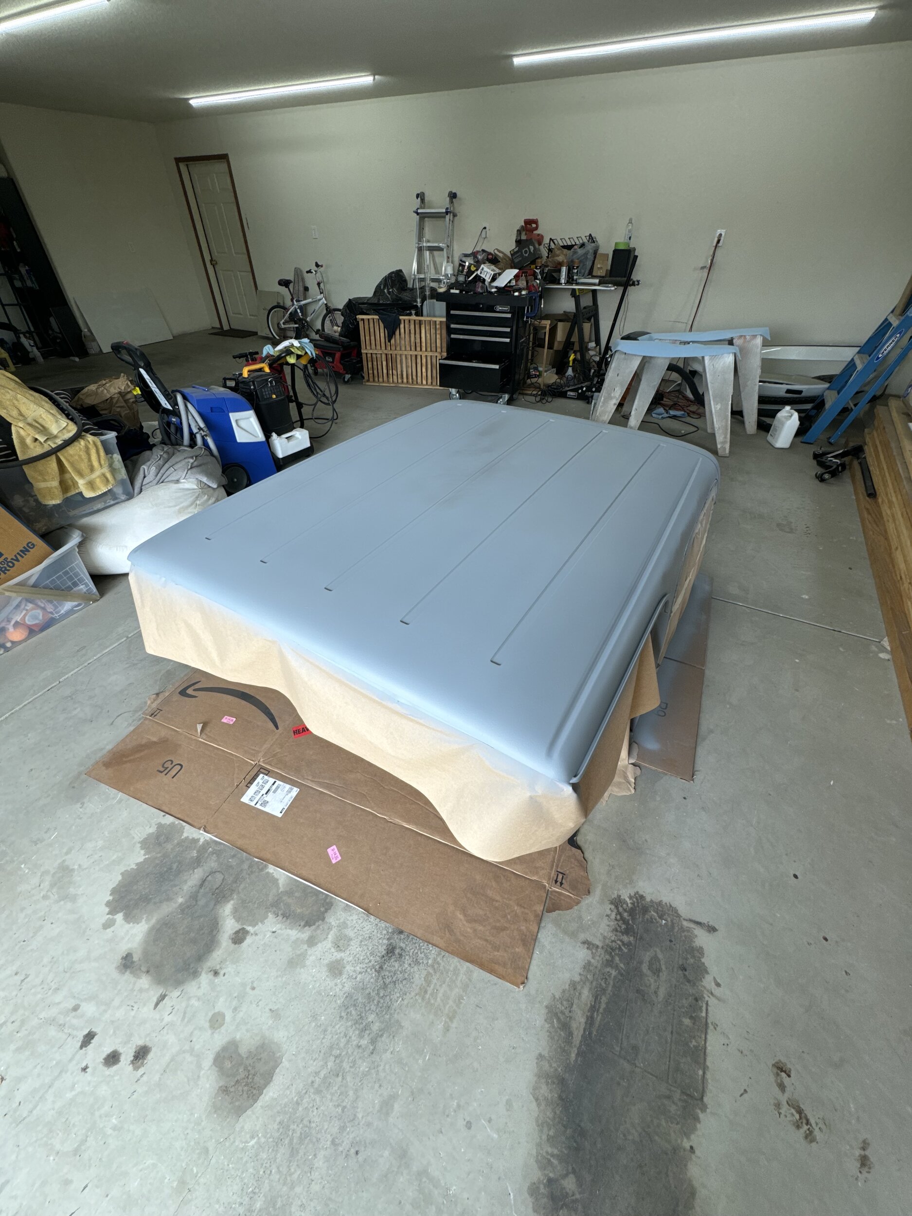

After getting the top interior done and letting it completely cure, I started on doing the top exterior. However, I was a little apprehensive to use the SEM paint on the exterior because it doesn't offer any sort of UV protection. Living here in the SoCal desert means with no UV protection I'd be probably having to re-do this thing in a couple years and that's not something I was interested in doing. I took a trip to a local paint place to get an opinion on what would be best, plus at this point I had almost ran out of SEM paint anyways lol. After talking to the guys at the paint store, they confirmed my suspicion about the SEM on the exterior and we started discussing options. Since I don't have a paint gun (yet) I pretty much was stuck using spray cans. We took the SEM paint and they color matched me some paint that they loaded in spray paint cans. They also mixed in an adhesion promoter and made it single stage so I was able to get an activated can that would do everything I'd need in one step! Well, not quite one step but close enough. I did decide to use a primer on the exterior of the top because it was previously black and I was worried about the color being too far off between the white base interior and the black base exterior. I picked up a couple cans of a gray primer to coat the top prior to doing the color coat. I did almost the same prep work on the top exterior as I did the interior except this time through I used a ScotchBrite pad to rough up the exterior in prep for the primer.

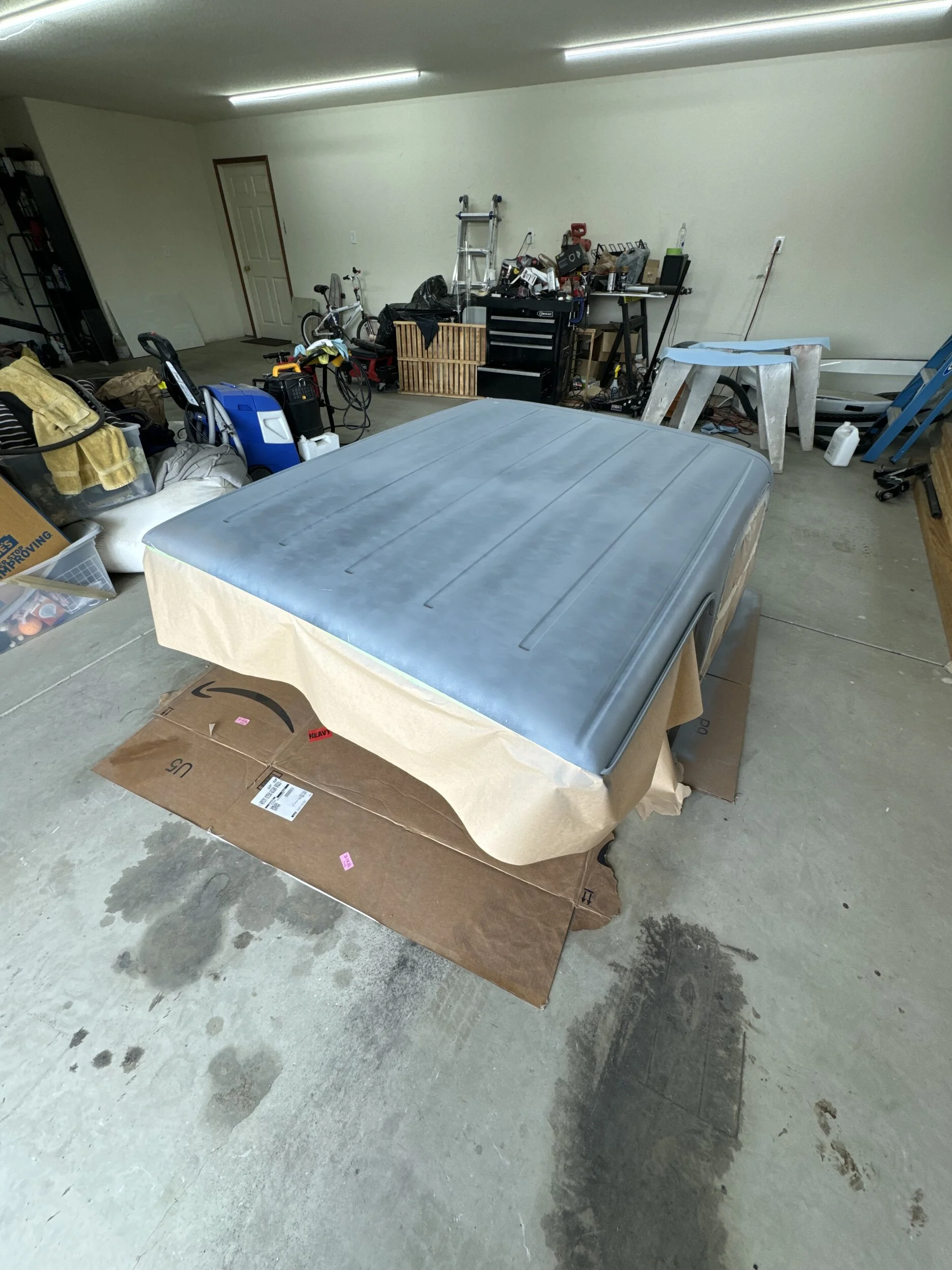

First coat of primer on! I went at this light so I could make sure it got a good grab on everything with no runs.
Second and final coat of primer on! I did do a light scuff sand and cleaning in-between coats to make sure everything would hold up. I also did another quick scuff sand after the final coat had dried to prep for the color coat.

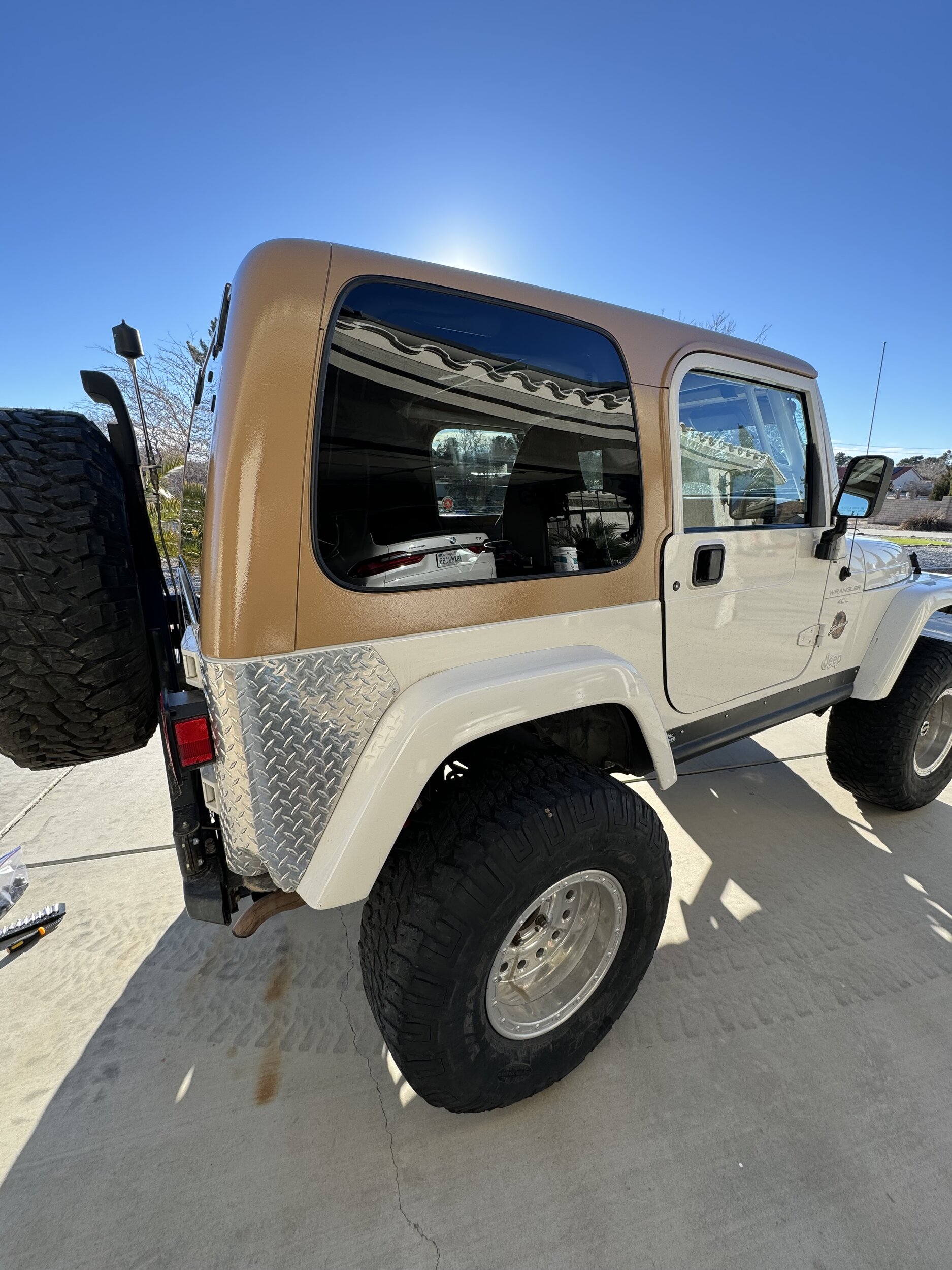

I went about the color coat the same way I did the primer. Light on the first coat, let it flash dry, then back on with the second coat for coverage. No scuff sanding between color coats, this stuff was very sticky to the touch I'm assuming because of the adhesion promoter. The last time I used an activated can of spray paint was back in the Military when I was painting missiles! I had forgotten how sticky that stuff gets lol. After about 95% of the top was painted up, I lifted it off the ground and put it back on the saw horses so I could get a closer look at the lower edges to make sure I had good coverage and to avoid any weird "feathering".
Now it was time to let it dry up, and come back for a close up inspection of the entire top inside and out to make sure there weren't any light spots or areas that I missed. After doing touchups I decided to let the top sit for a full 24 hours to allow the paint to harden up. Fortunately, the weather was complete trash for the next 3 days so the top got to sit for about 4 days in my garage before it cleared up enough to be put on.

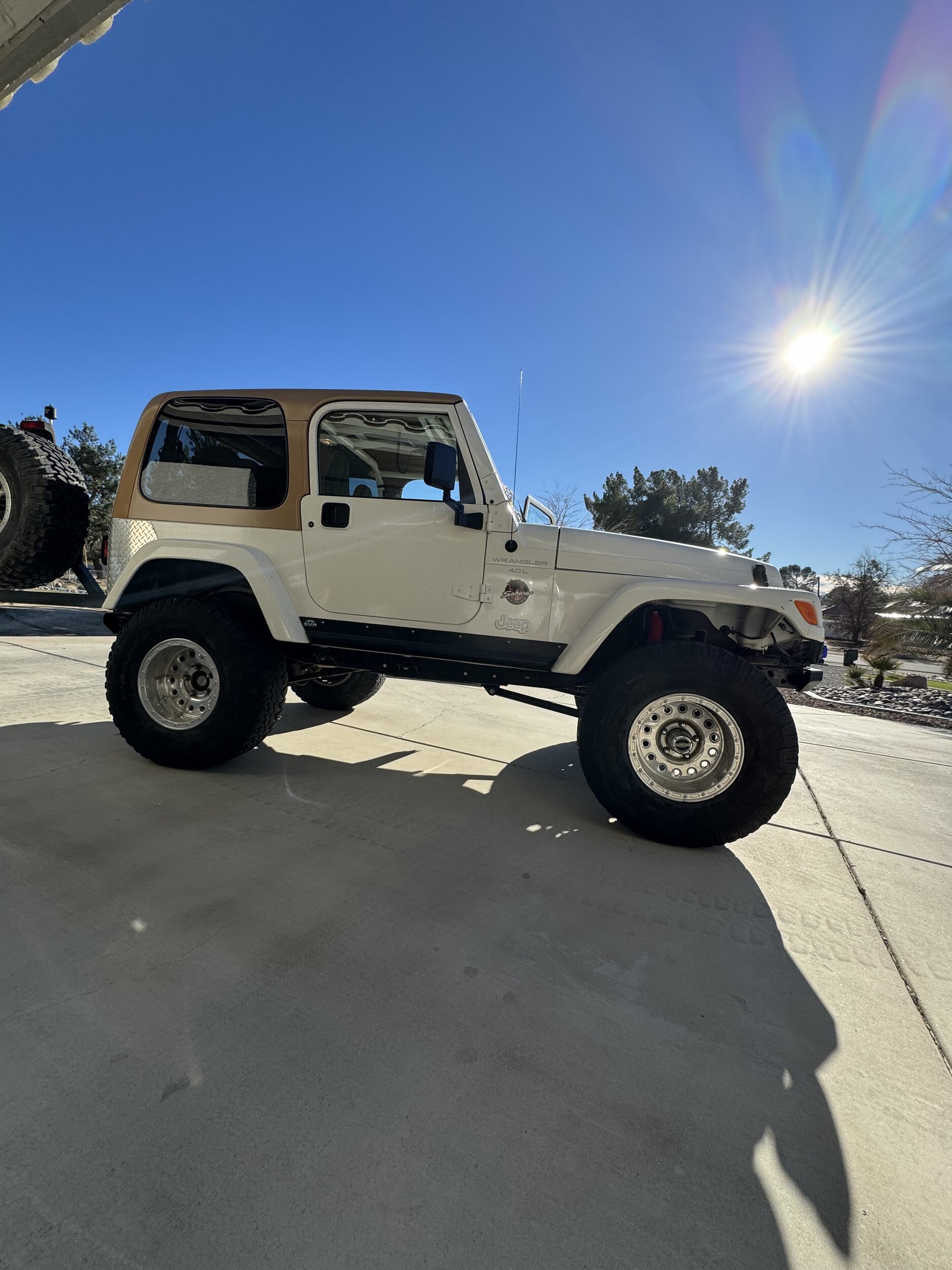

And some bonus photos of the cage out and all of the soft top mounting hardware removed. I can't wait for the warmer weather and I can take the top completely off and run around with the cage out!
So that was everything all done up! Hopefully you guys enjoyed the write-up and pics! Let me know what you think!

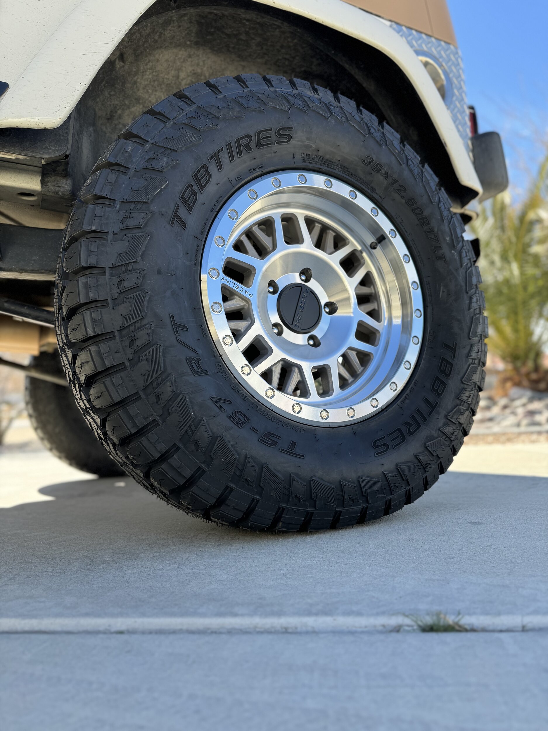

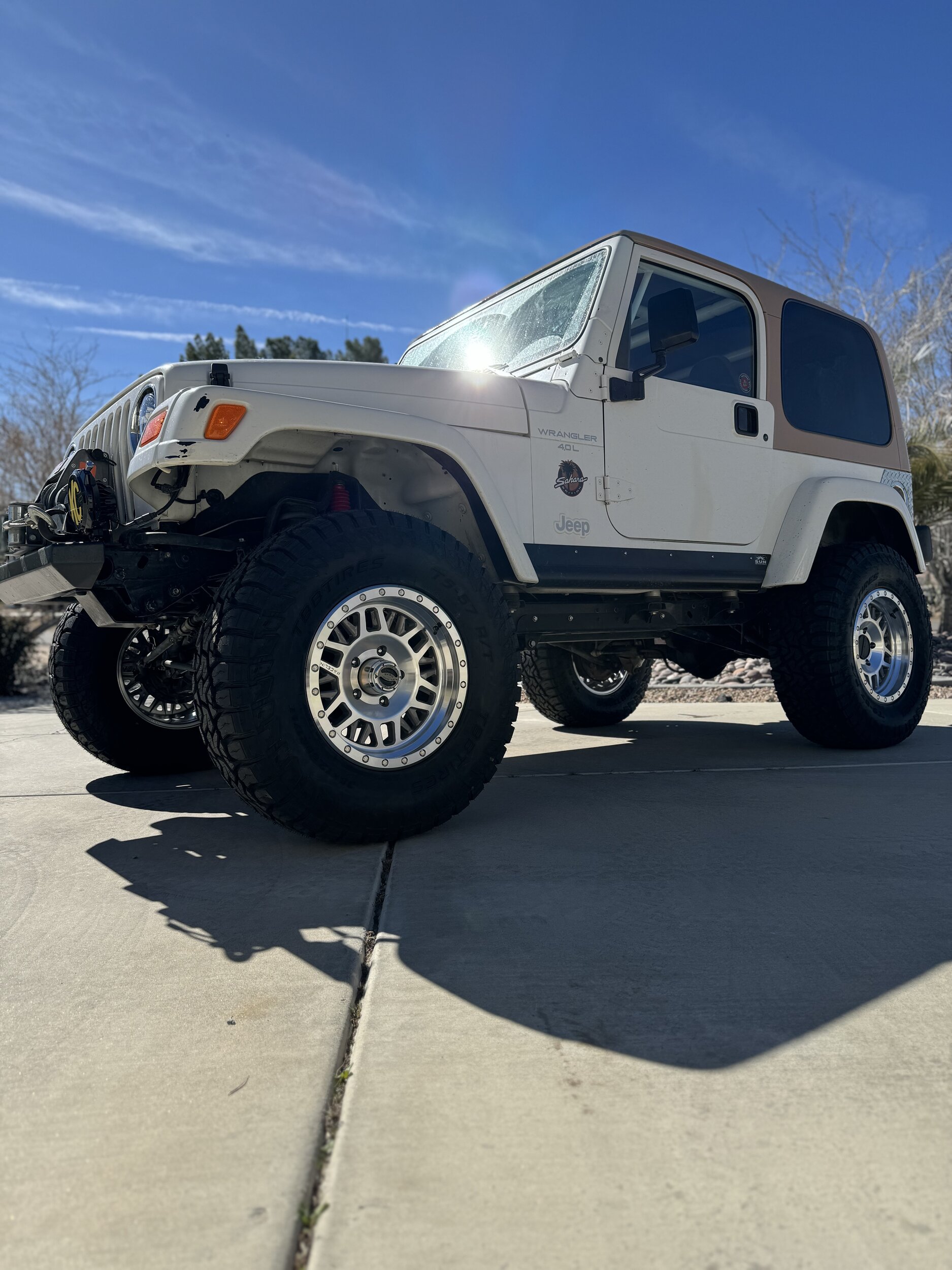

Well I’m back yet again! So I was having a bit of a dilemma on what to do about the new tires situation. As you guys know, I had the 16x10 RockCrushers on the Jeep and finding tires for the 16” wheels is quite difficult. So, I began looking locally to see what kind of deal I could find on any tires. Basically the cheapest set of 5 I could get was around the ~$1,500 mark and that seemed a bit much to me. So I had to decide if I wanted to take the money I would have to invest into the tires for the 16” wheel and just roll that towards a new set of wheels and tires or just pony up and get the tires.
After some deliberation, I decided to just go ahead and pull the trigger on a new set of 17” wheels and go that route. So my search started yet again and I landed on a set of RaceLine Ryno 951MC wheels and I got a really good deal on a set of tires to go with them. So here’s the result! Let me know what you guys think!
