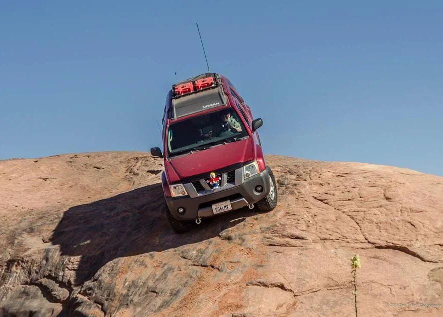

Fins and Things in my "other" 4x4, taken on a month long overlanding trip in 2015:
I will guarantee that I was in 4WD low range. ;)
