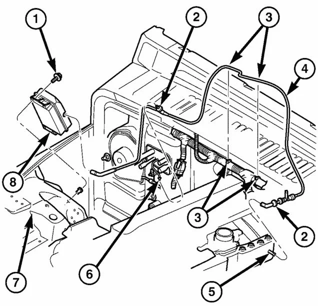

Both, here's a diagram of most of them. It's missing the larger diameter rubber vacuum hose going to the power brake booster.
The box #8 is the vacuum reservoir to store a little vacuum for when the engine isn't running.
The vacuum hoses connect to a couple locations on the intake manifold since that's where all the vacuum is generated.
