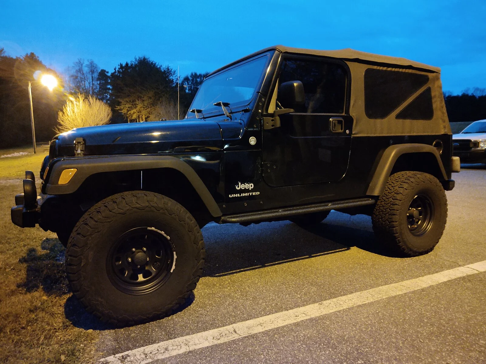

Hey all, just joined the forum after lurking for a long time. I thought it'd be fun to document my LJ build.

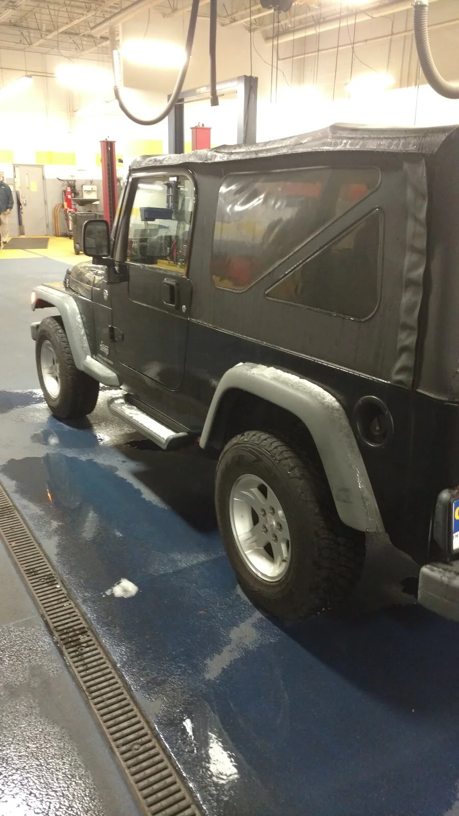

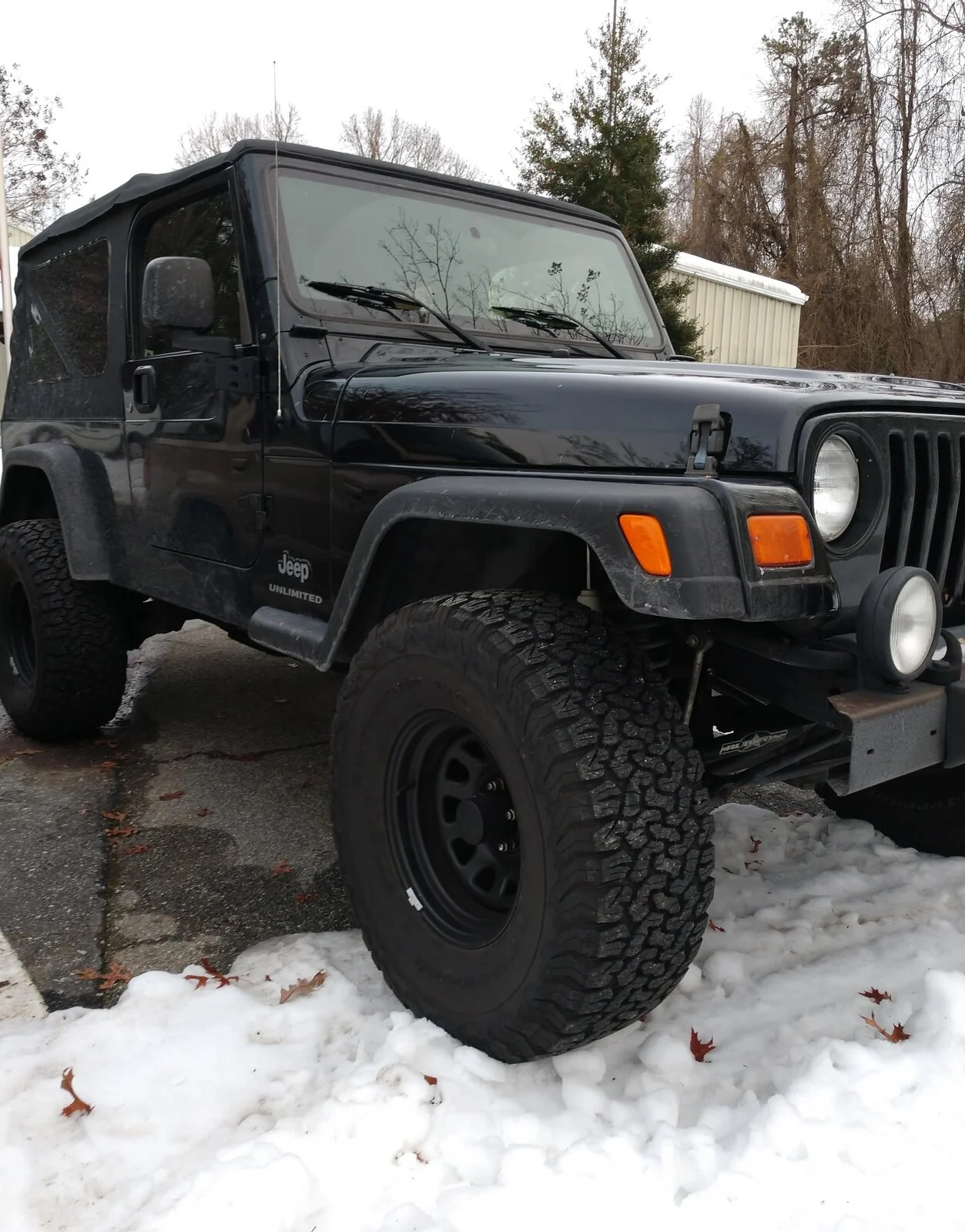

I found the Jeep online at CarMax several years ago for $16k and 92,000 miles. I thought that was a steal for an LJ especially at CarMax. Had it shipped to the local dealer and put my 02 TJ that was having some frame rust issues up for sale soon after.

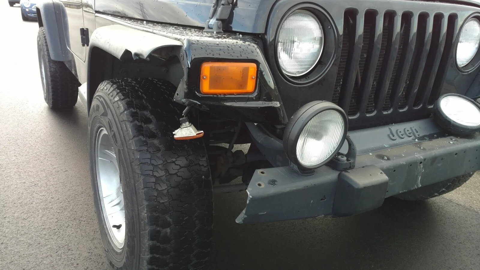

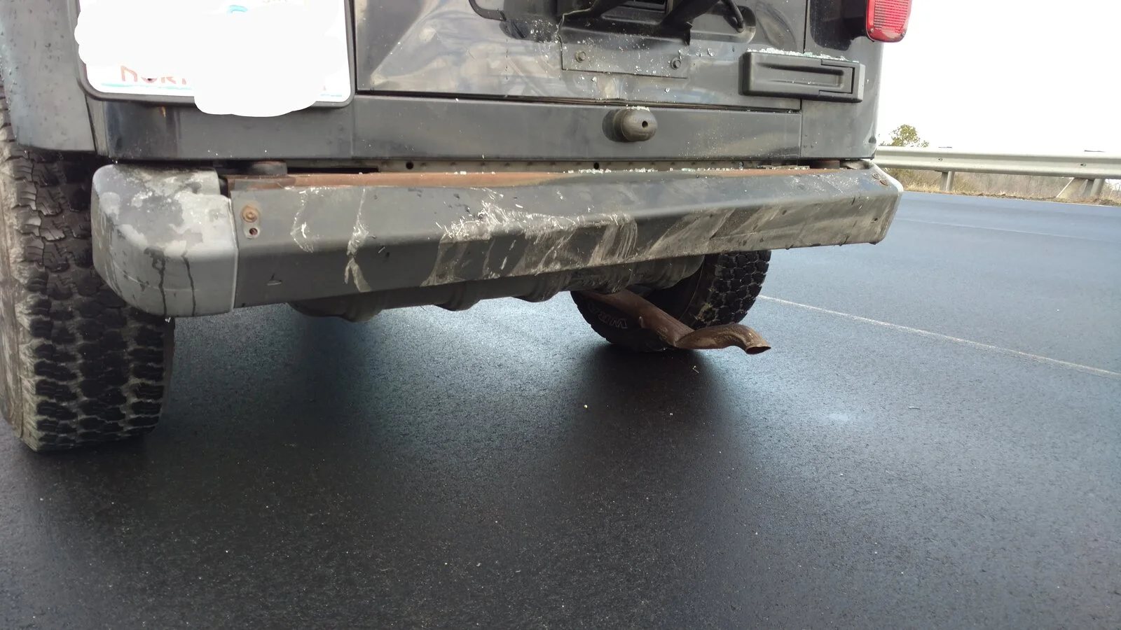

About a month after I got it I slipped on some black ice over a bridge and ended up on the shoulder, damage wasn't bad at all until someone slid up from behind and slammed the rear (everyone was ok). Long story short it was almost totaled but they were able to save it and since then I've been slowly building it to how I envision it.
My end goal is to keep it clean and pretty simple, current mods are listed in my profile but I plan to upgrade to better parts over time (Currie suspension, hopefully a 44 front axle, regear, etc...) But I'm also keeping an open mind and I'm excited to see how things go/might change. Here are some pictures from before I bought it and then the wreck:

Here's my Max Bilt console, planning on taking it out to get powder coated in the near future. It was in my last tj as well so it's seen some use.
Recently put a Dorman diff cover on the rear as well with new hardware as it was very rusty. Sometimes it's the little things like this that can make a big difference in appearance (going to paint over the white logo soon).

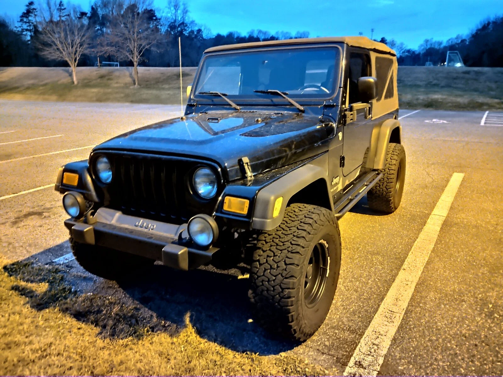

Some other cheap mods I've done recently.. front stock bumper chop and repaint, and I made some plates to cover where the flare extensions go out of 16 ga steel

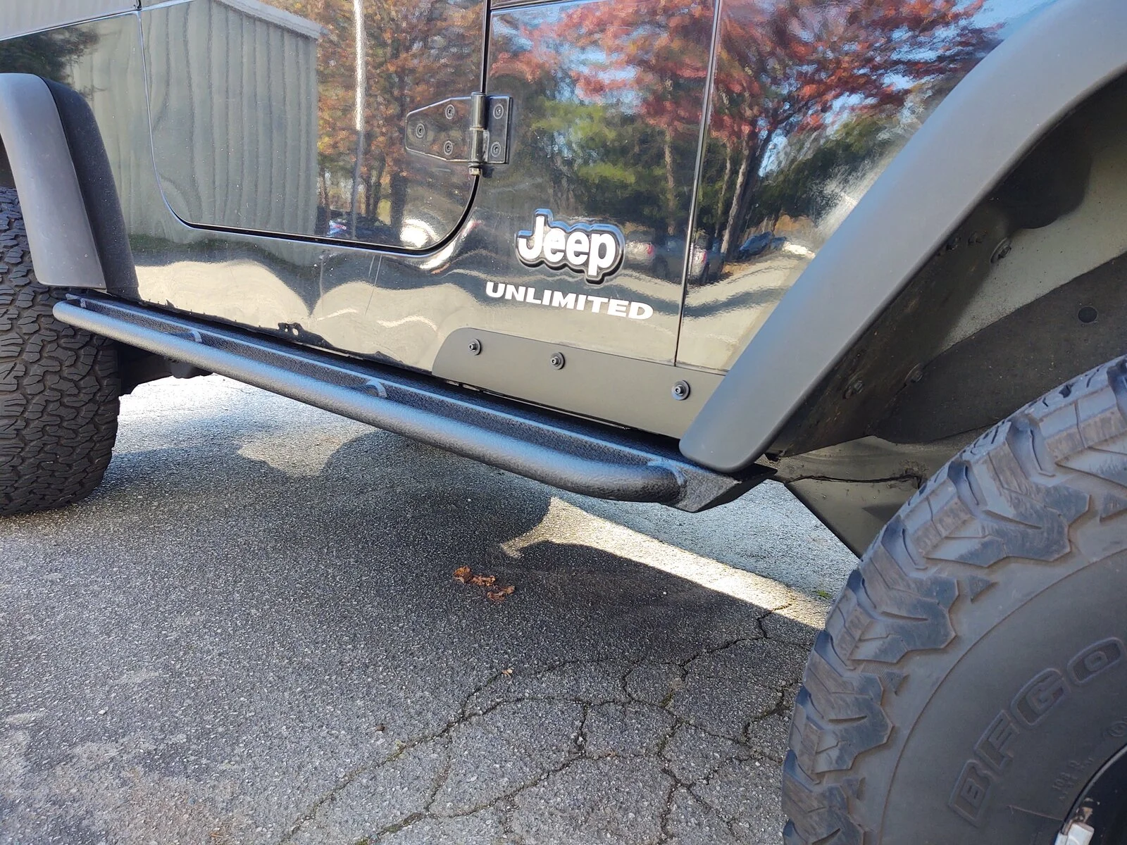

Just added the Body Armor rock sliders last week as well
