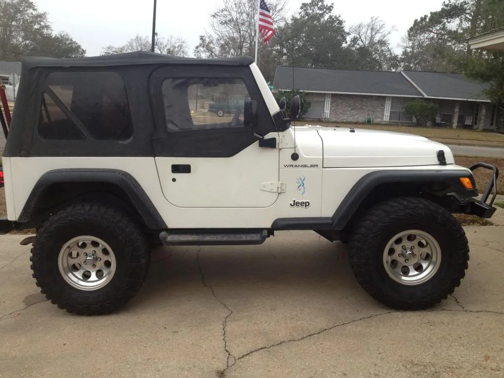

I got my TJ in November of 2008. A 1998, Stone White, SE with 55,000 miles on it. No back seat, no center console, and no carpet. But it had 31" tires and a radio, so I was a happy camper. It originally came with a white soft top, which I'm told that less than 200 were made with my configuration in '98 making it a pretty unique jeep. Unfortunately, the top was dry rot and had to be replaced shortly after I bought the jeep. I also wasn't big on taking pictures when I first got it and only have some pictures in my driveway after replacing the top and taking it offroad for the first time.
I will later learn that mud not only gets on the outside, but in every crevice waiting for the moment it can fall into your eyes as you're working on it. Not that it stopped me from enjoying my jeep, I just made sure to avoid the real nasty stuff, because I also wanted my jeep to last me for a long time.

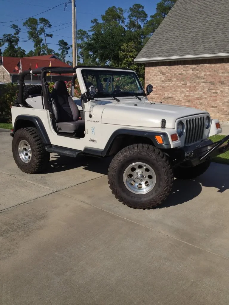

After a few years of enjoying my jeep, the mod bug bit me and I started to get a plan together for a lift. I decided on a 2.5" OME lift and some other bells and whistles like new bumpers and such.

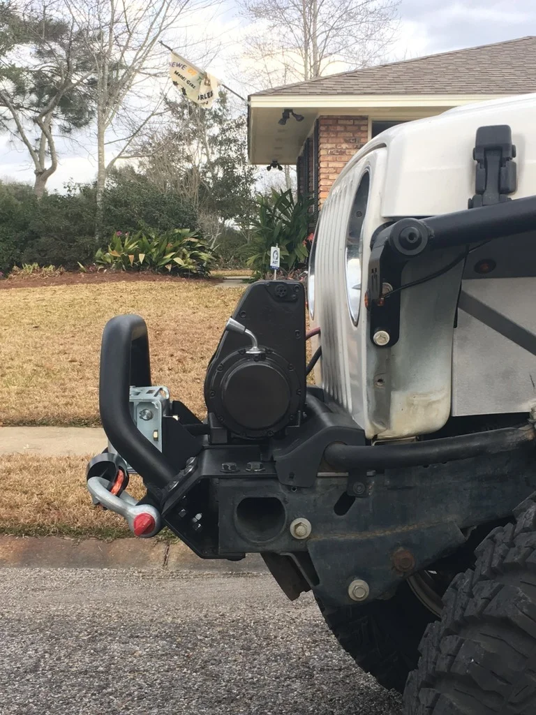

I decided I wanted to ditch my front bumper because it stuck out way too far from the frame for my liking (shameless plug: I still have it and will sell it for a smoking deal). I wanted a lightweight bumper that sucked in tight to the frame. After looking at my options, the Metalcloak aluminum bumper fit my needs perfectly. Man is that thing light! Best part is, it acts as the winch plate which equals even more weight savings up front. I found a Warn xd9000i on craigslist for $300 and replaced the steel cable with some synthetic line from 4LowParts both for peace of mind and weight savings. It came with the TRE safety thimble which I highly recommend. It's a stupid simple design that @mrblaine had a hand in designing. It's intention is to maximize safety and strength, and it does just that.
Winch before I cleaned it up (can't complain considering what I paid for it):
New coat of paint and installed on the bumper with new line:
As you can see, the MC bumper really hugs the frame:
I still need to slap the stickers on it. Shoutout to Warn customer service for shipping a full set of replacement decals free of charge.
Also, a good idea for anyone buying the MC bumper with a stock sway bar - keep the plastic cover that goes over the sway bar and mounts so they remain covered up. I had to hack mine up pretty good to fit behind the winch, but definitely worth it aesthetically to keep the mounts hidden. I also hit it with some flat black spray paint while it was off of the jeep so it wouldn't contrast poorly with the bumper.

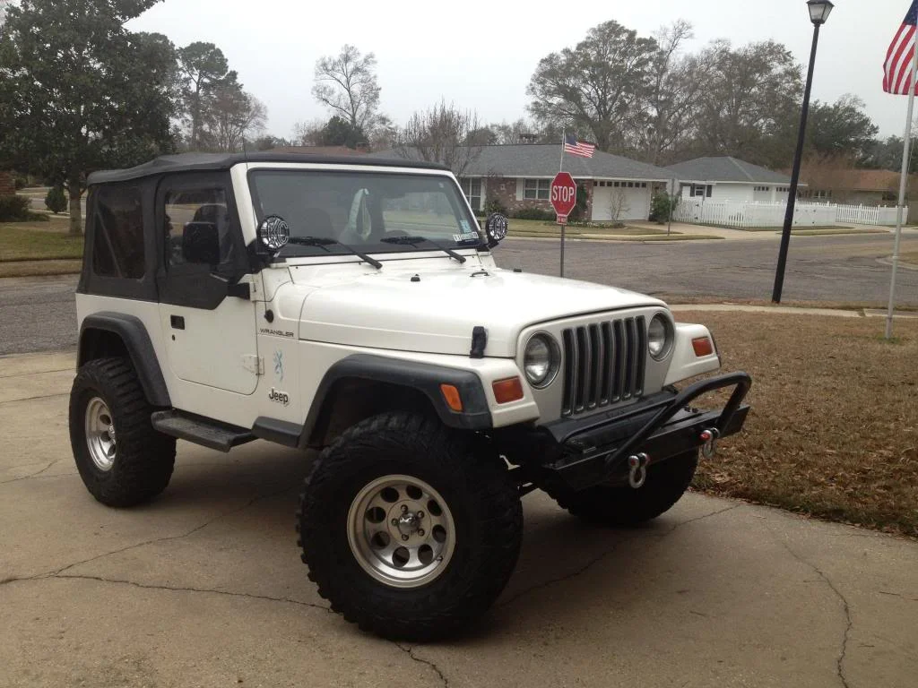

During this time, I also installed some MC arched fenders. I have been impressed with them so far. One day, I might switch to true highlined fenders purely out of boredom, but definitely not anytime soon.
During the install:
After:

With only 2.5" of lift and 33" MTR's, I was robbing myself of wheel travel. My shocks had more up travel in them, but I had to bumpstop the suspension to prevent damaging my stock fenders and new tires. The MC fenders give me the extra clearance I need to use the full capabilities of my lift.
I appreciate the compliment as well. I like to think it's the little things that make them more tolerable like keeping the little extra fender flare extension in front of the side step and also having a front bumper that follows the narrow line they give to the front end. Like I said above, I try my best to always put function over form. But if a part has both function and form, well that's icing on the cake. I know they're not everyone's favorite, and some people feel pretty strongly about that. I went back and forth on getting the arched or "overline" fenders. Probably over thought it. Then one day I happened to see another jeep with arched fenders on the Mississippi Gulf Coast and it sold me on the arched fenders.
