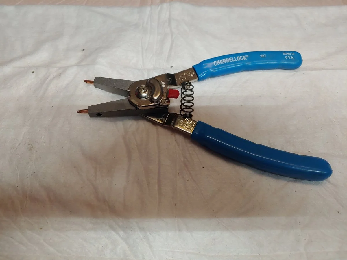

I do have the JJ tools ordered (2” and 2.5”). As of now I have rigged together temporary to remove the one ring. I have been hesitant to get the “channelock” brand pliers because of what happened to the other ones similar I have used. Different brand but same design, they twisted out. I may go ahead and get those and try them. I saw them at Lowe’s today.

Regarding Channelock and similar design, I used these red ones from Autozone for all of 10 minutes before I threw them across the garage in complete disgust as they kept losing grip of the snap ring. I then bought the Channelocks from Lowe's and didn't lose grip on a single snap ring. Seemingly same design but much higher quality of material and tool assembly with the Channelock.

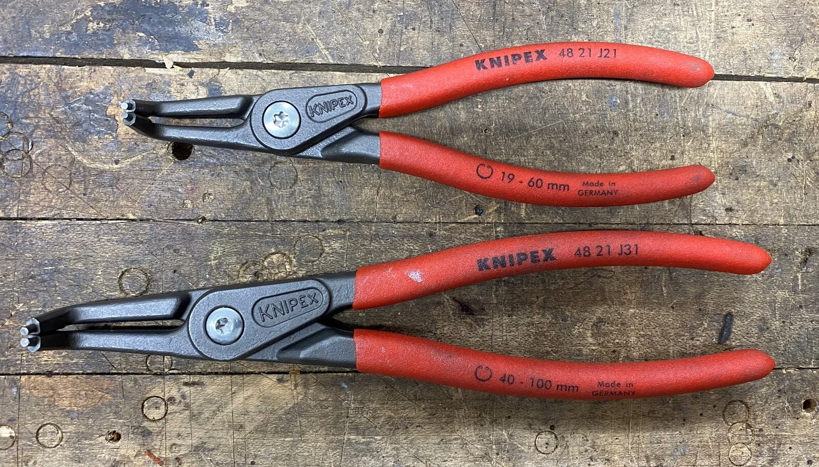

I know I've seen it in a recent thread and now can't find it, but I'm looking for the correct knipex pliers to use on the 2" johnny joints for the UCAs. The pliers I have are straight, and the nibs on the end are too big to fit into the holes at any angle but perfectly straight on, which I can't get on the axle end joints because the springs are in the way. So I'd prefer something 90 degree and small enough to work for UCAs, but would be nice if still robust enough for the LCAs as well.
I know for sure I used the bottom pair (48 21 J31) for the lower control arms. I'm pretty sure I used the top pair (48 21 J21) for the upper control arms. I tried to see if I could get them in the snap rings just now, but there wasn't room. The pins look to be the same size as the snap ring hole.
Thanks for checking! So neither one would fit?
Thats what I found with my pair. I know I've taken apart the other joints with the same pliers, but they were all on my kitchen table and I remember the pins just barely grabbed. I couldn't get anything on them at all today under the rig....of course the rings face out toward the springs instead of in toward each other where I'd have all the room in the world.
Reactions: MountaineerTom
I couldn’t get the pliers on the snap rings with the control arms on the Jeep. The sides of the control arm mounts were in the way. I could almost angle it in there on one of them but just didn’t have the clearance to get them in.
Reactions: freedom_in_4low
