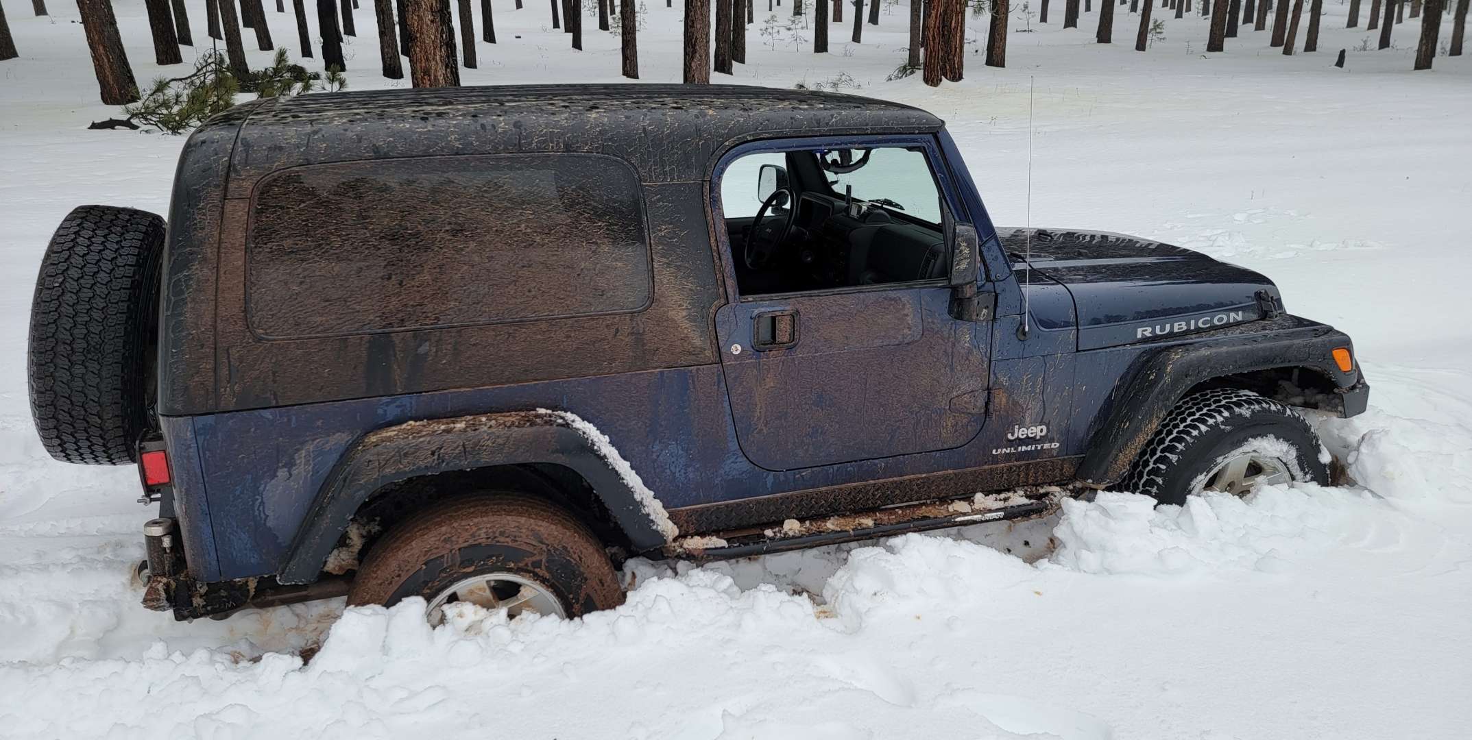

On a winter trail ride last year, we had many people who were new to deep snow-wheeling joining us. We were wheeling in the mountains in 2-3-5 feet or more of snow. It was not a ride to the mall. On this trip, we were climbing steep hills, and those still at 10, 15, or 20 pounds (or even more) could barely move and were often stuck. Those who aired down correctly for the snow could move pretty freely. Once we showed the others how to do this, they ALL did much better.
Most often, a significant challenge is getting people to lower their tire pressure enough to gain the needed traction and floatation.
Cutting through snow may be acceptable when in a foot of snow, but several feet of snow and you sinking into the snow becomes a real problem. This technique is excellent for “packable” (think: good snowball-type) snow, as it may allow you to "float", or at least not sink as much. It is not as effective, though still far better than full air pressure, in powder snow.

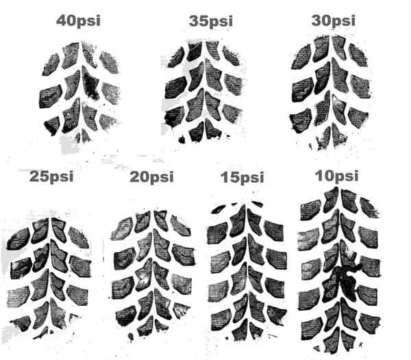

It’s nothing magic. As the simple illustration shows, the contact patch of tread on the ground can potentially increase by 70% or more just when dropping from 40 to 15 pounds. You can imagine how much more it changes when you drop even lower. How much you lower pressures may change with snow conditions.

Yes, the graphic only goes down to 10 psi (because that is what I have available), but if you have not gotten the general idea of how airing down affects the tire's footprint yet, you might just want to stay on the pavement.
GRAPHIC BY PAUL SI — Thanks Paul.
