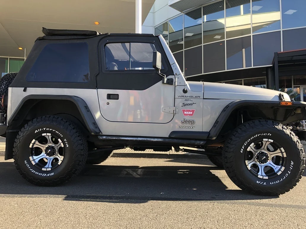

I just had a Golen 4.6 installed a few weeks back and I'm glad I went down that road for a few reasons, If there's anything I've learnt about customising the TJ over the last two decades it's KISS! (Keep It Simple Stupid). Particularly as my TJ is not only a daily driver but my only mode of transport other then my four little fury legs 🐾 but it was more about what I didn't want than anything else:
  • I didn't want what is already poor eco to become completely inappropriate as a daily driver.
  • I didn't want to have legal issues updating my engine number with registration papers.
  • I didn't want an engine that was going to prematurely break what's behind it.
  • I didn't need or want tire shredding power because I love the skinny pedal and I'm too young to die.
  • I didn't have room in my hole to do it myself so the swap needed to be as simple and inexpensive as possible.
As if the TJ wasn't already a hoot, It's a lot more fun to drive now and I can rest assured I'm not going to have reliability issues - I mean that's the main reasons I've bought two brand new TJ's in the first place - because when I'm 200k's or more from the nearest telegraph poll...

I was a little disappointed as first and felt the power upgrade should be more noticable but it's early days at this point and each time I drive it it seems to get better. Today I reset the ECU and now I can really feel it. If I floor it in second around a corner I start losing traction, chirping tires and even a little push back into the seat, so that's nice! :giggle: And before you ask 3" lift, 33x10's, 4.56, NV3550.

I've got those Hurricane fender flares as well. Going to be painting them this summer. They haven't aged well in the sun. Heat treating didn't work for very long. I can't imagine what yours are doing in the hot Aussie summer heat.
Not too bad after about 3-4 years but I have a small garage next to my Wombat hole so perhaps that's why.
I was thinking about painting mine too but once I do that their going to get scratched up the moment I hit the bush so I've resisted the temptation to paint.
