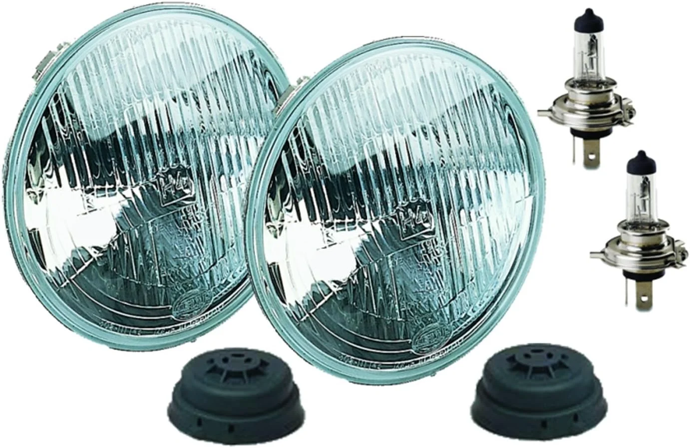

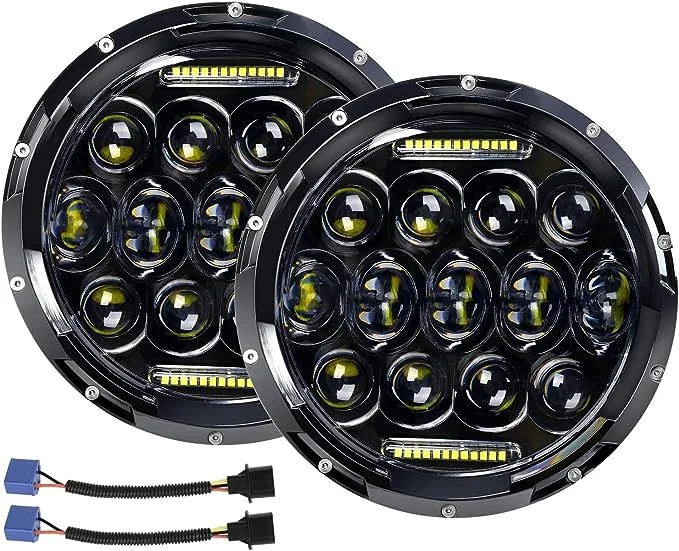

Always possible that the PO took a rock into one so It miss matched. you looking Led? Or? Hella headlights have a great beam pattern nice cut off. Definitely good in the inclement weather but not LED - they have interchangeable bulbs that you can put ridiculous bright bulbs in. My tj came with the leds that look these below…don’t buy these is all I will say lousy pattern and to purple on the light spectrum.

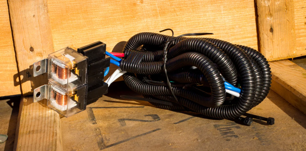

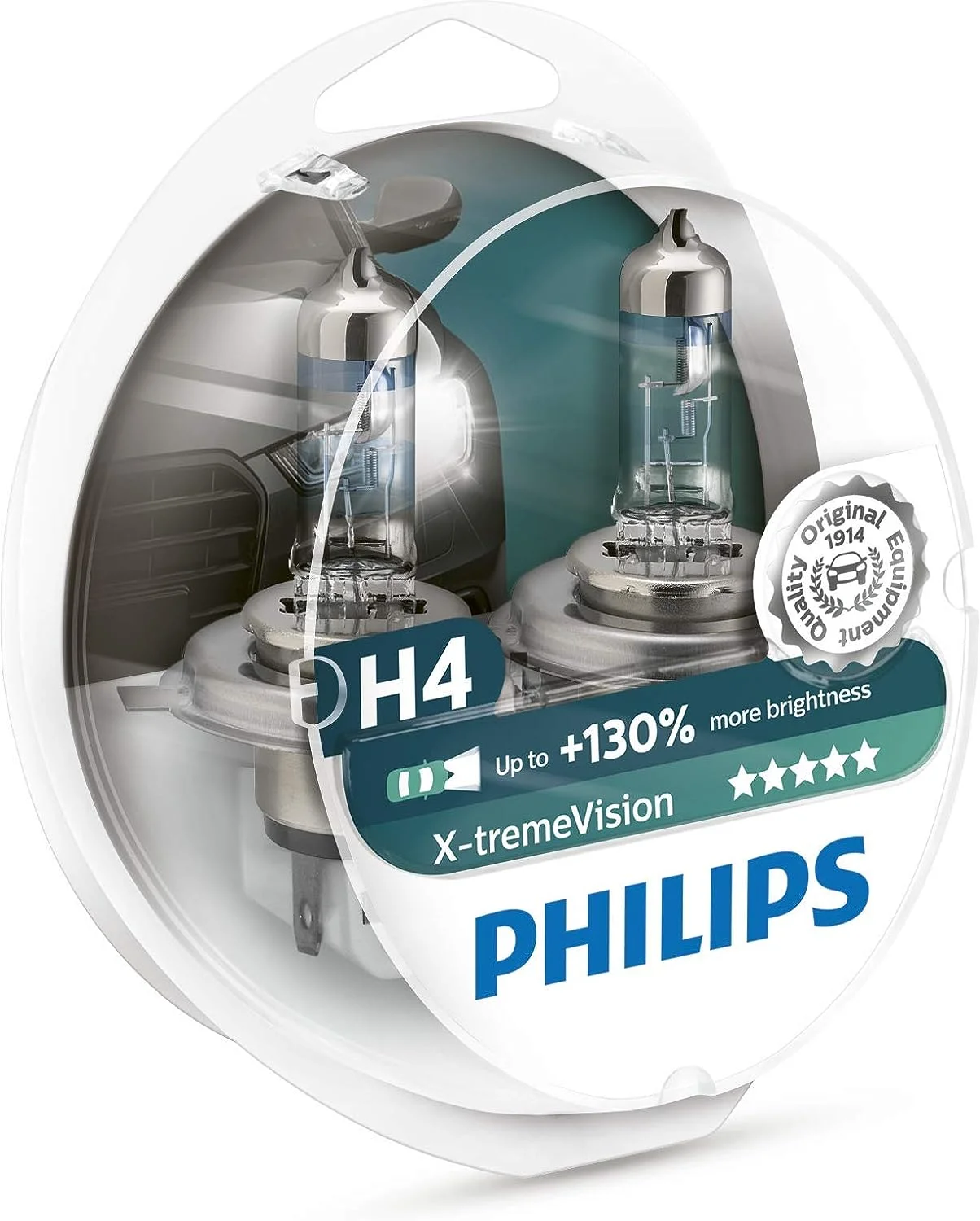

I am a proponent of Hella E-Code housings and Philips Xtreme Vision +130 H4 halogen bulbs. "Whiter" than standard bulbs with no blue cast like LEDs.
An aftermarket wiring harness is not necessary with this combination, but if one wants to get full voltage to the bulbs for the brightest light, the link is below.
https://www.amazon.com/gp/product/B001G72SKQ/?tag=wranglerorg-20
https://www.amazon.com/dp/B00NMEEOV2/?tag=wranglerorg-20
https://www.ksuspensionfab.com/store/p6/H4_Upgraded_Headlight_Harness.html#/
I hate the color temperature of LED headlights - too harsh for the driver's eye and irritating to opposing traffic. Cheap Chinese knockoffs are the worst.
I have run this setup but the harness and pattern with the toyota/koyo kit was much better and also cheaper IMO.

Hella E-Code housings and H4 halogen bulbs
