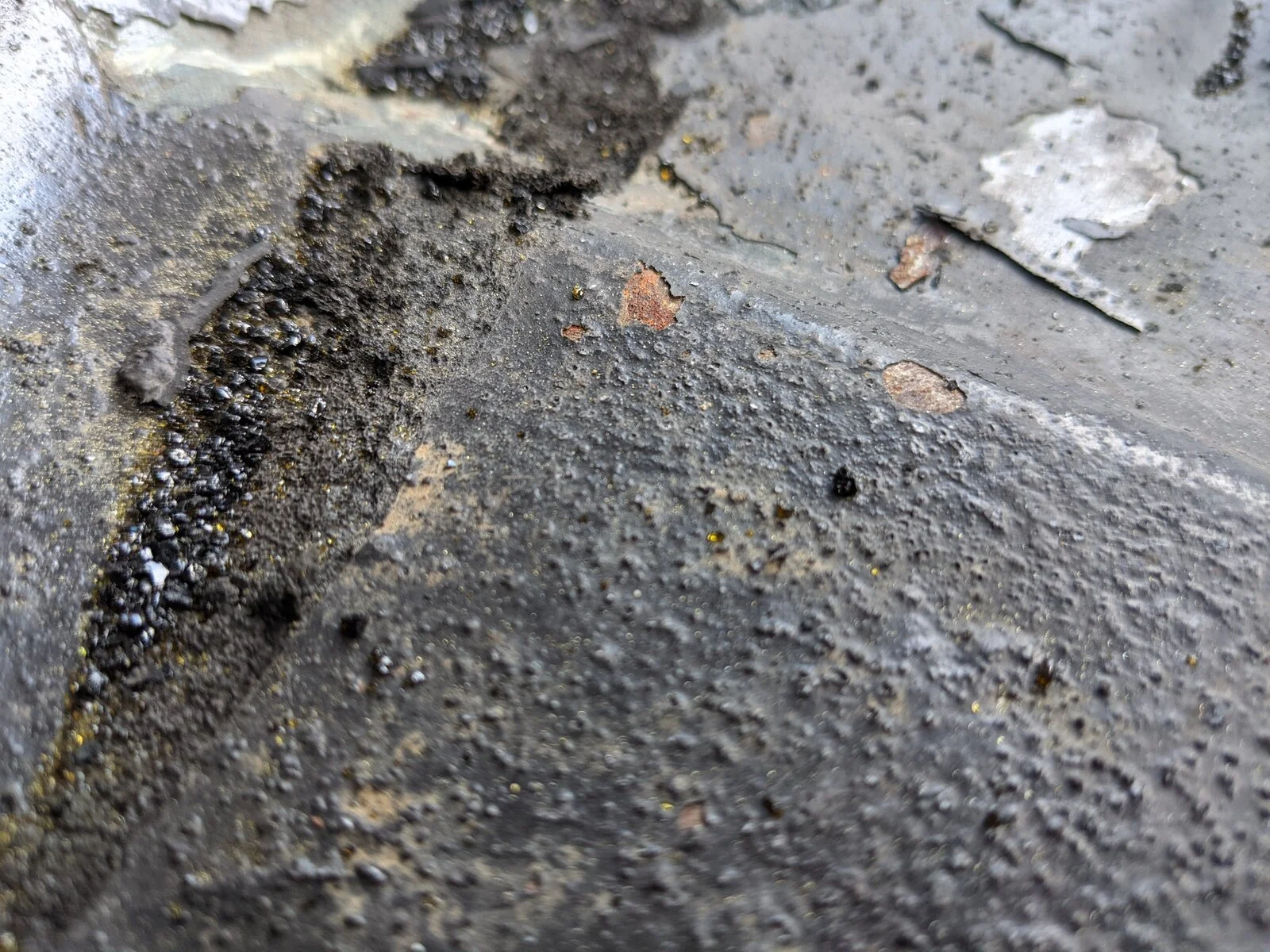

This is a combination of me being away for half a year (so I knew jeep was clean before I left) and noticing tiny orange spots suspiciously spread out, that look just like southern dirt when I lifted the carpet (pic 1). Otherwise I don't think Id have given it much attention.

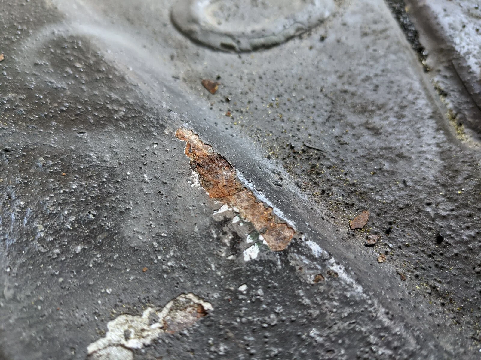

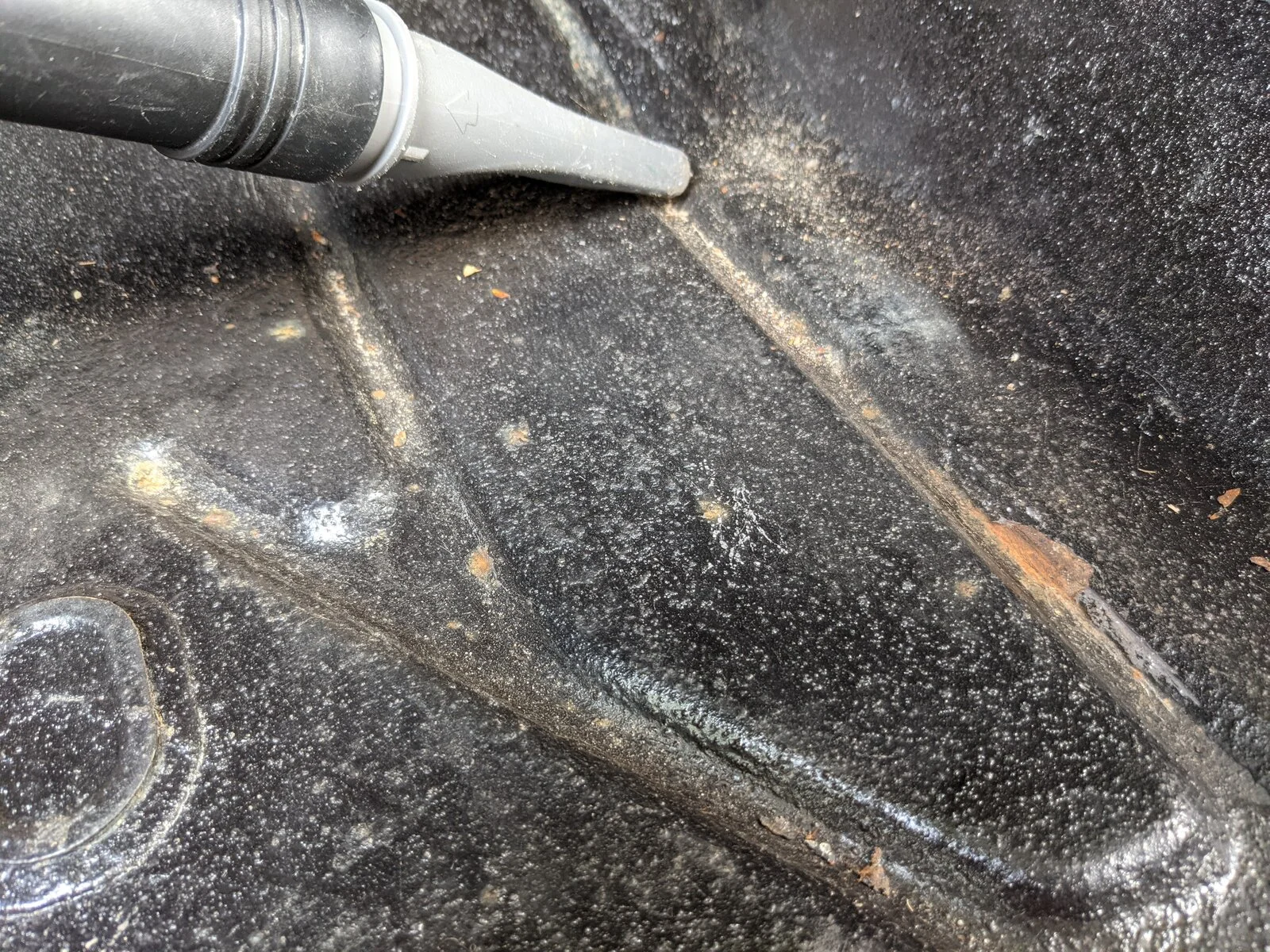

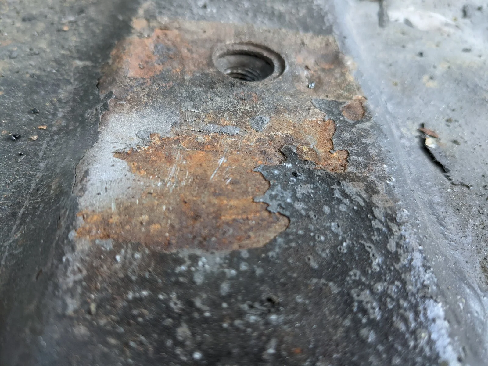

Really bad spots, like in last pic, there was no sign of anything going on there, just a tiny bumps that are no different from rough surface of bedliner to unlooking eye. Only after hitting it with a scraper and hammer, surprise was revealed.
More than likely poor prep caused those issues. I’ve seen it hold up quite well in both the inside of my jeep, and in truck beds. I’ve had my jeep interior done for 4 years now, looks like the day I did it. I had a shop truck that had the bed lined and it looked good after 10 years of being a shop truck. I agree I would never do the exterior body of a vehicle ever!!!

The cause was poor prep and it does look very thin. There are millions of trucks out there and I see very few that are failing like what you are showing. A lot of times they are fully exposed to elements unless they have a camper or a cover.

I don't like bedliner either but I'm living with it because it came with the Jeep. But what you have right there is due to poor prep, inadequate thickness, and the use of garbage rattle can bedliner. 100% predictable results.
The reason your's failed is because it's paper thin. Looks to be either herculiner or rattle can spray on liner, both of which are absolute crap. I scrapped off the herculiner I put in mine 20 years ago and I found some rust underneath because herc is actually full of tiny little pinholes. Look at a professional spray liner such as Line-X, they'll spray that stuff a 1/4" thick. Water is not getting through that.
