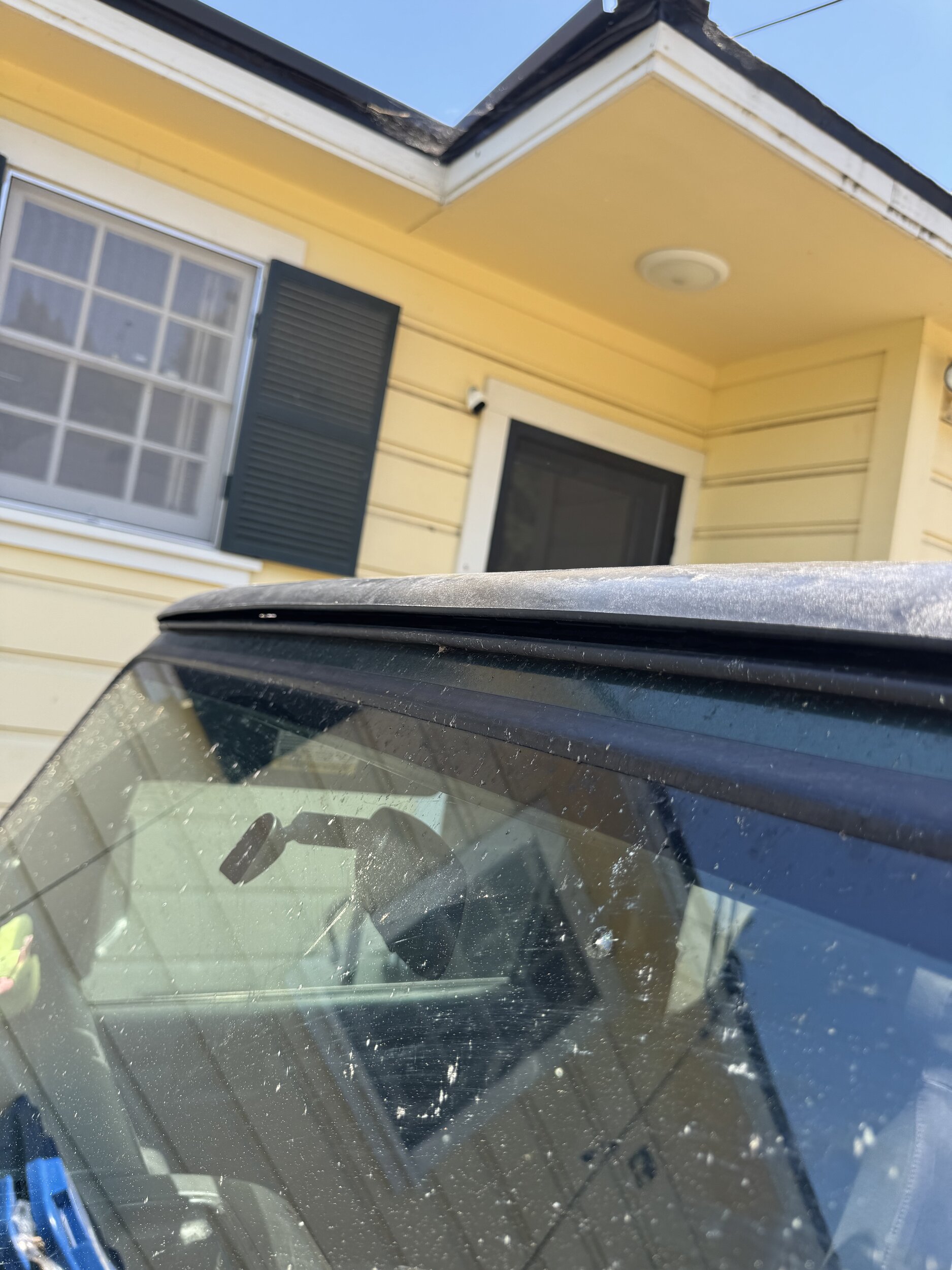

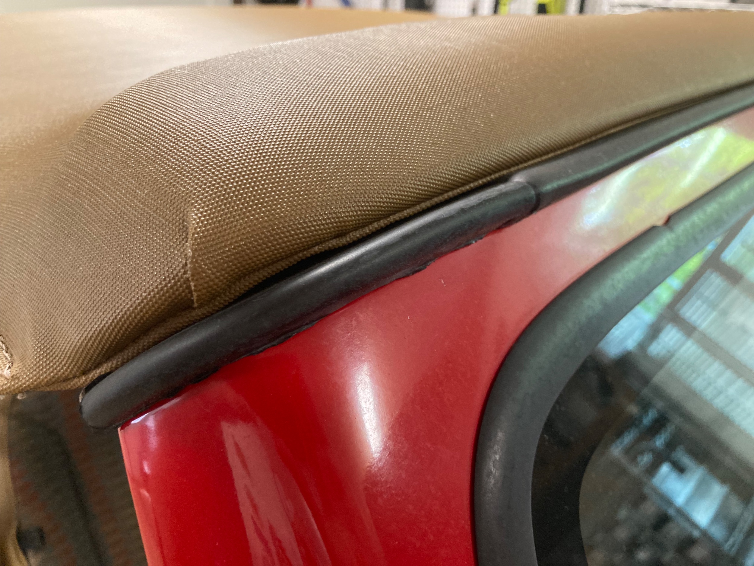

Does your softtop TJ have about a half inch gap between the header and the windshield? I’m trying to figure out if mine is warped or this is just normal. I ask because I’ll get some wind whistling through there on days with a very strong head wind. Otherwise it’s fine. Is my header screwed up? Btw that second picture is with the top removed to check for fit when there’s nothing pulling on the header. It does the same thing with or without the tension of the top.

You seal looks distorted and very thin....
IF you end up purchasing a new seal; I would recommend OEM over purchasing a knock off.
Member have had problems with aftermarket seals not fitting properly and also leaking...
When I purchased my Jeep 5 years ago I had a constant problem of when it rained; I would end up with water inside the Jeep on the passenger floor and there were occasional wind sounds in strong winds.
My header seal was the original and had shrunk and hardened due to the UV and sun...
I replaced mine with a OEM header seal which had been redesigned; with a larger lip over the windshield frame and the rubber material was thicker and felt different.
This seal fit perfectly and the wind and water leaks are gone.....

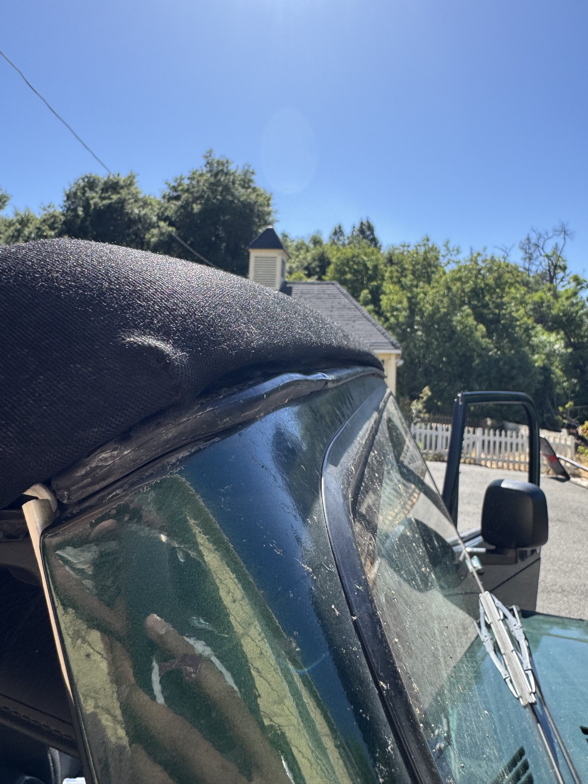

Do you have an original top or an aftermarket top/windshield header? I just installed a Besttop Supertop NX Twill ($1,700) on my son's '03, and the Bestop frame and components are crap. I purchased a used OEM windshield header off ebay ($159) and swapped out the Bestop header. No more gap.

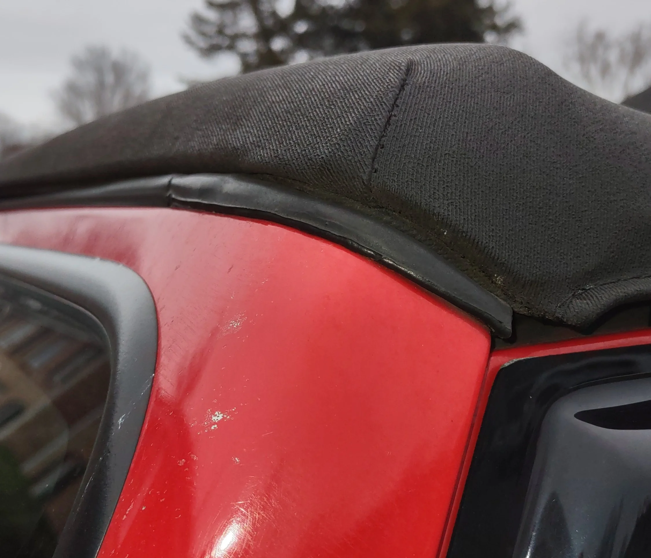

Replaced the bestop one with one I found on Ebay from an 01 TJ. Definitely fits a lot better. Think it’s quieter too. I still have a little gap in some places so I’ll look into finding a Mopar seal, or if anyone has a link please let me know! I replaced mine a couple years ago with a Fairchild seal but honestly, I don’t think it has ever fit well.
OEM Mopar windshield header seal (55395101AC) available on Ebay sold by a Jeep dealership in Garland, TX.
This one is the newer design seal that I used when I replaced mine 2 years ago and had excellent results.

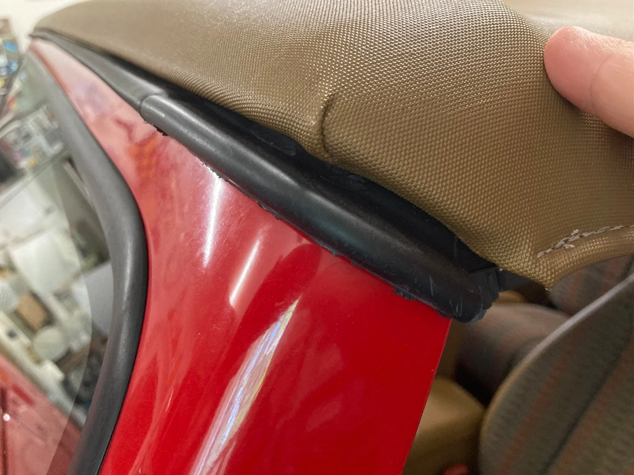

Okay, so I received the OEM seal and installed it today. The mopar/oem seal is built so much better than the Fairchild one. The rubber is thicker, and it just feels much higher quality in general. I don't know why, but even the "new" old header I bought does not sit completely flush with this one, almost like my top is too tight or something and pulling it back. It does definitely fit better though and is even. However, I did use a rubber washer as a shim where the header latch hooks in and was able to get the clamps to close tighter and now it sits pretty much flush with the seal. It doesn't compress that ridge that the header sits on though, is it supposed to?
When I installed my new soft top, it was so tight that I had to clamp the front header bar down first. Then I pulled down on the rear corners to hook them in last.
