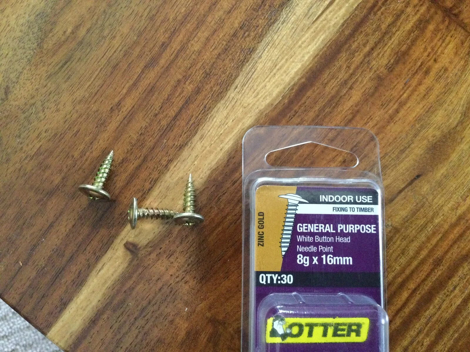

Looking to install my new Bestop RAT this weekend and thinking of replacing all the screws that attaches fabric to the header. Quick question is why two outer screws are different to the rest? Can I use these (1st picture) all across instead or must use (2nd picture) small button head for the most part and pan head for the two outer ones (Just like factory did)?
The only reason to not use the screws you purchased would be where the countersunk screw seat flush instead of resting on top of where it seats.

Thanks Charles,
larger head diameter is the reason why I want to use those golden screws just to get more bite on the surface. However they do have slightly thinner head then the black factory screws as seen in the picture.
So I am getting that I must use countersunk screws on the two outermost locations, all other in the middle are flat bottom from the factory.
