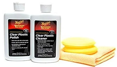

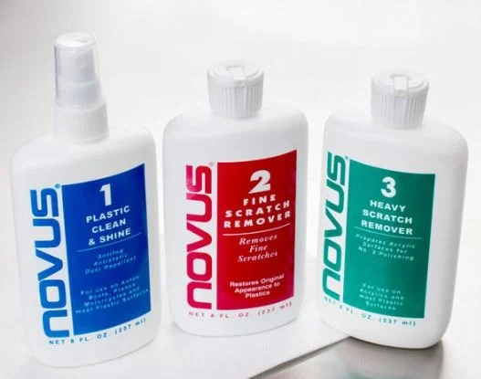

The Plexus stuff is interesting, I have to see if I can find some--my windows are so scratched and dirtied that if the sun hits them just right in the mornings or evenings I literally cannot see a damn thing.
That Plexus product won't remove scratches, it's just a cleaner/final polish. To get scratches out like you described you need either Novus or Meguires plastic window plastic window scratch remover products. They are multi-step products with a coarser polish for scratches and a finer grade or two to do the final polishing. They do a great job so long as the scratches aren't massive or extra deep. I like the Novus 3-part kit which I think does a better job when the scratches are more noticeable. Amazon carries them, it's doubtful you'd find either in an auto parts store.
Keep in mind to never use, or stop using, paper towels on plastic windows. Paper towels are made from pulverized wood products and they impart millions of little fine scratches each time they're used. Those scratches build up until the window turns opaque and yellow.
