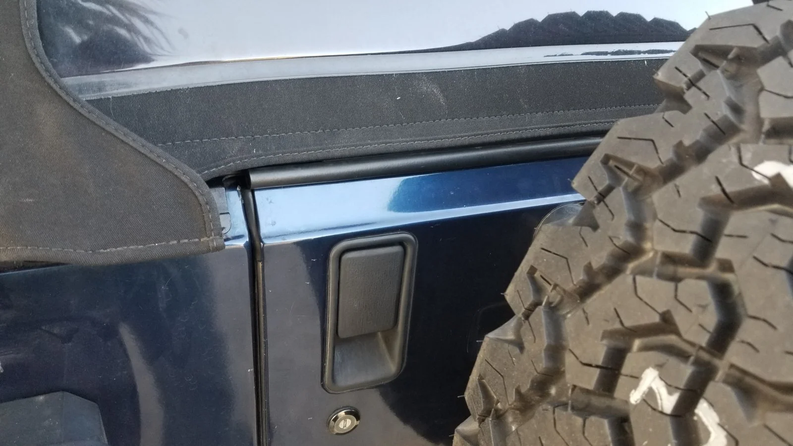

I am having trouble keeping my new (to me) Jeep dry with a bestop Trektop NX. My tailgate leaks, to the tune of a swimming pool in my trunk, floorboard, and front foot well of the passenger and driver side over 30 minutes of rain. I've reached out to Bestop to figure some stuff out, somewhat helpful but haven't yielded any results.
I say this for two reasons:
1. I wouldn't buy the trektop NX unless you are looking for premium features like sunrider and good fabric. If you do, you'll need to figure out how to reliably seal the tailgate. It isn't an isolated issue based on Google. I'll update once I get it figured out.. If I do.
Otherwise, another Bestop that seals the tailgate better would be preferable to keep the rain out (your original goal).
2. Anyone get a once leaking tailgate bar fixed? I've tried everything I've found for this issue except going back to Mopar OEM. It's installed correctly from what I can tell, looks reasonable, just leaks when it rains @ a point at the upper left 3rd of the tailgate, where the tailgate meets the tailgate bar.
It does look good tho! Image is exactly where it leaks.
@Skor2003, it sounds like you have other leaking issues if you have water in the front footwells. Unless your TJ is parked nose down on a hill, and the water is flowing from the tailgate area to the front...

Yup - the worst time was with the nose parked downhill. I think the carpet helps it spread as well. I only care.. Because I care about potential rust
