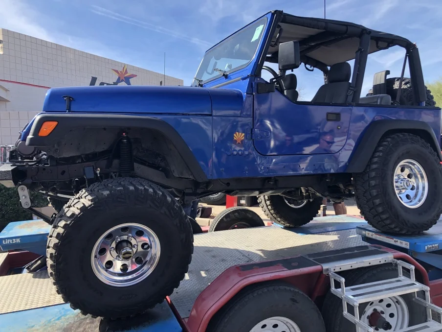

Despite what some internet, especially some YJ "experts" suggest, a track bar is indeed helpful in keeping a leaf-sprung front axle centered. I was blowing out shackle bushings quite often and noticed that the handling, while okay, was not as good as it could have been. After talking to a lot of old CJ and buggy guys, I ended up putting a track bar on mine after the Dana 44 swap.
The difference in handling was simply amazing - to the point where I almost jumped the curb on the first turn I made in the neighborhood (the steering was that much more responsive!). In a dozen or so off-road outings and trips to the lake, I never blew out another shackle bushing.

I used the Dave's Custom Unlimited bar and bracket. Despite what many YJ guys thought, I never lost any travel or had any issues. I even put up a 550 on the CTI ramp... certainly not "Flexzilla", but for off-the-shelf springs I was more than happy.
When the guy I sold it to took it for a test drive (although it was meant for his son), he said the YJ handled better than his newer pickup truck. My track bar was slightly higher than the drag link (I was running crossover steering on GM flattop knuckles). As long as the draglink and panard bar lengths are close and the angles are close, you should not have any noticeable bumpsteer.

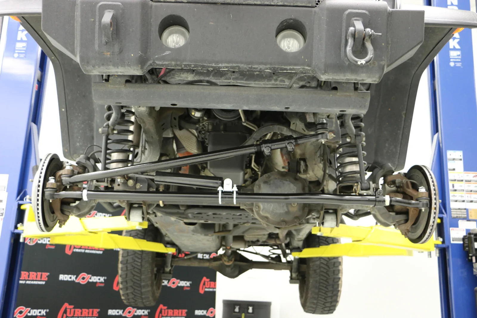

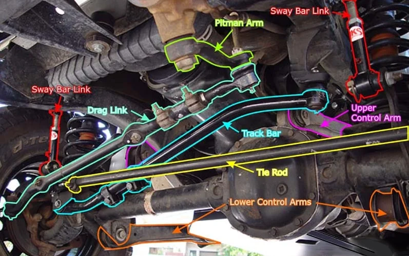

Ok when you said Y link I thought you meant inverted Y...I think you have a recipe for a center dead spot there because the tie rod can roll up and down as the drag link pulls or pushes on it...it has to rotate to the end of what the rod ends will allow before your steering input actually starts moving the knuckle. I would want to address that before designing a track bar into it, because depending on what axle that is you might run a true crossover like a JK or an inverted Y like a TJ.
Note how our drag links run all the way to the passenger knuckle, and the tie rod runs from the drag link to the driver knuckle.
while the later Jeeps also run the drag link all the way to the knuckle, and tie rod runs between knuckles.

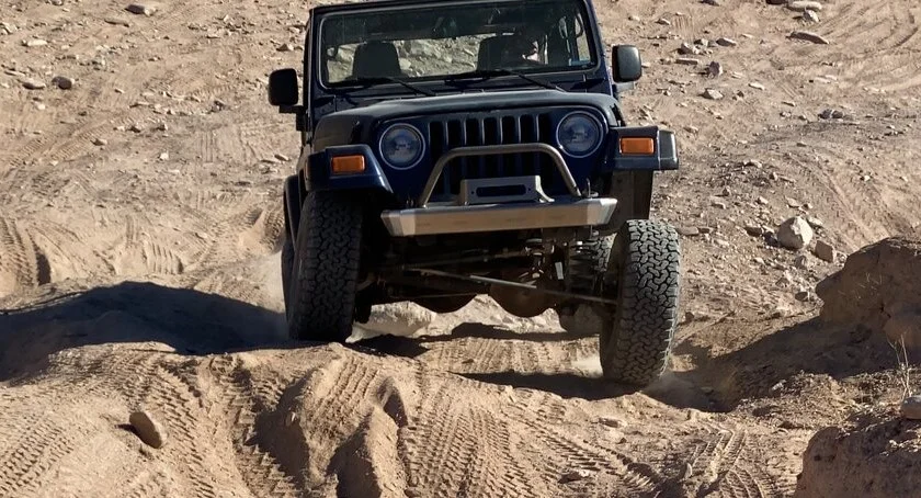

makes perfect sense. I noticed in your photo it looks like the drag link and track bar are perfectly horizontal at ride height.
Reactions: pc1p
They are, and the suspension was just about perfectly centered as well (I think I was using ~9" shocks). For a tractor-motored box-wagon, it worked well off-road.
