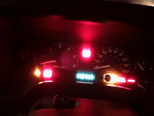

Ok so on Tuesday morning at 5am I started the Jeep and all was good. I pulled away from the house and after about 50 feet the dash lights went out. Then I started to smell something burning. I flipped around and parked and checked it out, did not see anything. I grabbed a fire extinguisher from the house (sorry wife and kids, Jeep is a little more important at the moment) and went to work. The burning smell was gone after a minute or so.
The strange thing is that when I turn the Jeep on some of the dash lights work, I have attached a photo below of what comes on. The only lights that are out are the ones that light up the gauges. I checked the fuses but it only looks like there may be 1 or 2 that deal with the dash and they seem ok. I haven't had time to pull the dash out yet and inspect behind it but will this weekend.

I haven't seen the back of a TJ dash panel yet (at least not what's beneath the white plastic) but I would hazard to guess that there's some blown resistors in there. That happened on my brother's car once at least, I took it out and he knew how to replace the resistors himself.
Only thing you can really do is exploratory surgery, and I would start with checking out that panel. Try also seeing if you can smell the burn in any area, since it just happened you may be able to sniff it out! If you don't see (or smell) anything try swapping one of the lights you know works with one of the ones that is out. Chances are that won't work, it's one thing if one light goes out, it's another when multiple do (unless they're wired in series as opposed to parallel).

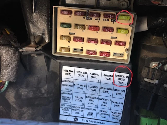

Ok, update. I was wrong....it was a fuse. I attached a photo of the fuse it was. Says "Park LPS Skim". The weird thing is that it's supposed to have a 20A fuse in there and it had a 30A for some reason and the 30A blew. That's kind of concerning. Put a 20A back in it yesterday morning and drove it around for two days now and it's been good. Strange.

Ok, update. I was wrong....it was a fuse. I attached a photo of the fuse it was. Says "Park LPS Skim". The weird thing is that it's supposed to have a 20A fuse in there and it had a 30A for some reason and the 30A blew. That's kind of concerning. Put a 20A back in it yesterday morning and drove it around for two days now and it's been good. Strange. View attachment 68211
Looks like the Rear Wipe (6) calls for a 20A, and there is a 10A installed. Just an observation.
