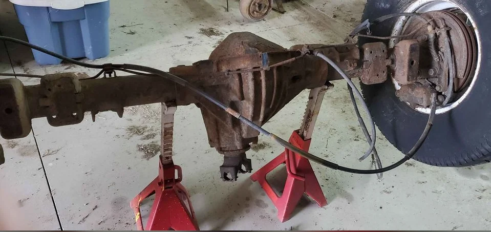

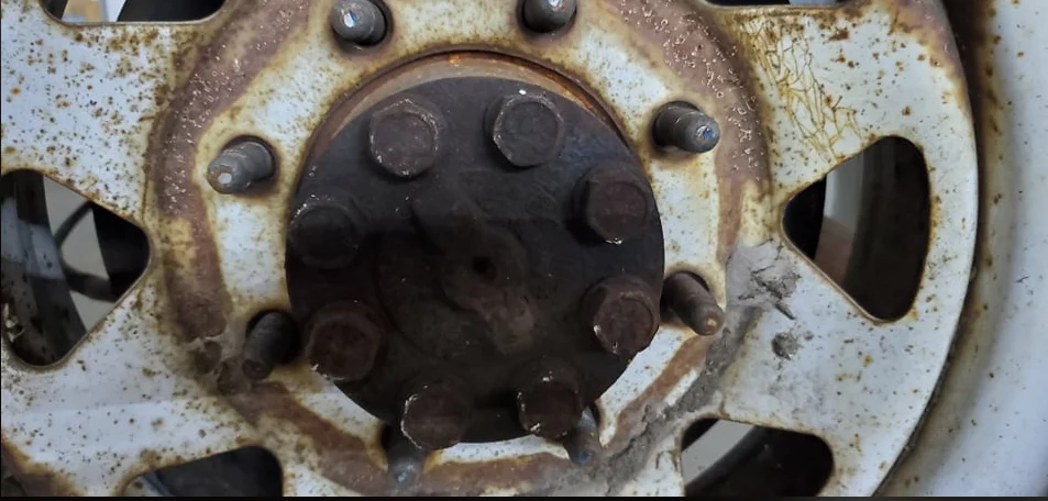

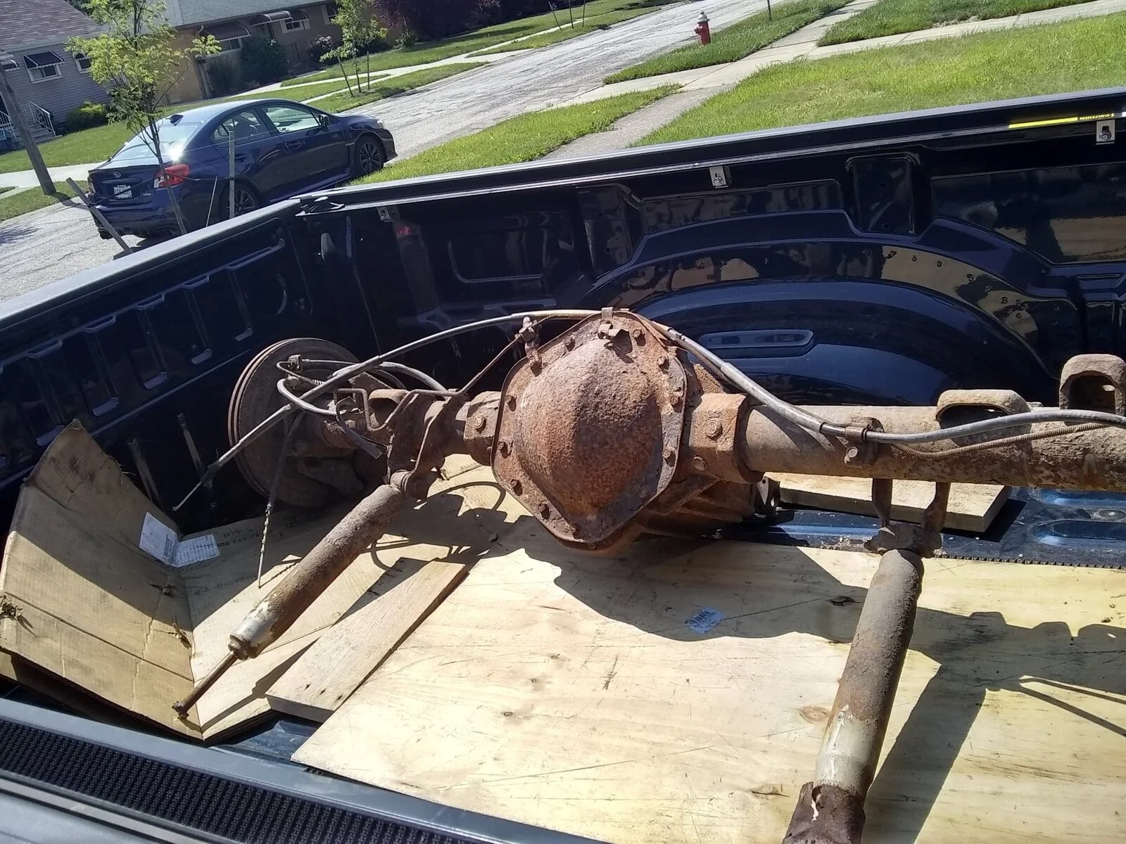

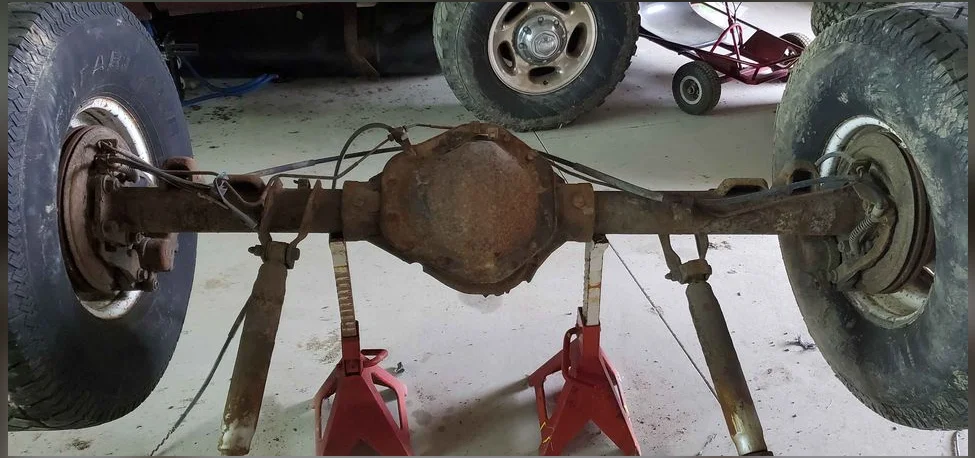

few pics i was able to get of that old 14bolt.
but he doesn't know what the WMS to WMS is. info i was able to find says it could be a 67.5" SRW axle or a 63.5" CnC axle.

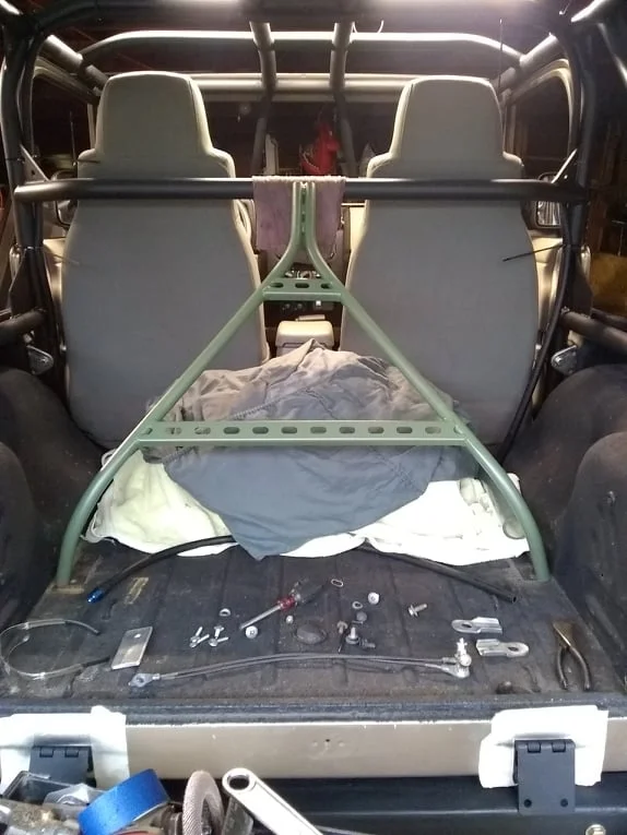

finally got around to ordering the filler neck cap/spout. went with an Eddie's aluminum flush mount with a bright red cap. this will mount on the small panel behind the seat on the back of B bar.
should be able to mount those front fenders this wkend.
i dicked around with a spare tire mount that would connect off the harness rail and bolt to old seat bracket holes in the rear floor. kinda light duty but not finished yet, we'll see.
