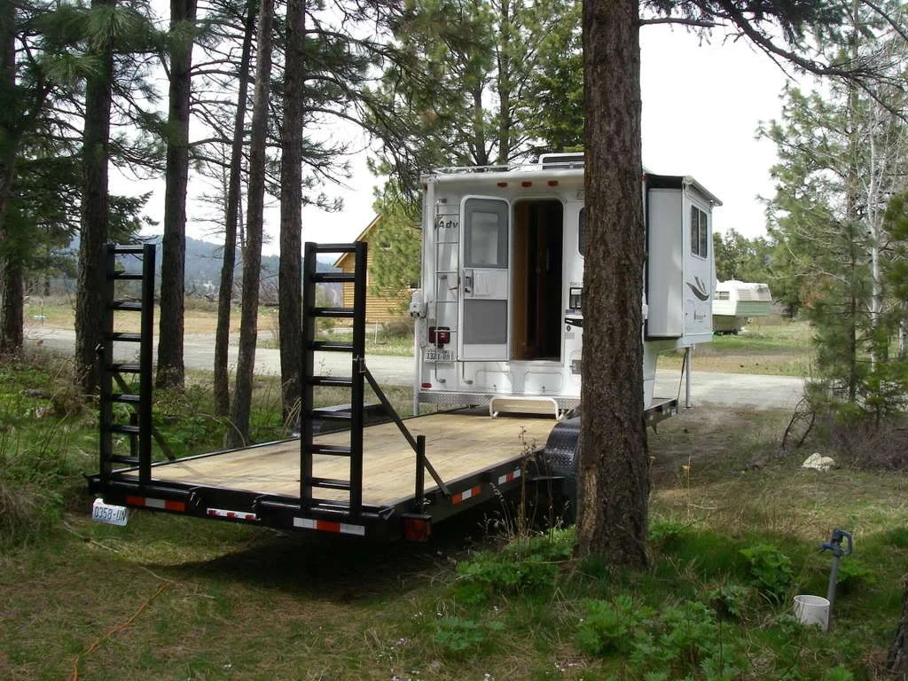

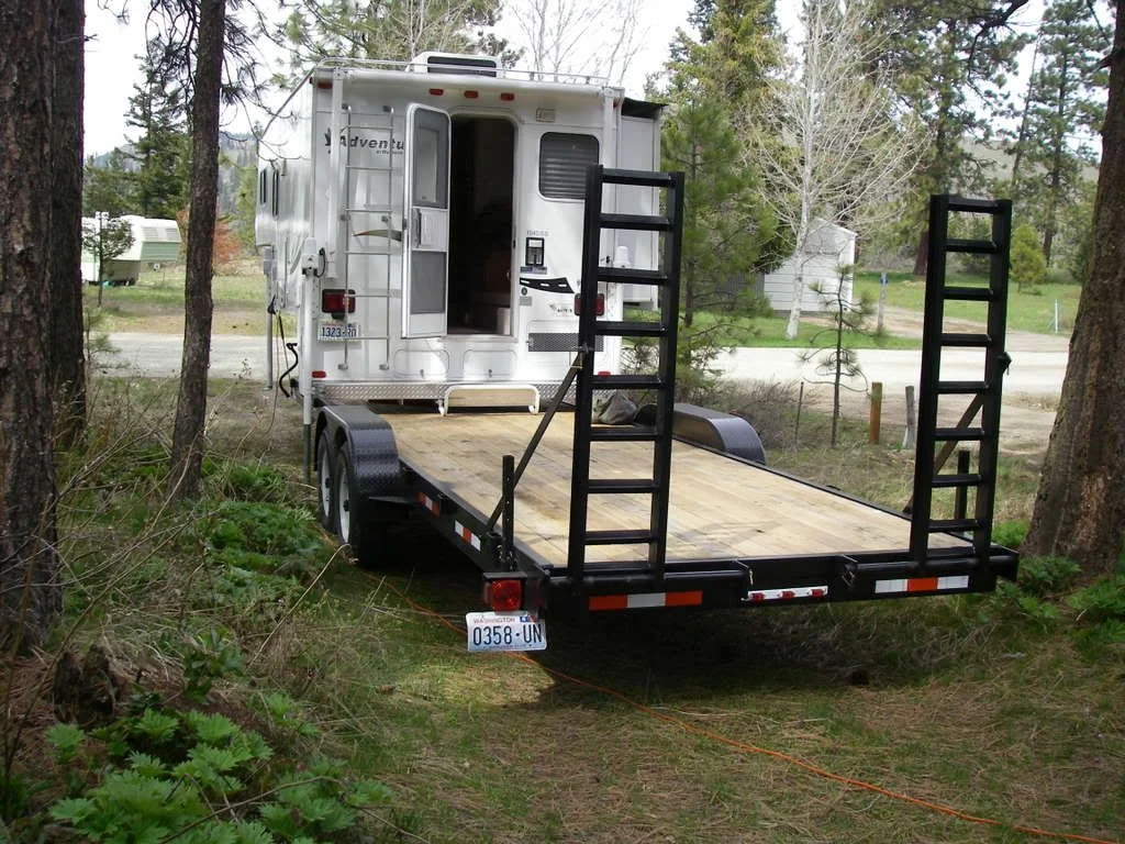

Here are some from Etrailer that I think you could drill and put a rod thru like you were planning for your steel ramps.
https://www.etrailer.com/Car-Ramps/Stallion/288-07502.html
These ramps were setup similar to what you were talking about doing. I could slide them in or out depending on the width of what I was loading onto the trailer.
They'd used a piece of pipe that the ramps slide on.

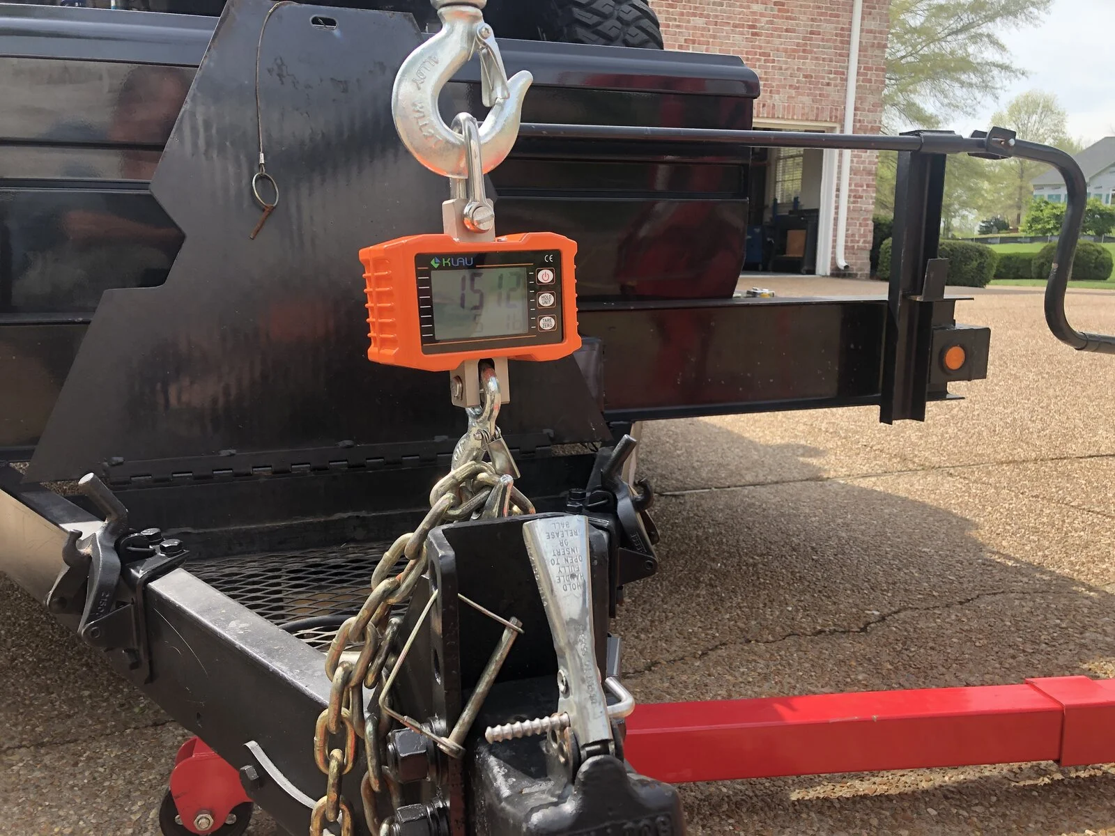

IDK yet, i assume a 600-700# tongue weight will have an effect. the vehicle has about an inch of rake i never removed knowing it' will be used to tow. and i'll be fine if that's all it needs, if it wants more i will likely incorporate a distribution hitch.
what prompts this is, i remember carrying the 14bolt axle around in the bed for a few days b4 i got it out and that made the front end feel light to me with that weight over the rear axle. this towed weight will all be behind the rear axle, so i assume the feeling will be magnified.
i have found a few of those units tested in that vid Wildman posted, the 1 he liked best is on FB for 150$ locally.

You can figure it out based on what the Gross Combined vehicle rating is and your rear axle weight rating (both should be posted on the drivers door sill somewhere). Go weigh the truck, so you know how much tongue weight you can handle, then weigh the trailer and jeep. If your total combined weight is under and you have enough overhead on the rear axle, you're good to go. If you the GCVW is under, but the tongue weight pushes you over, you'll "need" the WD hitch. I put need in quotes...I've never run a WD set-up....but then again, I seem to be hard on rear axles...Both my avalanche and my F150 needed to have the rear axles rebuilt. The Avalanche was at 160,000 miles and the Ford was within the warranty period (so I believe that was a factory screwup, not me).

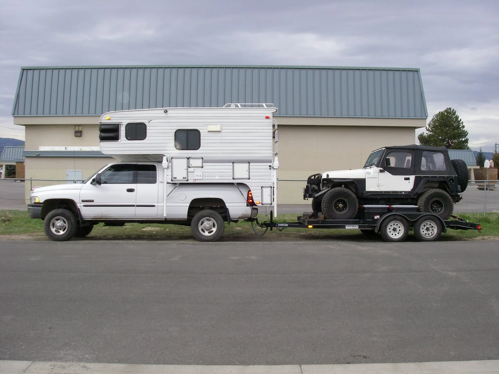

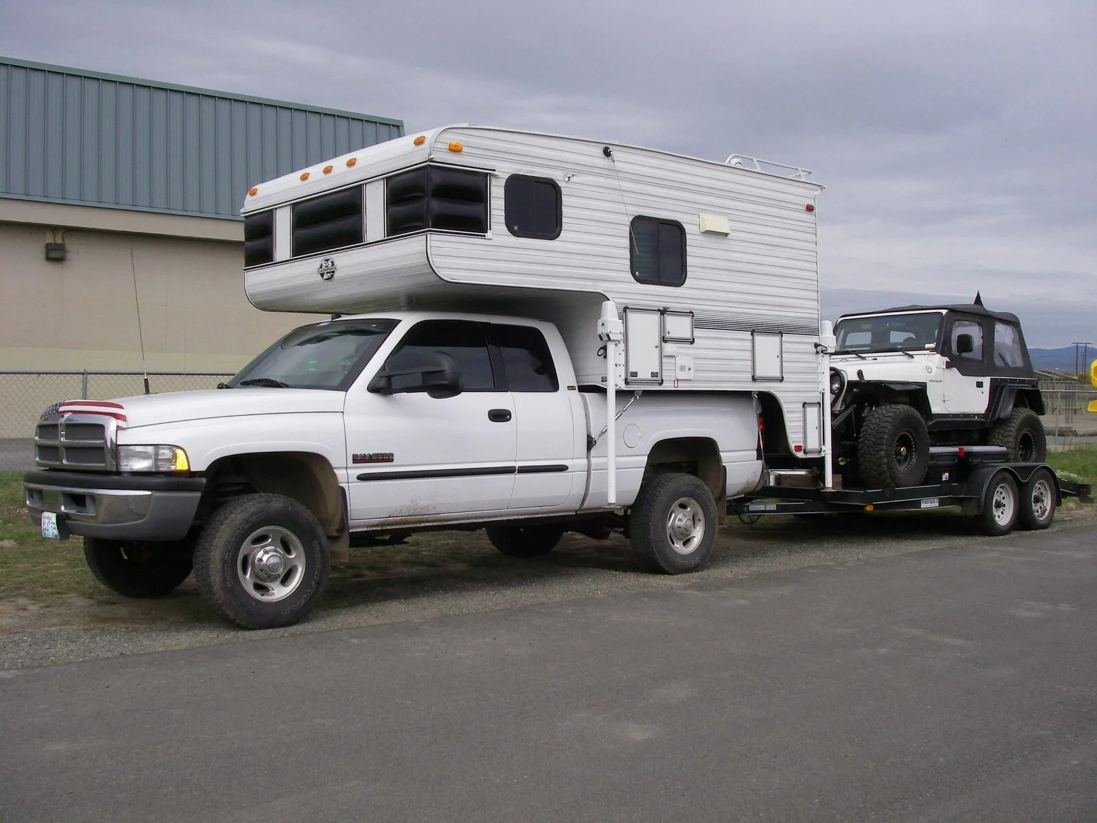

I towed with my Ram 2500 but it was also a CTD so it's got a lot more weight over the front axle. It's going to be interesting to tow with the new Ram 1500 but I don't plan on towing with it much.
IMO as long as you have the tongue weight correct you should be OK but a WD hitch can't hurt either.

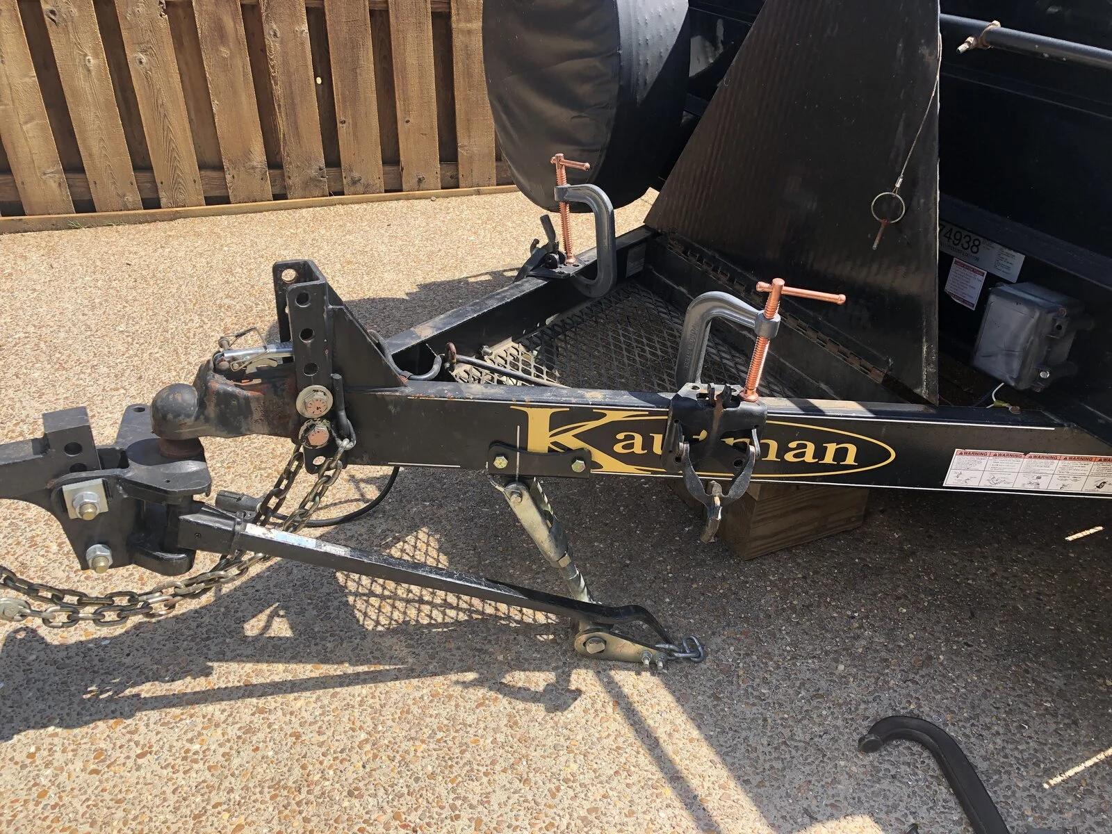

I ran a WD hitch way back when I towed the rig with a 1/2 ton Yukon XL - and that truck really needed it. My current big diesel has always towed very well without it - even with the trailer pushing 9 or 10k. I've run 25,000 comfortable miles with this setup with no issues.
Well, since I still had the WD hitch setup (and after some nasty "air-bag shaming" from Ryan :rolleyes:), on a whim I decided to give it a try for my Moab trip this year. The difference was noticable. It went from a great ride to a fantastic ride. Noticably better steering feel, a bit less sway, and less porpoising.
Although probably not worth the effort for short trips (less than a few hours or so), I'll definitely continue to use it for long trips.
One nice feature about this setup is that is has built in sway control. That's the purpose of the control arm in the center.
Oh, and I did learn something about my setup in the process...
After seeing that I did move the rig back on the trailer just a bit...
