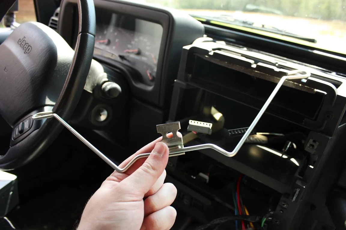

below is what it looks like, the hardest part was reaching in from the removed glove box and removing the nut that held the radio to the bracket where his hand is., I needed a wrench and it has to be done by feel. Once the the nut loosened with the wrench then radio removal was easy. the 2 loops on the top are where it is screwed into the top of the dash. I was rushing the removal of the top of the dash when I broke it. start on one side and move over to the next part to pop it off, there were several spots to pop the dash top off.
^^interesting bracket, my 98 does not have that bracket. Wonder if it's used on the later models only.
