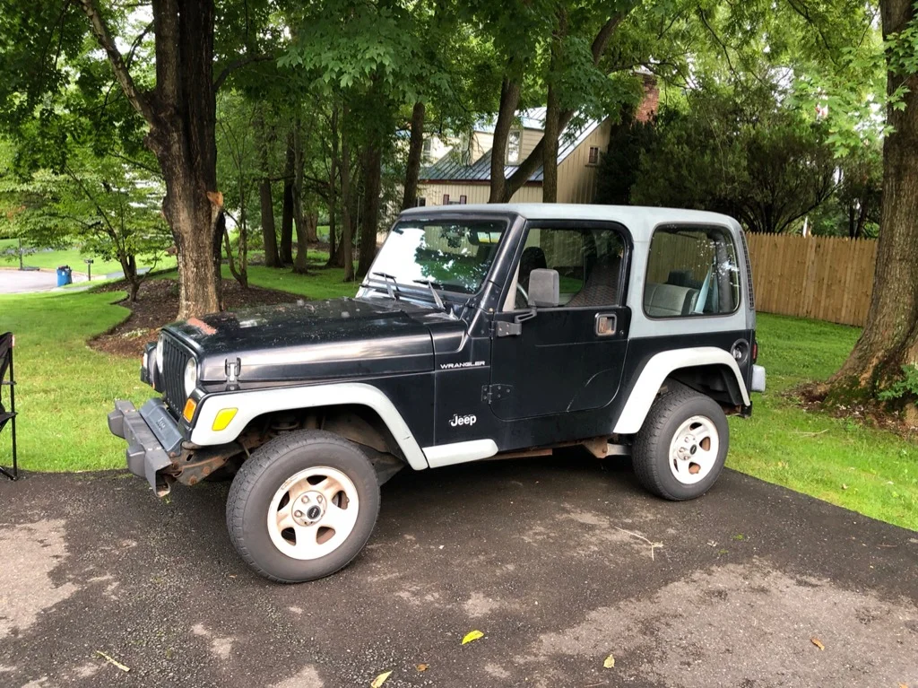

Hi everybody. My neighbor is moving away and he is giving me is 2000 TJ. I have taken a look and it's got a little bit a rust, but nothing crazy. One of the sway bar links is completely broken, but otherwise he drives it at the moment so it can't be that bad :) It's got a 4 banger and is a manual transmission with 4wd.
The TJ will be my second vehicle that I will mainly use to off-road with. I currently have a 2017 Cherokee Trailhawk that gave me the bug, but I'm glad i'll have a project that I won't mind messing up in the woods. I've been looking at the threads to try and figure out all the mods I want to do, and they have been very helpful.

Your going to have a bunch of fun. The first thing I would do is remove the milk jugs then remove/paint the fender flares so they are black again.
How many miles?
Reactions: Sj's TJ
Those are suppose to black huh :) It's got about 210k miles. I'm looking forward to getting her setup for the woods.

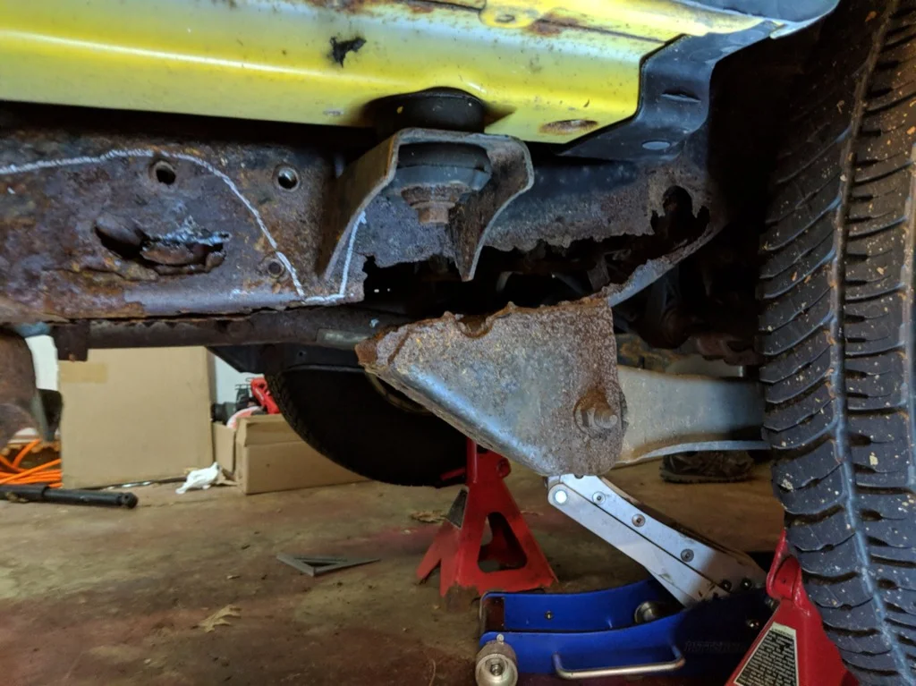

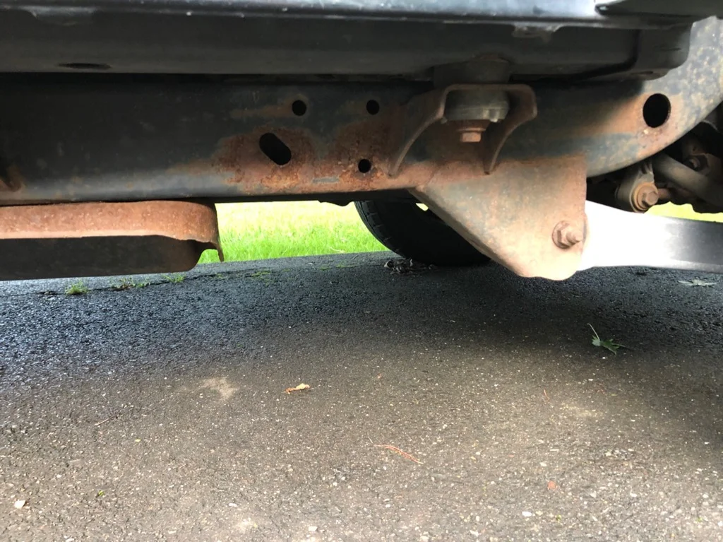

So I finally took possession of the TJ today. I took the milk jugs off and it already looks better. It looks like it has some rust, but doesn’t seem to be to bad. I banged the normal bad sections with a hammer and everything still seemed solid, so I’ll need to sand things down and treat the surface rust. Below are pics.

Don't mean to be discouraging but if the rust looks like that on the outside of the frame, its much worse inside the rails...I know this from experience too, I had to have the whole frame surgery done on both center skid plate sections all the way back beyond the rear trailing arms.
I will say this. Under no circumstances remove the 6 bolts holding the transfer case skid plate on there. I can almost guarantee if you go to loosen one, you'll break the welded nut on the inside and that'll be a project you don't want to get into. You can drain the t-case fluid out without removing the plate if your interested in changing the fluid. Just an FYI.
Other than that, try and take care of it a little at a time and you'll bring some good life back into it!

X2 to this. I hate to be the downer here, but that's way more than surface rust, I promise.
If the outside of the frame looks like that, I guarantee the inside does as well. Take a tiny inspection camera and snake it in there, you'll see it with the right light.
I never would have suggested buying a TJ with that condition of frame had you shown photos of it before you purchase it. Again, I'm not trying to be rude or condescending, but you've got a big project on your hand there if you are attempting to address that rust.
I know others can relate, such as @Ranger_b0b. Rust is not to be taken lightly with these things.

Thanks for the info guys. I put my finger in there and felt some flacks for sure. I’m ok with a project. I got the TJ for free from my neighbor and my other neighbor knows how to weld so I’m in it to win it. I was just happy I wasn’t able to push through any parts of the frame. I’ve been looking on here for awhile now so I am armed with tons of info, so thanks for that guys. The best part is this is totally my 3rd vehicle to play with so I’ve got nothing but time.

Understood, starting at $0 is great and it must be in good mechanical shape then if it was his daily. I’m just suggesting to take a real good look at the frame and keep that in mind before committing to a long term plan. If it has 5 years left, then keep that in mind before you open your wallet and invest a bunch of your time. If the section of frame you posted is that rusty, the rear part of the frame that is known to be a weak spot is very likely much worse (start in front of the rear wheel low point and work back up and over to the rear bumper). I saw one in a shop a couple weeks ago that had a decent tub and some nice mods, but the frame was beyond repair. Felt sorry for the guy.
