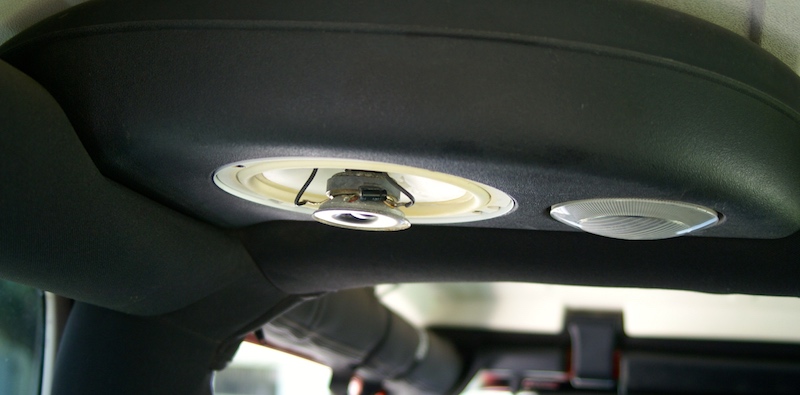

Here ya go:
Tweeters REALLY hang down.

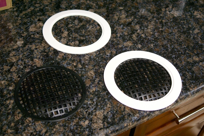

These "waffle" grills are prolific on eBay in various sizes. I didn't like the goofy mounting clips that came with them, so I sourced some lite fixture trim rings to hold them up.

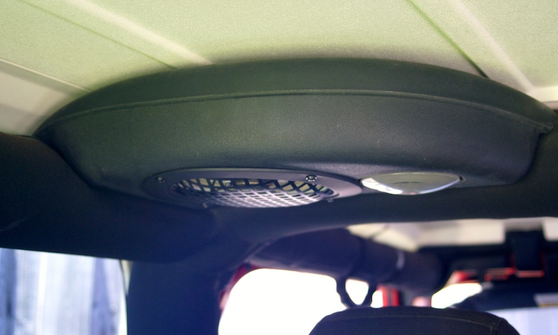

Drilled, painted, and installed. Rings are a bit flexy, but work. Clearance between grill and tweeter is probably about 1/8" or less, but its enough.
I tried to find a dome shaped grill, but wasn't successful.
