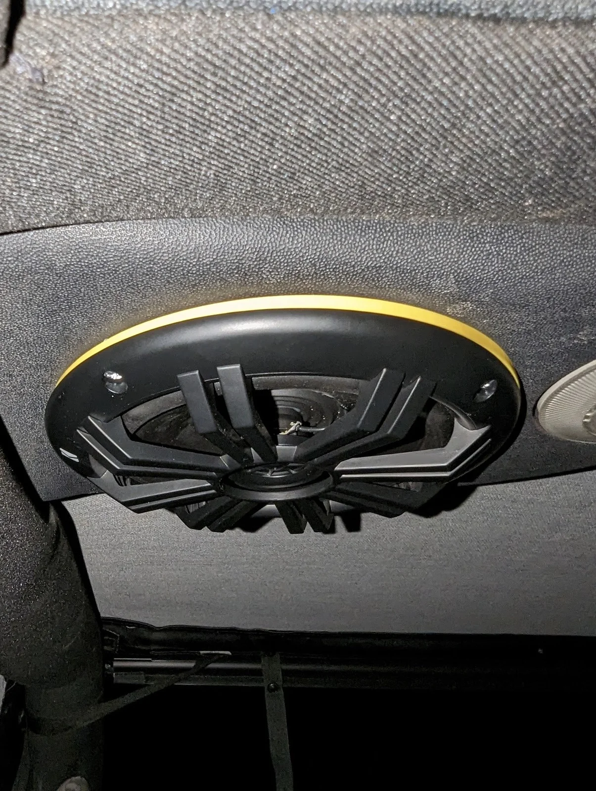

I ended up going with 5.25" Infinity Reference for front/ 6.5" Infinity Reference for rears. Still need to find a direct replacement for the factory sub. I'll likely add the add-on amp Alpine makes for the iLXW650.

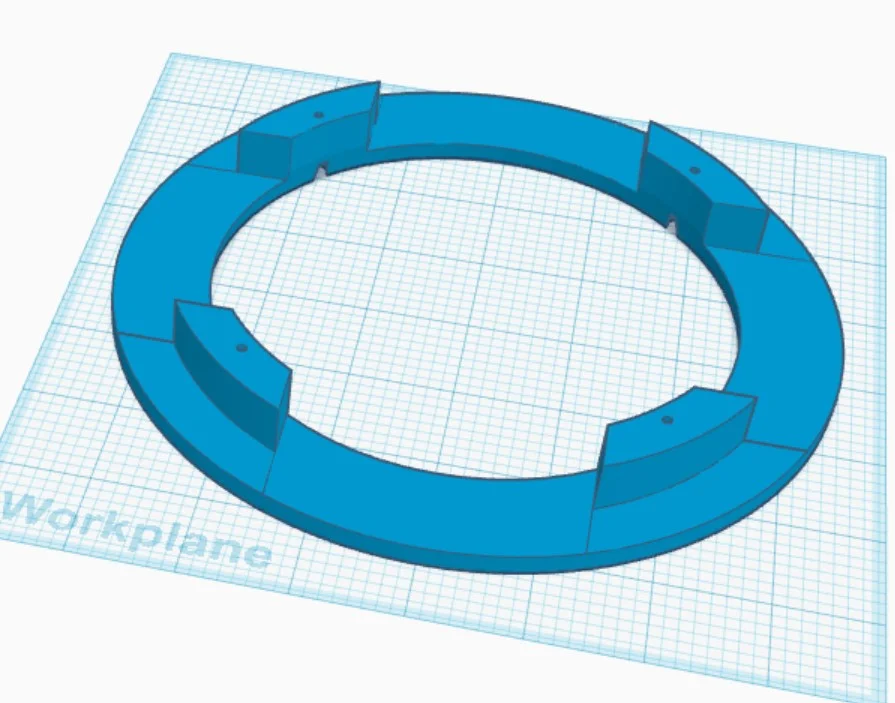

Oh, I forgot to mention you ought to print in PETG. Anything that can be in a hot car needs PETG or it might get soft on a summer day.
I used sharp ended machine screws and just screwed them into the rim, no drilling. It's pretty thick and they hold in the plastic solidly.
If you're really paranoid (and I am), you can screw them in once to start the hole, then do it again with gorilla glue on the screw.
Also, make sure to say "That ain't going anywhere" when you're done.

If you can fit 6.5s definitely go that route. On my 2002 I just needed to drill new holes for the screws.
