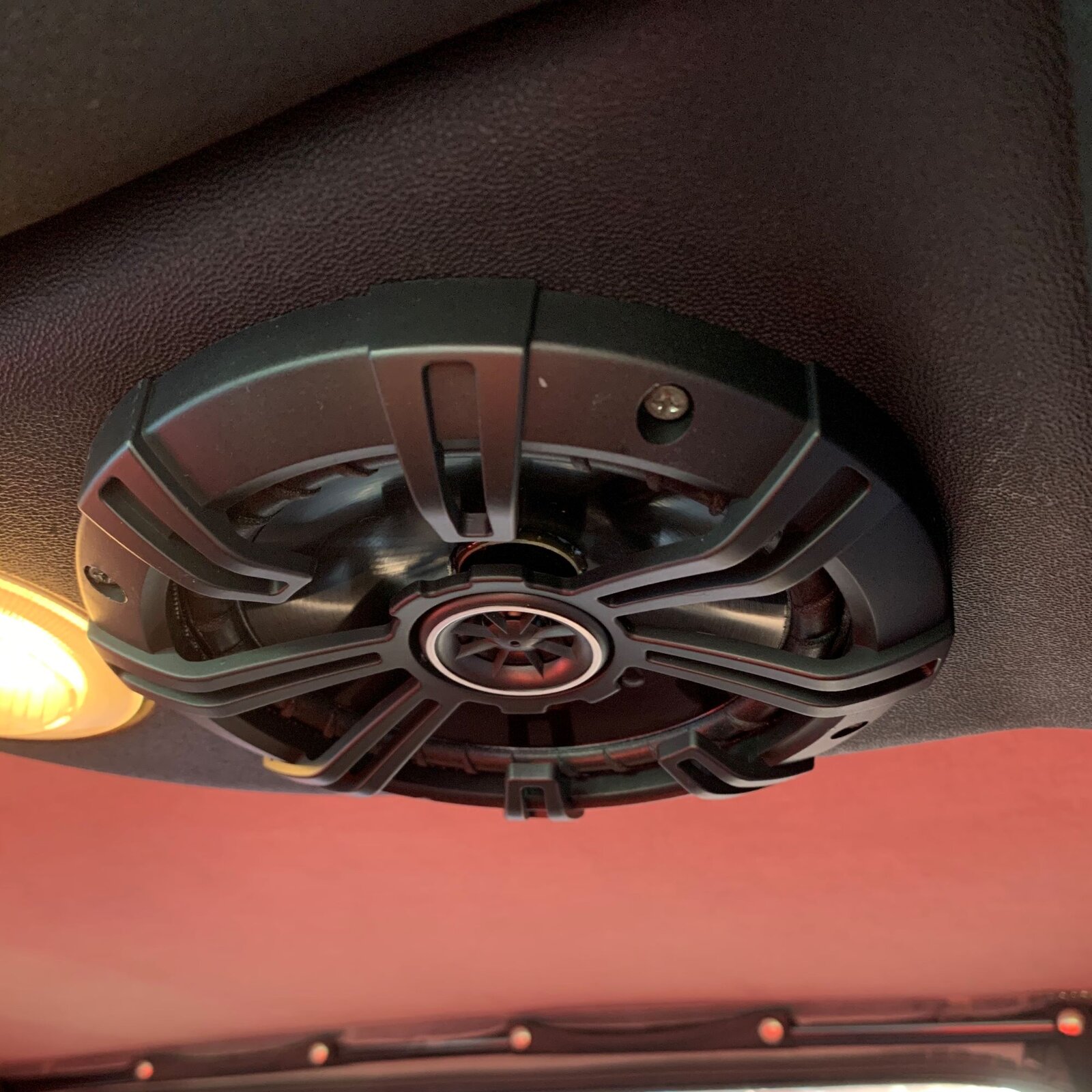

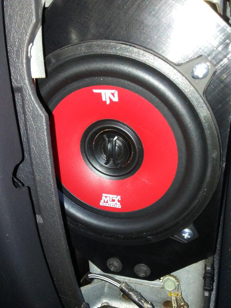

No trimming, just drill new mounting screw holes for 6.5" speakers. Buy your speakers at Crutchfield and they're all plug and play with harnesses included free.
p.s. MTX terminator speakers put out the best bass without a high quality amp. I used them in my XJ and up front on my TJ. They didn't have them in stock when I bought my sound bar speakers and I got Kickers. I'm impatient and couldn't wait a week. Not nearly as good IMO and I worked for Crutchfield and tested all their stuff for years.

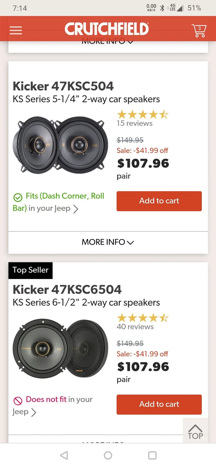

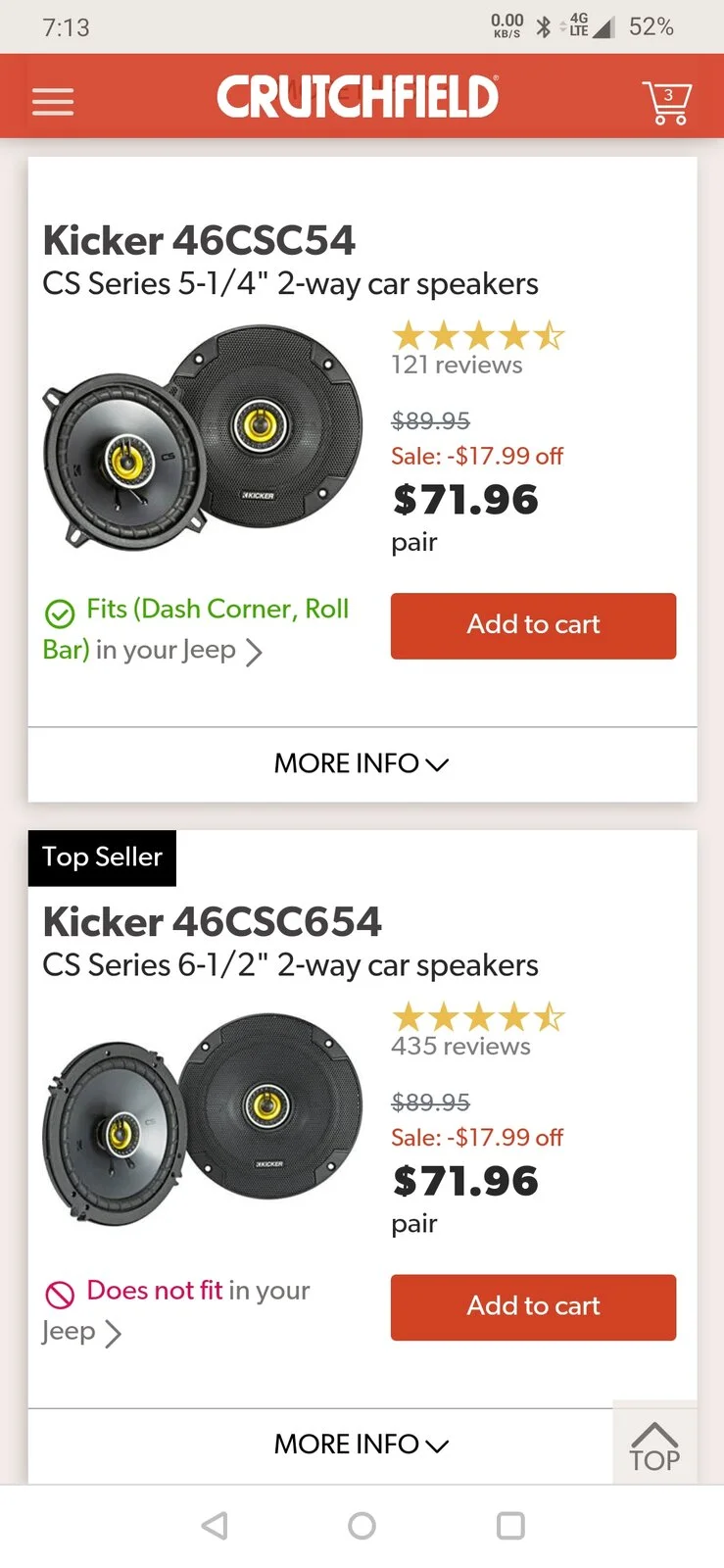

With that said, the easiest, budget friendly, and will produce a sound quality that the majority of TJ owners will enjoy, is five Kicker speakers and a five channel amp.
Front dash: 5.25"
Overhead pods: 6.5"
Subwoofer: 6.75"
Amplifier: five channel.
Amp install kit.
Kicker has D, C and K series for this build, with the D being good for a typical head unit (no external amplifier) and then the C and K series want a little more juice from an amplifier. Also, the K series has a larger tweeter, .75" vs .5" in the C and D series.
