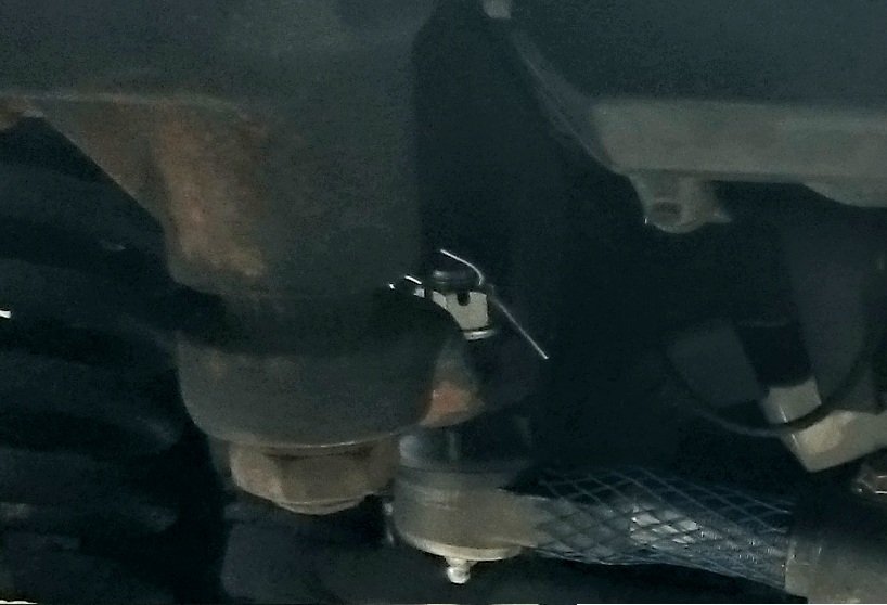

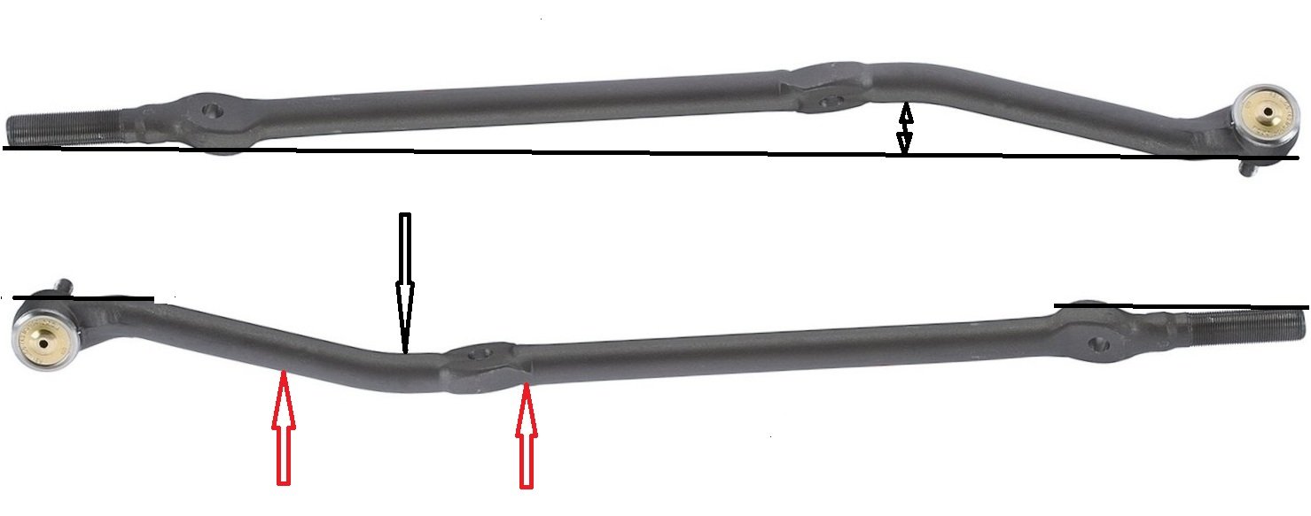

One thing to note, I find with lifted suspension, the TRE on the tie rod can catch the axle slightly. I don't know if similar happens on LHD vehicles.
What I do with any new drag link is to use the press at work to increase the bend in the bar slightly. This moves the TRE away from the bracket it catches to prevent interference.
