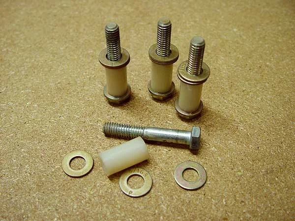

It depends on how creative you want to be:
(1) Raise the OEM light with longer bolts and spacers,
